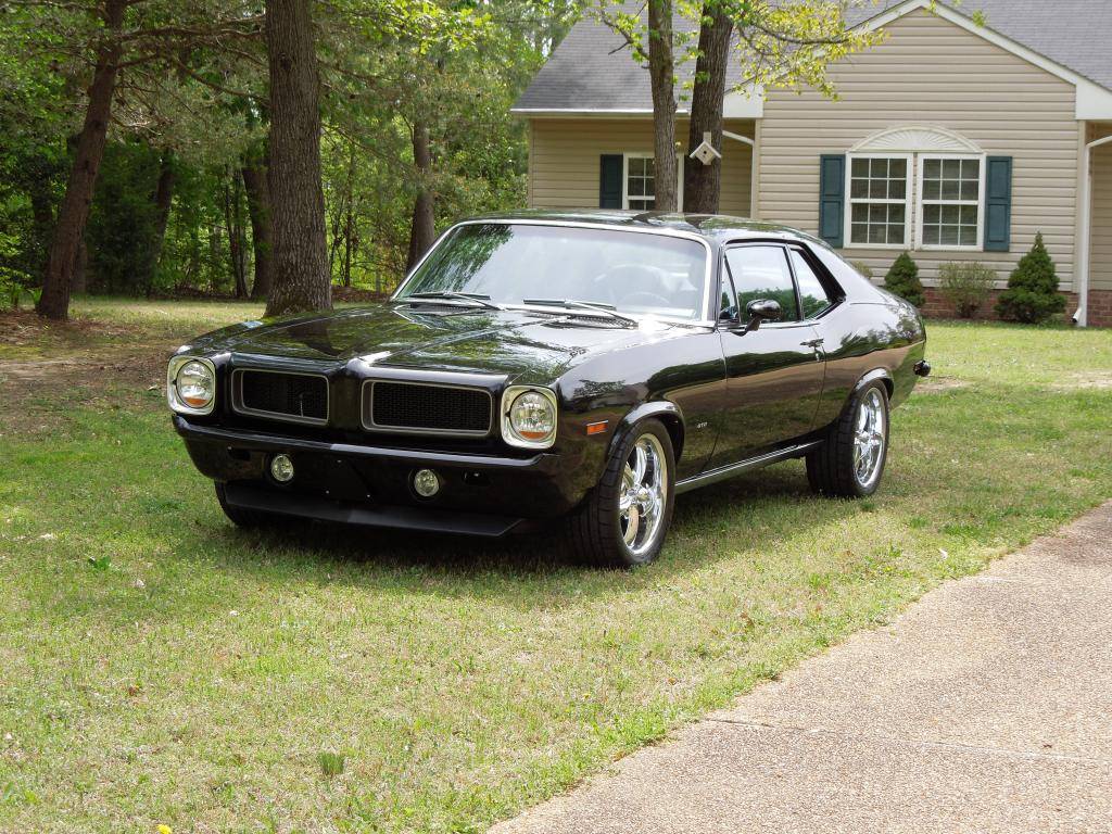

      Finally finished a 2 year 1972 Pontiac Ventura II project. This car is a 2 owner Virginia car with less than 70 miles since build completed. Sorry the specs read like a sales sheet...I am contemplating putting it up for sale.

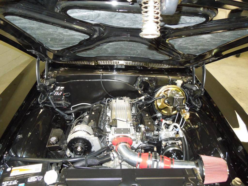

      Engine: 1995 5.7L LT1
      -Completely rebuilt with new moly rings, bearings, lifters, oil pump, timing chain, seals
      -New temp sensors, knock, tps, iat, pcv, coil
      -New optispark, waterpump
      -Rebuilt starter, alternator, powersteering pump
      -pcm tuned to remove airpump, egr, set gear ratios, fan temp, etc.
      -Hedman headers.
      Cooling:
      -New dual core 95-2002 Camaro radiator
      -95 Camaro Factory dual electric fans controled by the PCM

      Vehicle had rust free floors, trunk. The body was stripped down to bare metal with minimal bodywork required. Painted Jet Black BC/CC
      Features:
      -69 Camaro front and rear bumpers front valence, spoiler.
      -Custom rear valence.
      -Nova taillight panel with center mounted Stainless Steel fuel filler.
      -73 Sprint grill header (dura-glass) with custom made grill inserts.
      -Underside stripped of all undercoat and painted with single stage urethane satin black.

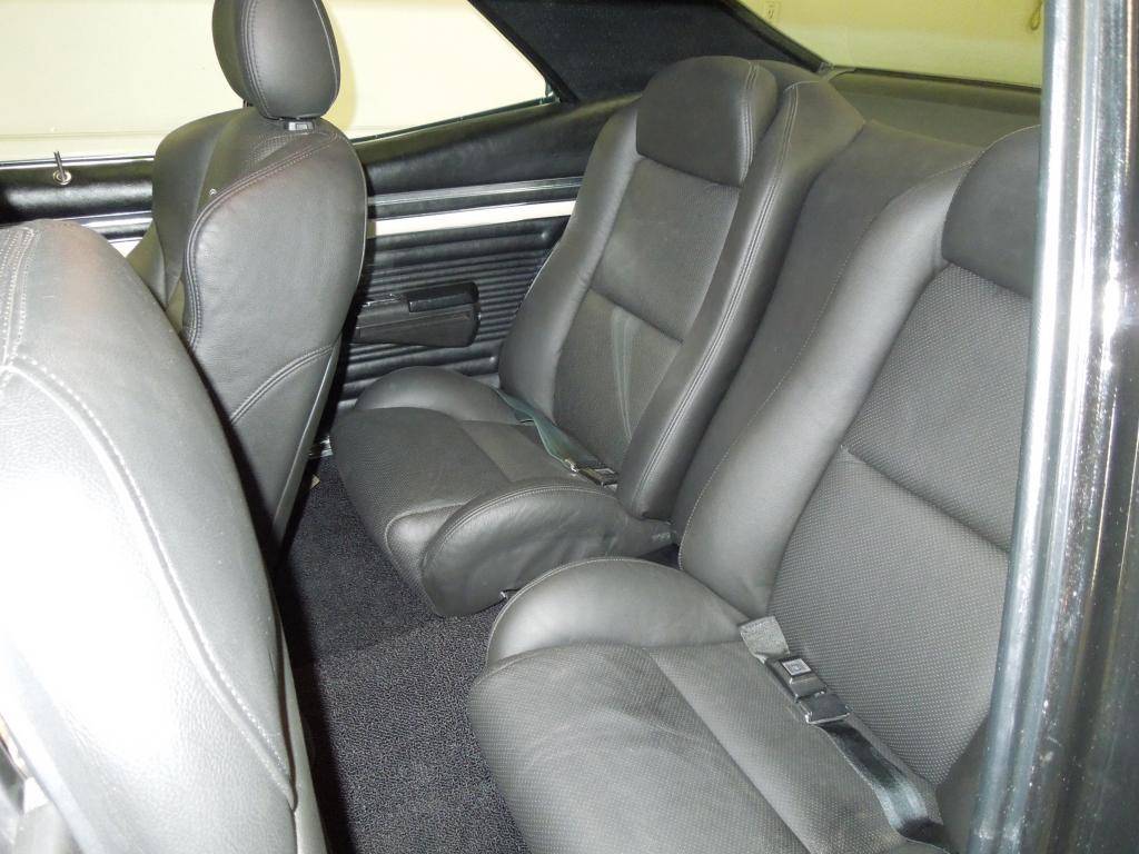

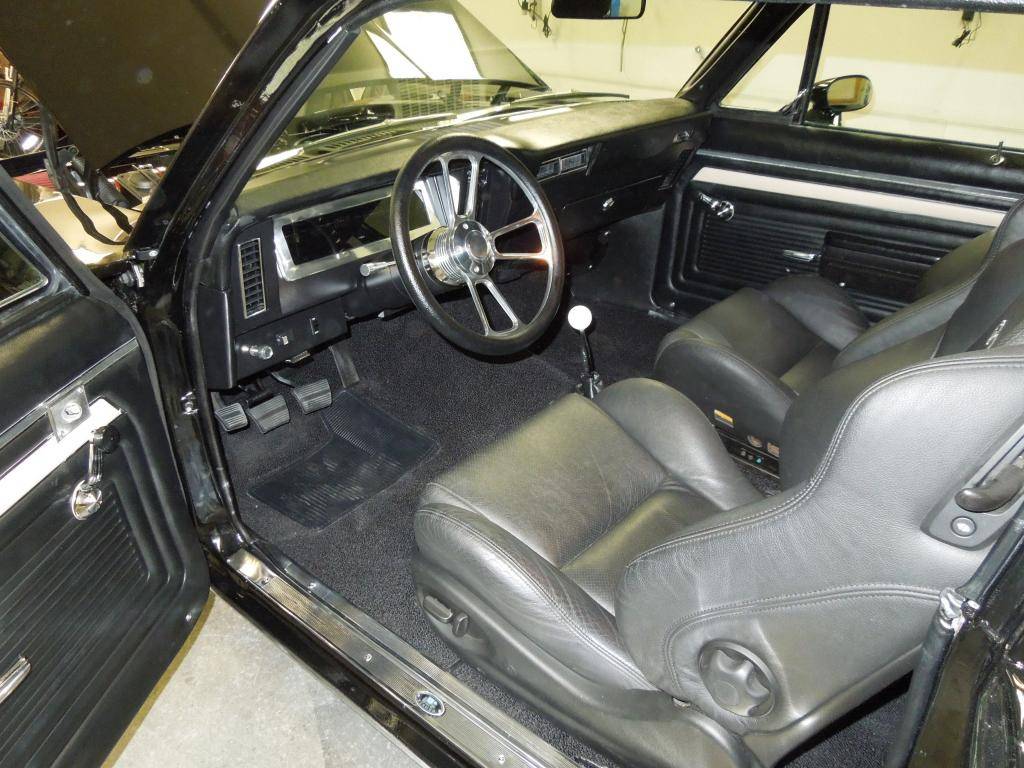

      -2004 GTO Black Leather seats.
      -New Door panels, carpet, headliner, sound/thermal barrier.
      -Custom fabricated dash insert with Summit Racing digital gauge panel (includes speed, tach, odometer, water temp, oil pressure, fuel level, high beam, directional, max speed, 0-60 and 1/4 mile functions).
      -Vintage Air A/C system.
      -Sony MP3 CD stereo.
      -Custom billet dash knobs.
      -Forever Sharp billet half-wrap steering wheel.
      -Rebuilt manual steering column with new ignition and directional components.
