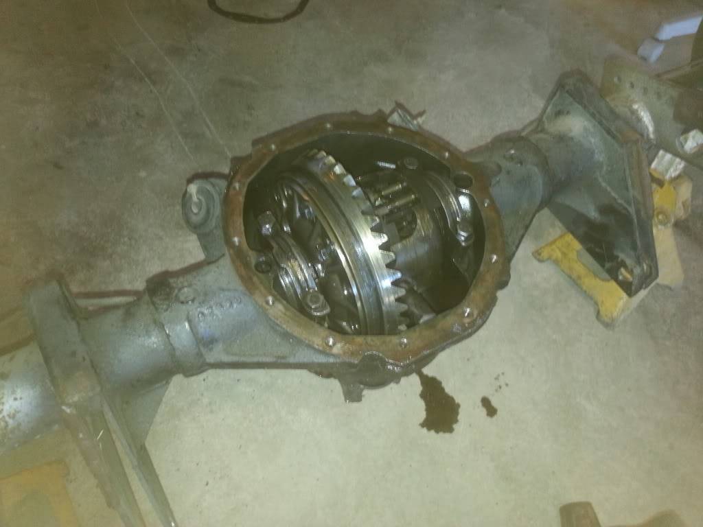

      Hi Guys Im Trying To Remove The Carrier From My 67 Camaro, Its Not The Original Rear End And I Dont Think It Has C-Clips. Can Someone Help Identify This Carrier And Maybe Tell Me What I Need To Do Heres Some Pics

      Are those ladder bar brackets?
      I don't see any pics of the axle ends, but I am guessing c clip eliminators. You will have to remove the four bolts holding the bearing retainer, like a 9" ford. You may need a slide hammer to get the axles out.

      yes ladder bars, sux car rides like a crappy go kart, but good thing is that there not going back in, switching to a 4 link and panhard
      can anyone identify the carrier?? is it a posi or locker. truck or car lol im about to buy all new internals and need some help

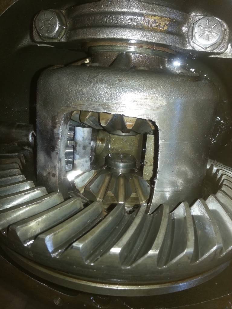

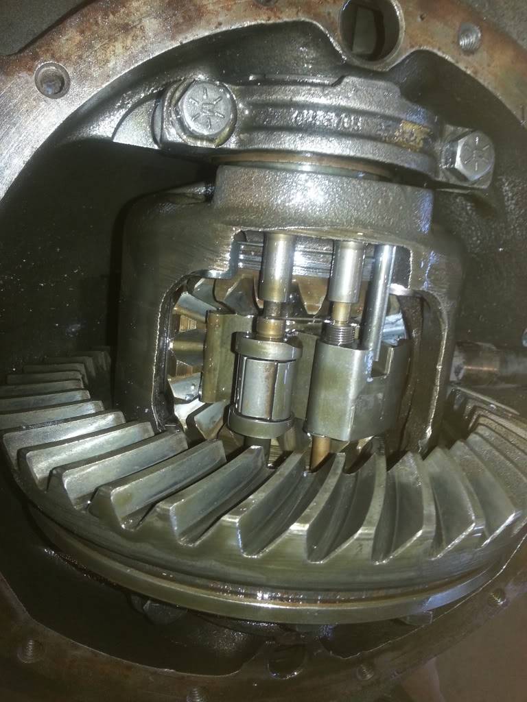

      I believe the carrier is a "gov-lock" or a GM truck G60 positraction. Some people cal them grenades.
      The housing appears to be a GM 12 bolt from an A or B-body. I wasn't aware that the two (housing and carrier) were compatible.

      What Ken said-looks like a Gov lok and 12 bolt housing.
      There is a 8.5" 10 bolt for an A body that could have a Gov lock. It has bolt in axles no c clips but sure looks like a 12 bolt housing.

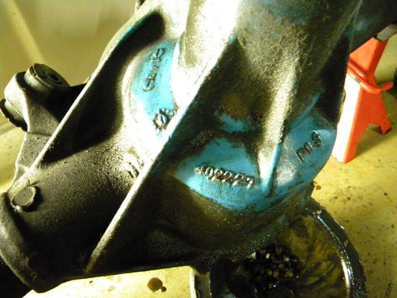

      OP, the truck posi may be in there because I believe the units from Ford 8.8's can be retrofit into these. Look for any casting number on the housing and it will tell you if you have a BOP type "O" rear axle also count the number of bolts are on the ring gear.
      See if you find a casting number of 39413, 394139 or 402227 anywhere, they are all for Olds type "O" housing
      Here's a pic of mine I removed to give you an idea where to look

      I agree with Ken on the diff. It is absolutely a GM gov-loc ... which has a LOT of issues. So plan on selling that on ebay ... cheap.

      So far, Tim has said the only thing that makes sense on the housing, in that it may be a '68 to '70, Olds ... with 12 bolt cover & 10-bolt 8.5" ring gear. Count the bolts on the ring gear & measure the diameter of the ring gear & post that info for us.
