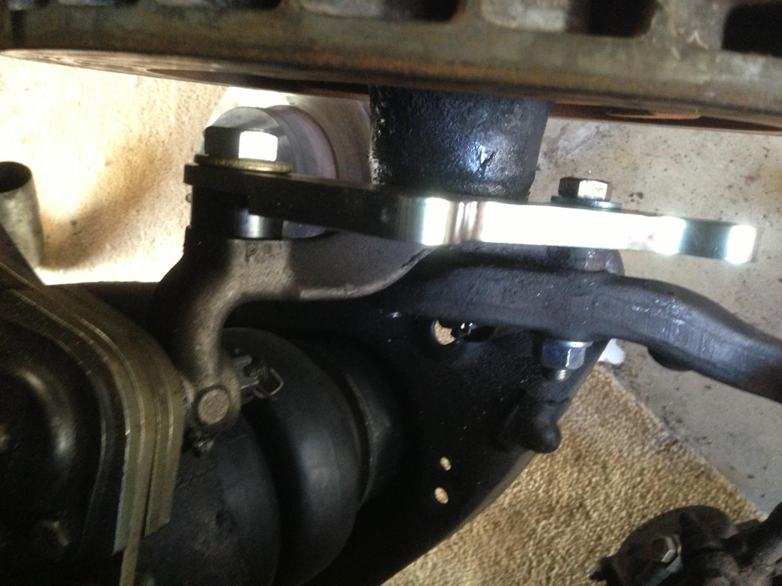

      I wouldn't start modifying the bracket, you need to add shims between the caliper and the bracket to move the caliper back, I would assume that Kore3 sells the shims, you can try hardened washers but they may be to thick. Can you post a picture of the bracket/caliper mounted on the spindle?

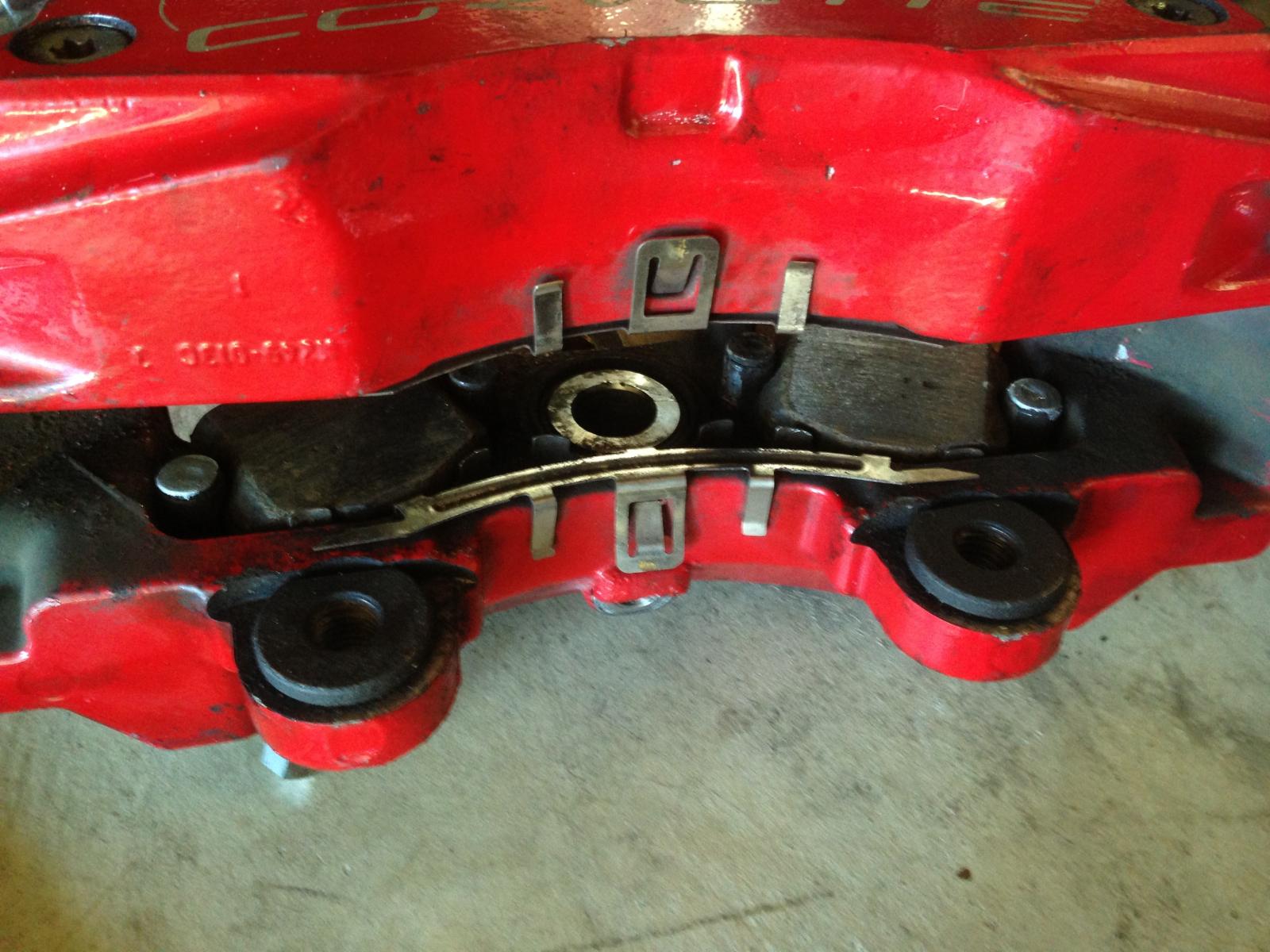

Size:  182.5 KBName:  image.jpg
      Here is 2 pics. Working on more now

      On the caliper pic where it's rubbing the rotor I put some silver marker on. It's the 2 circles at the ends of the hockey pucks..

      I don't see anything wrong with the bracket installation or do I see a way to shim the caliper. I see that you are using the stock drum brake hub and I'm wondering if that's the problem. Kore 3's site says that their billet hubs increase the track width by .200" per side which tells me it pushes the rotor out .200" here's the page I found it on KORE3 Industries LLC: On and Off-Road Performance Automotive Components read note 3. I think I would contact Tobin and find out if that is the problem.

      In the install instructions it shows the bracket has a grooved section on both mounting points and mine doesn't have that... Not sure if generic instructions for all big brake kits or not but a thought none the less
      I'm going to try spinning the brackets from left to right side and see if there's something there I could be doing wrong.

      Brad, the brackets appear to be installed correctly. The instructions show an earlier generation of bracket that had machined reliefs on both sides and used thicker material, so your brackets are the newest/latest/greatest revision. Next, the KORE3 billet GMSS hubs have the same relative flange offset as the OE Chevy drum hubs, the added .20" track width is due to the difference in rotor hat thickness (~.30") versus the drum hat thickness (~.10"). I've emailed you the Chevy drum hub reference drawing back in June, so I'm going to assume that you really do have the Chevy drum hubs and not something else.
      First question...do you have an interference on one side or both? If just one side, then what differs from side to side?
      If you put a straight edge across the pad guide pins, are they even? You could shim the pins outward to gain some clearance there, but you're obviously somewhat limited in that regard...I think I saw someone selling pin shims on here or lateral-g not too long ago.
