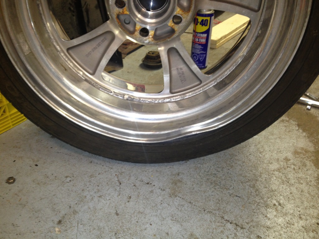

      Check out this clusterfcuk !
      So I went an did the 1" body drop... So far so good after all is said and done I got another 3/4 inch.
      When I go and measure the right side I see I have a flat so I filler up. It starts pissing air out the back. I feel around and realize that after shaving down the bump stops (I thought the bump stops from the lca's would give me a backup to the steering bumpstops)' on a lock to lock the lip of the wheel touches the upper control arms and ruined the rim. Off to the repair shop tomorrow.
      I'm almost done with this truck!

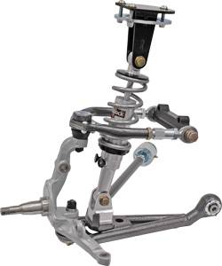

      If you went with a traditional coil-over, the ones I've seen got creative and milled out new upper mounts.
      Here are some images of the mounts that were made, or something similar to give you an idea.
      The QA1 conversion is a 100% bolt-in system. It is also provided in the link below.
      Here's a link for a pretty popular set up for First Gen S10s
      http://www.spohn.net/shop/1982-2003-...ver-Mount.html
      Check this out, its just a little reading material. They seem to love them and how they handle. http://www.s10forum.com/forum/f178/q...-i-use-479965/
