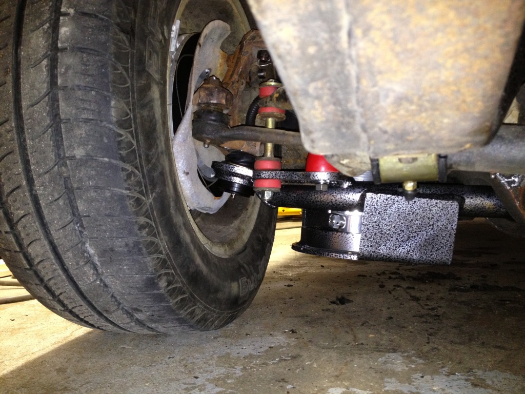

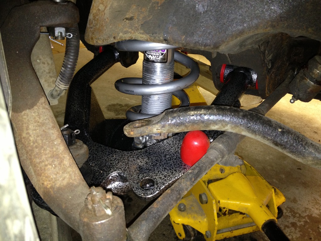

      One lower control arm is in
      Got the passenger side in tonight.
      Wasn't too bad since I already went through the install of the coilovers last week so I kind of remembered all the fastener sizes.
      Last week I shortened the link to the front sway bar and as you might see in this picture it doesnt line up any more.
      So tomorrow I will try and move the sway bar forward around an inch and it should restore the geometry.

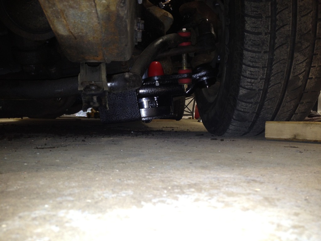

      What a suspension clusterfcuk!
      So I got the truck lowered.
      Lower than I want it which is fine as the adjuster to the coilovers is at it lowest.
      I even cut the connectors to the sway bar so it sits more parallel.
      I know that there shouldn't be any suspension parts lower than the wheel scrub line so I can't go for my 15" NASCAR style wheels...
      But look at how low these stupid LCA's sit.
      Even if I raise the coilovers my ground clearance is horrible. I think I might have to go to 20" wheels.
      The tires that are on there are about 2" too short so I know I will get some clearance when I buy the new tires and wheels.
      It feels like two steps back.
      I'll tackle it tomorrow.

      Wow, that's low, not only is it low but the those LCAs are stupid low to the ground.
      I think you should've gone with the coils instead of the arms, even spindles or both.
      That would have put you down safely and with enough ground clearance.

      Good morning. After sleeping on it I realized that I have every possible lowering trick on there. I tried the lowering springs but they were too soft and I really wanted the adjustability of the coilovers.
      I think I read somewhere that you don't or can't use everything together. So today I'm going to dig up the stock spindles which should raise the LCA'S 2 inches plus the taller tire should put me in the safe zone
      I'll let you know

      have you thought about going back to stock height lower arms and having the top spring mount in the frame modified to give you the 1-2" of drop?

      Good morning.
      I'm sorry, I completely forgot that you had coil-overs.
      I agree 100%, having that adjustability is key for track use. Plus the smaller package will save you some weight to
      You are correct, you cant use all of the components together. I believe you'll have alignment issues if I remember correctly. I went with spindles and coils or just coils on my previous vehicles. Shizzy also recommended another option.
      The stockers should do the trick.

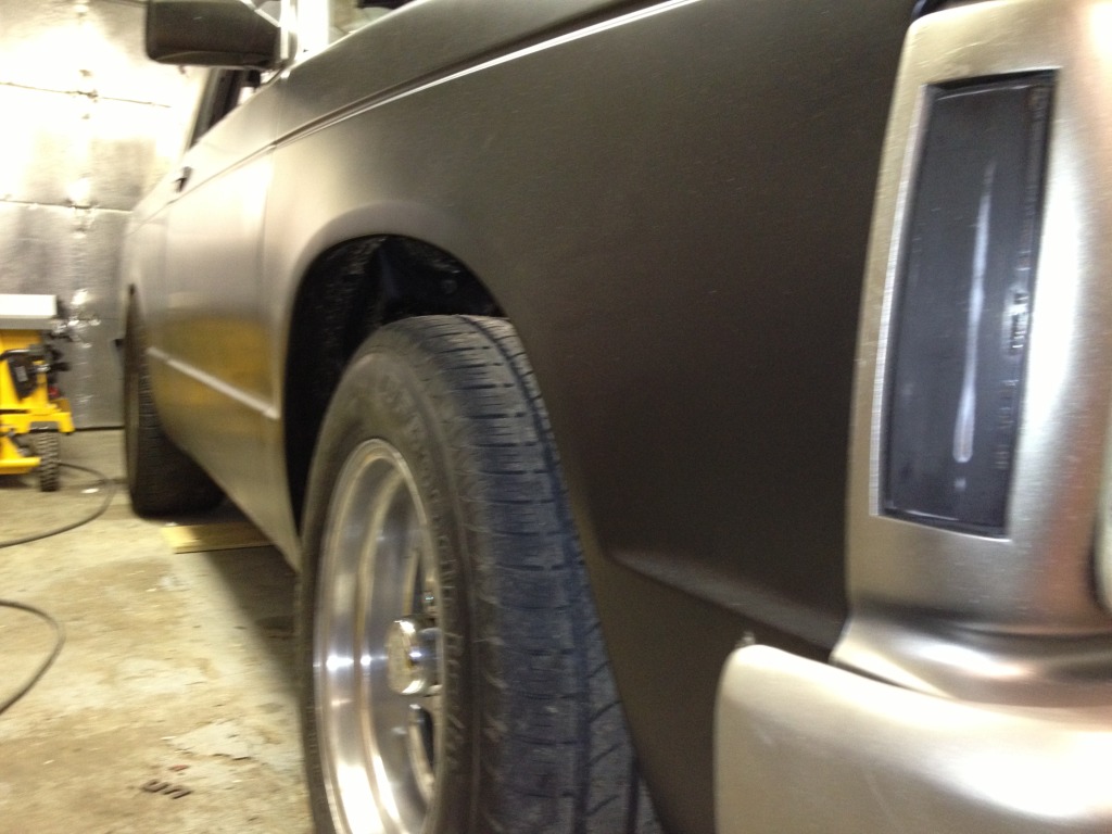

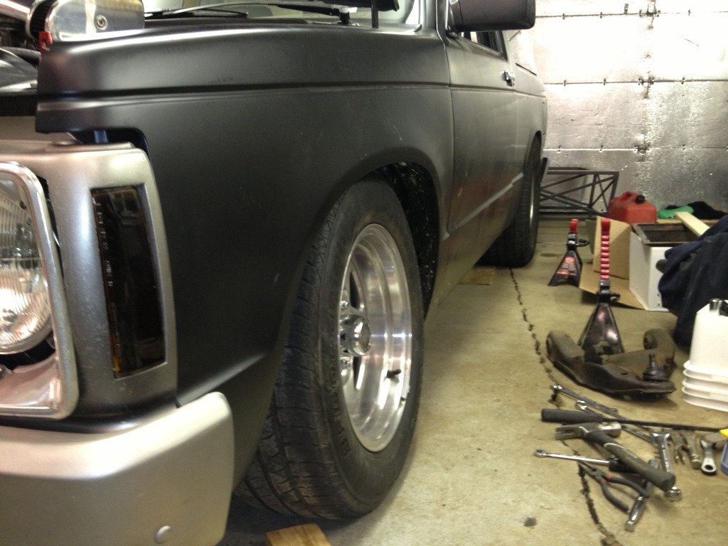

      Finally picked up some wheels...
      Bought these off of the owner of King of Wheels here in Edmonton. They're 2-piece American Eagles. They only had 400-500 miles on them. Not as wide as I would have liked but I'm happy with the fit so far. I will fill you in later.

      Looks like you need to bring the front back down XD
      Looks good though man. ..

      I've got no more travel in the coilovers. I don't know if I should put in the lowering spindles again. I have to look at the old pics. I just drove it around the block and the suspension feels good.
