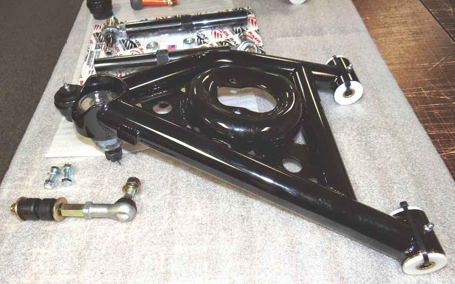

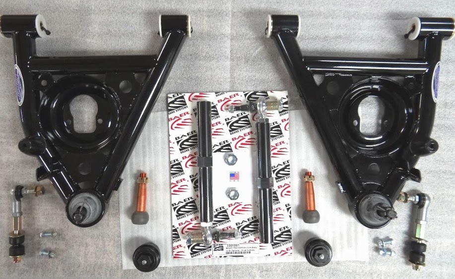

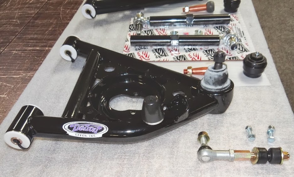

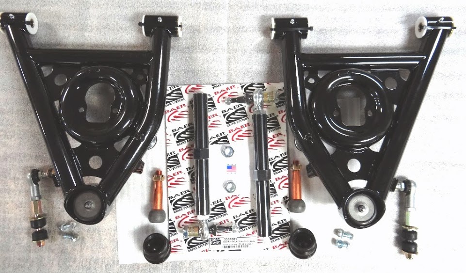

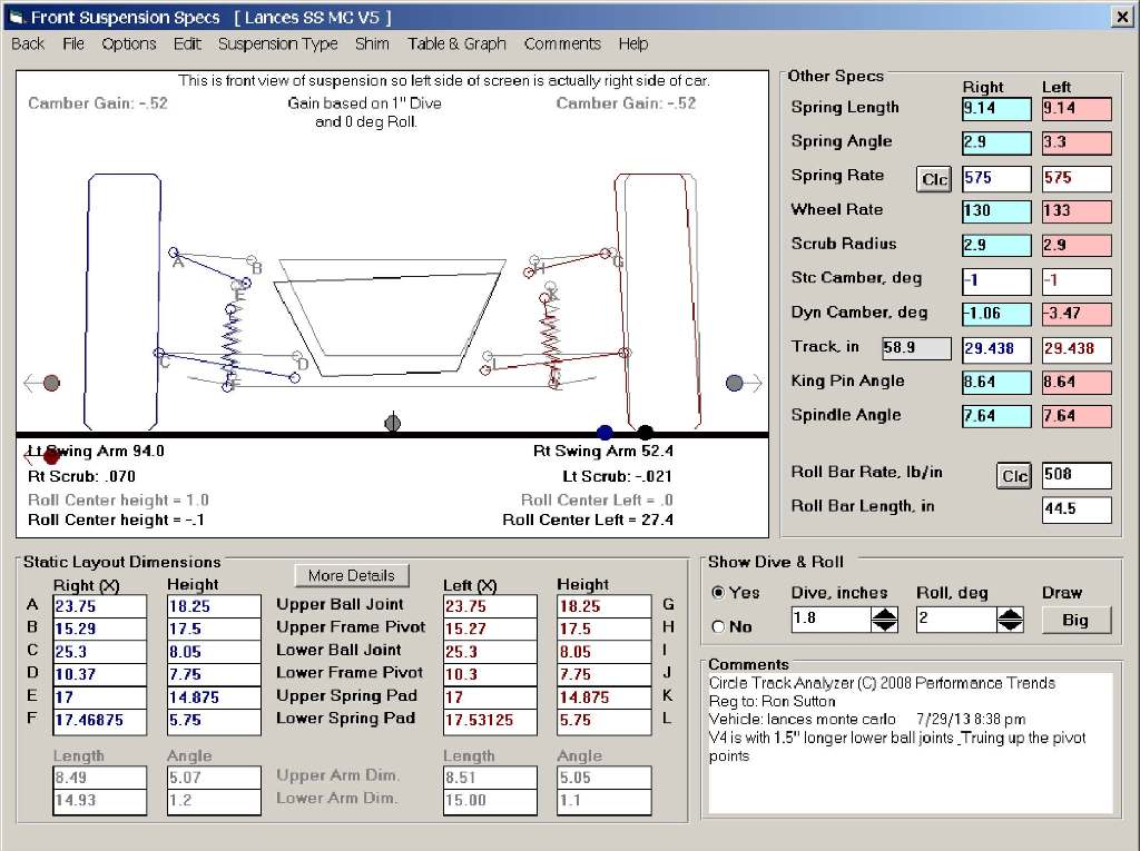

      In a PM, I proposed to Lance the following changes:
      A. New LCA's that move the lower ball joint forward for more caster ... and replaces the worn out bushings in his stock LCAs with poly
      B. Taller lower ball joints to move the roll center as outlined in the coming graphs ... and increase camber gain.
      C. Raise the car 1" front & rear ... to increase travel.
      D. Bigger front sway bar.
      E. Stiffer rear springs
      F. Adjusters for all 4 springs to adjust ride height & corner weights.
      G. Tie rod kit with spindles studs to correct bump steer.
      H. Modifying & correcting the pivot angle of passenger side LCA.
      I. Adding additional caster with LCA pivot modifications on both sides.

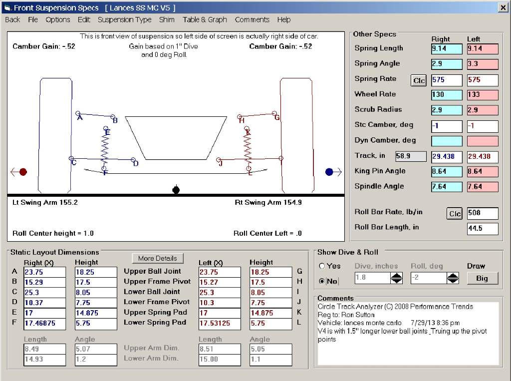

      I ran some new calcs with raising the car 1" and adding the 3/4" taller lower BJ's & like the set-up. I've attached the graphs. It creates a powerful migration of the roll center to the inside of each corner (evenly).
      Parts are starting to arrive & there is a lot of work to do. But the good news is Lance has to do all the work & I get to drink beer in the air conditioning while I wait on photos & updates.
      Here is the new front end geometry with corrections, ride height change & taller lower BJ's. The 2nd one is making RH turns & the 3rd one is making LH turns. Yes, I designed it to migrate the roll center that far & that direction.
      Reminder: The illustration is backwards, like your looking at the grill. The passenger side is on the left.
      This is at ride height.
      Name:  Front Geometry V5 Ride Height.jpg

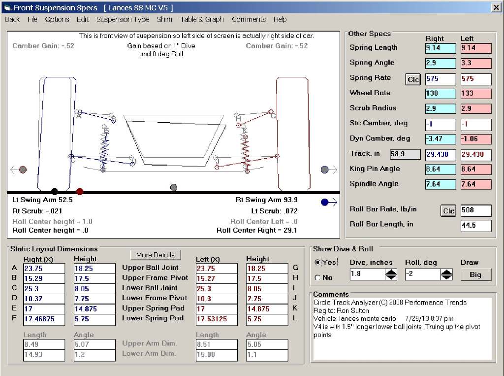

      This is "in dive" suspension compress, body rolled & making RH turns.
      Name:  Front Geometry V5 RH Turns.jpg
      This is "in dive" suspension compress, body rolled & making LH turns.
      Name:  Front Geometry V5 LH Turns.jpg

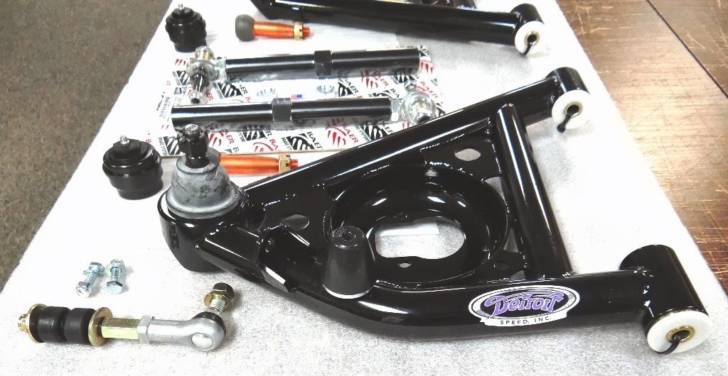

      So the parts are rolling in and phase 1 of the transformation is underway. I did the 36 MM sway bar swap up front last weekend and this weekend I'll do the spring upgrade in the rear.
      Here are some pictures of the new rear springs and spring height adjusters. The springs have a 2.5" pigtail on one end and a 4.375" ID on the other. The adjuster flange has a 3.5" OD the spring sets on. My friend John turned a set of spacers for me to make sure the big end of the spring stays centered on the adjuster.
      Here is a picture of one of the adjusters set over the spud on the chassis the top of the rear spring rides on.
      The DSE front springs that I am going to reuse have a 4.063" ID so John also made me a pair of spacers for the front adjusters.
      The adjusters offer 2" of range, from a 1/2" to 2 1/2"
      What gets me is these adjusters and springs cost about half as much as any off the shelf drop springs sold for these cars. Just think of how many of these cars have had springs changed out over and over again trying to get the spring rate and ride height where the owner wanted it... Doesn't this make a WHOLE lot more sense?
      Once I test fit everything, I'll decide if the adjuster will go on top of the spring or on the bottom, whichever it fits better on and gives the easiest access to is what I'll use. I think I'm going to drill a couple of holes in the adjuster flange and rosette weld the spacers to the flange to make sure they stay in place. On the big one for the rears, I can probably drill and tap it to run a screw into place but the small one for the fronts there probably isn't enough meat there for that. Heck, the spacers might not even be needed for the fronts, but they are there just in case.
      If everything goes smooth, I should have the rear springs mounted, adjusted and in place on Saturday. I then plan on putting the street wheels and tires back on the car and running our next SCCA event on Aug. 11th where I'll put the GoPro on each of the four wheels per run. This will give an apples to apples comparison to the video I did at the beginning of this thread, only with the sway bar upgrade up front and the stiffer springs upgrade in the rear.
      Then after that event, I'll start on the lower control arm upgrade up front which will be a bit more involved.
      Lance

      Same style ball joint as stock ... press in & GM taper. But with 3/4" taller pins & SD strong housings from Howe
      Will camber gain really be greater with the LCAs starting from more of a parallel position (from the taller BJs), as opposed to the previously inverted situation (mine are somewhat inverted, due to ride height)?
      See answer below.
      What rear spring rates are on the Lance-mobile? Is there a Panhard, and if so, does it adjust on both sides?
      No panhard bar. Stock Monte Carlo triangulated 4-link. We'll post spring rates & sway bar sizes soon.
      Antime you are changing control arm angles, you are changing the camber gain. Use this to your advantage.
      A lot of stock production cars have the swing arms so far out … there is little to no camber gain … often camber loss. Plus, in many stock production cars the A-arm angles put the roll center so low it is below ground ... and the CG is high … giving it a ton of leverage to roll the car … which is part of why many stock production cars roll so much.
      Typically, when you dial in your front geometry … you’re goal is to place your RC for optimum handling for the type of driving you do (or find the best compromise) … and end up with the desired camber gain.
      Some quick tips:
      • Anytime you’re shortening the “swing arm” … you’re increasing camber gain … regardless of how you did it.
      • Anytime you’re shortening the swing arm length … & keep the IC at the same height … you’re raising the RC.
      • Conversely, lengthening the swing arm length … & keeping the IC at the same height … lowers the RC.
      • Anytime you’re raising the IC of the swing arms … and keeping the same swing arm length … you’re raising the RC.
      • Conversely, lowering the IC of the swing arms… and keeping the same swing arm length … lowers the RC.

      More Parts Porn...
      Lance
