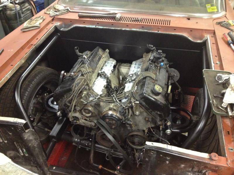

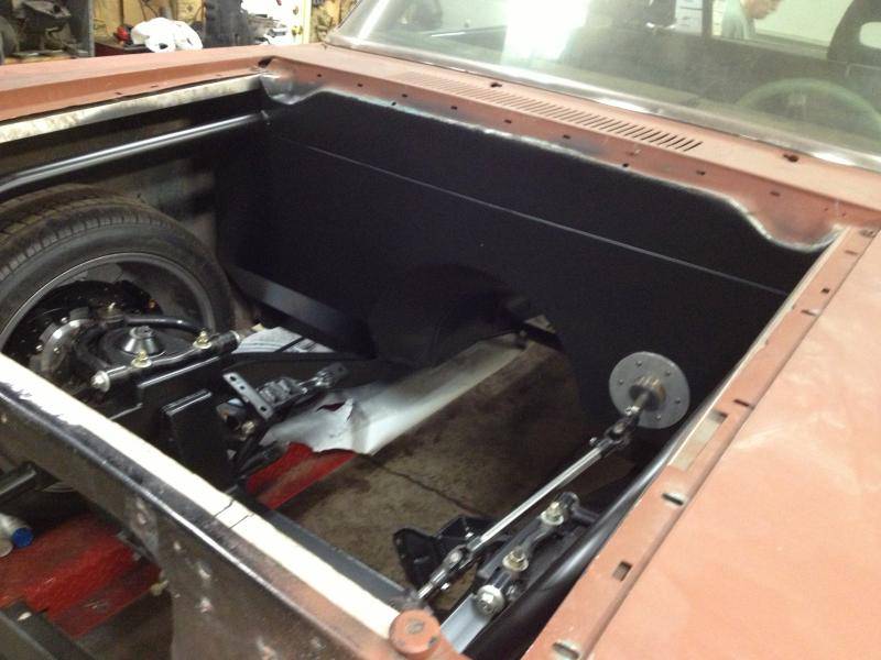

      Not a coyote, but still a mod motor.
      We pushed the firewall back 2". The car has a tube chassis now because by the time we redid the rear end and front end, we might as well just do the whole damn thing.

      Thanks for the feedback Doodler! Nice! Looks like it fits pretty well!! I have a few questions if you don't mind. Is that mod the same dimensions as a Coyote? What are your plans for a trans? Did you need to make any adjustments under the dash, steering column etc? I assume you built a frame behind the new firewall for lateral rigidity correct? That looks really great and you are making me think I can actually do this now.

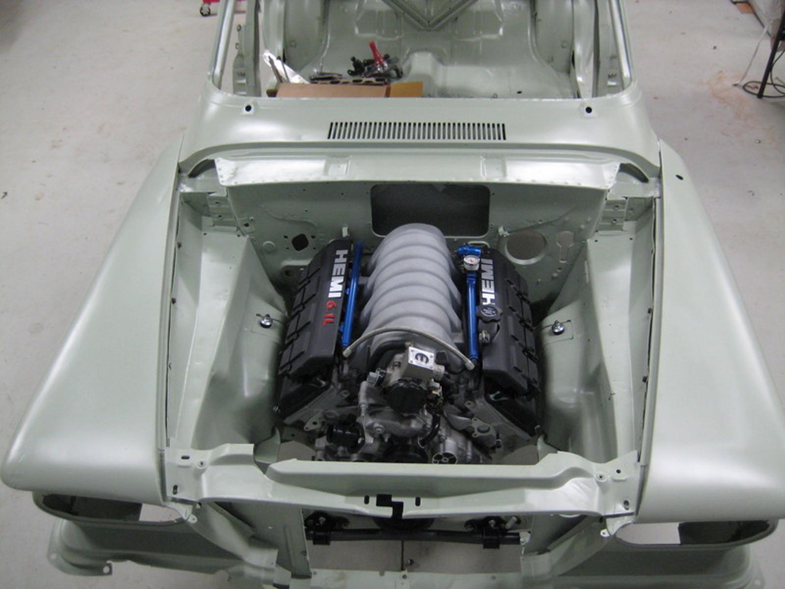

      be the pioneer. if we can get the new hemi in earl valiants and darts. ou can get the coote in a falcon
      I'm not sure if they are the same. A 4.6 is almost as wide as the 460 that I was originally going to put in there. It's shorter but gets really wide, really fast. I ended up going with a Lentech 4r70w auto trans. I didn't touch the dash at all for the conversion. When I started, I just decided to go all the way knowing it's not going to be easy or cheap. But it's what I wanted, so why not try. So the frame is 1 piece all the way to the rear clip.
      LIke Jason at TCI said, there are a lot of little things that I've found out with the 4.6. The Heidt's crossmember need's 1/4" notched out to clear the water neck on the block, new trans tunnel (but I was going to have to do that anyway), remote oil filter, master cylinder was relocated with no booster, and there is no way you are going to get off the shelf headers to work. Going into it, I knew almost all would have to be custom made so nothing really surprised me to this point. The car hasn't seen the road since 1996, so if it takes a little longer to get it to where I want it, so be it.
