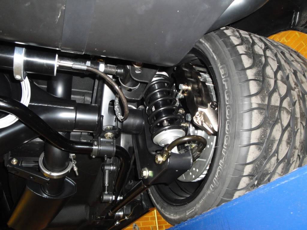

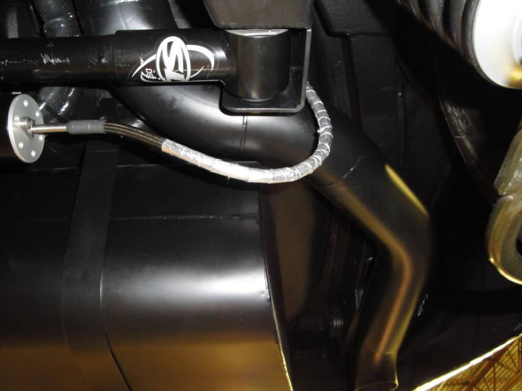

      I highly doubt you will find a kit that's going to work, a kit will probably work for the front section in front of the axle but once you get over the axle it gets very tight. Here's a pic of how DSE did my x pipe and one of the tailpipes, we did do some floorpan mods to tuck the exhaust up since the car is very low.

      Thanks Tim, that looks really nice. What coating did you guys use on the floor pans and exhaust? I'm going to black out the exhaust as well, I was considering the high temp "stove" paint or and engine enamel... not sure yet.

      The floorpans are undercoated with 3M undercoating, the exhaust is coated with our 1300* black coating.
