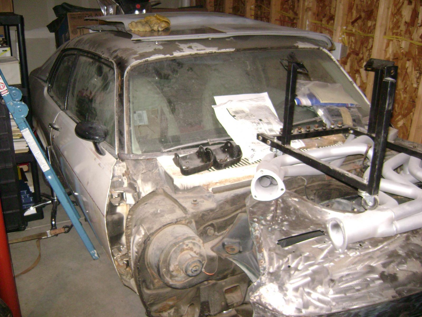

      More photos and an update
      Well, it looks like there is nowhere to go but up with this one. I have the motor almost back together after I pulled it down to balance it.

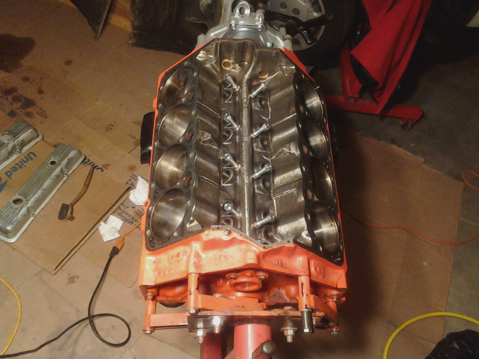

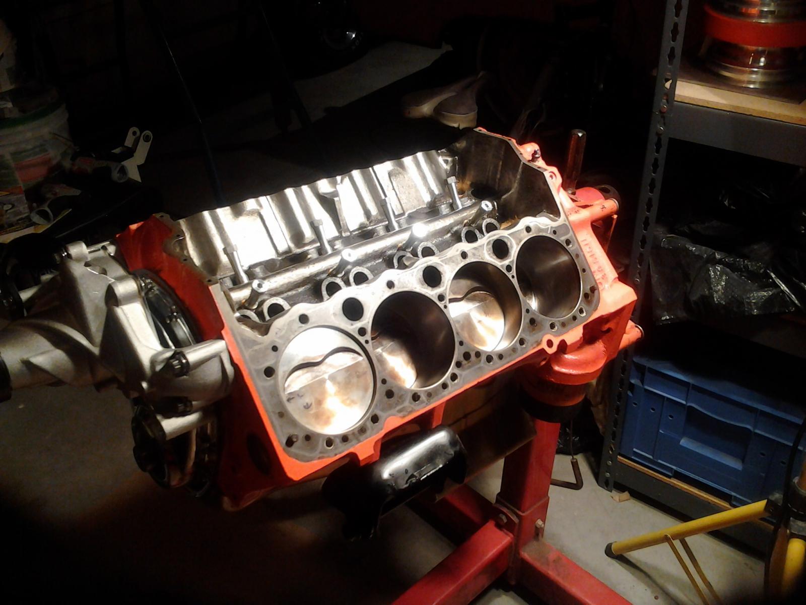

      I worked a bit on the motor today. I spent some time going through the I/O for the new ECM. The Mototron ECM's have a very open format and are very flexible. I will be using two Bosch LSU4.2 wide band O2 sensors to control fuel. I have a fuel rail, throttle body and MAP sensor from a GM Marine 5.7L intake. I will be using them. I am not sure what to use for the ignition. I have a Northstar V8 coil pack, but the ECM works best with Woodward smart coils. I will have to cross that bridge soon.
      The motor is a 400 block bored 0.030" over. The pistons are hypereutectic flat tops. The block was decked to make them flush with the deck. With the Vortec heads it is about 10.6:1. I installed a cast steel 350 crank to make it a 377.
      I had it all together and ran it a bit, but did not like the way it felt. I tore it all down and had it balanced. It was out a bit. I hope it feels better now. The power and torque are great though. It pulls hard right of idle and doesn't run out of wind until over 6000 RPM. It is a nice street motor. About 400 HP and 425 ft/lb of torque and a smooth idle.
      I cleaned up the deck and got one head installed. They are Vortec 906 castings that I ported and flowed on the Bosch Superflow bench before I left there. A buddy of mine from Bosch gave them a radius valve job just for fun. They don't flow too bad. I was able to wake up the exhaust ports where they were weak.
      The other should go on tomorrow night.

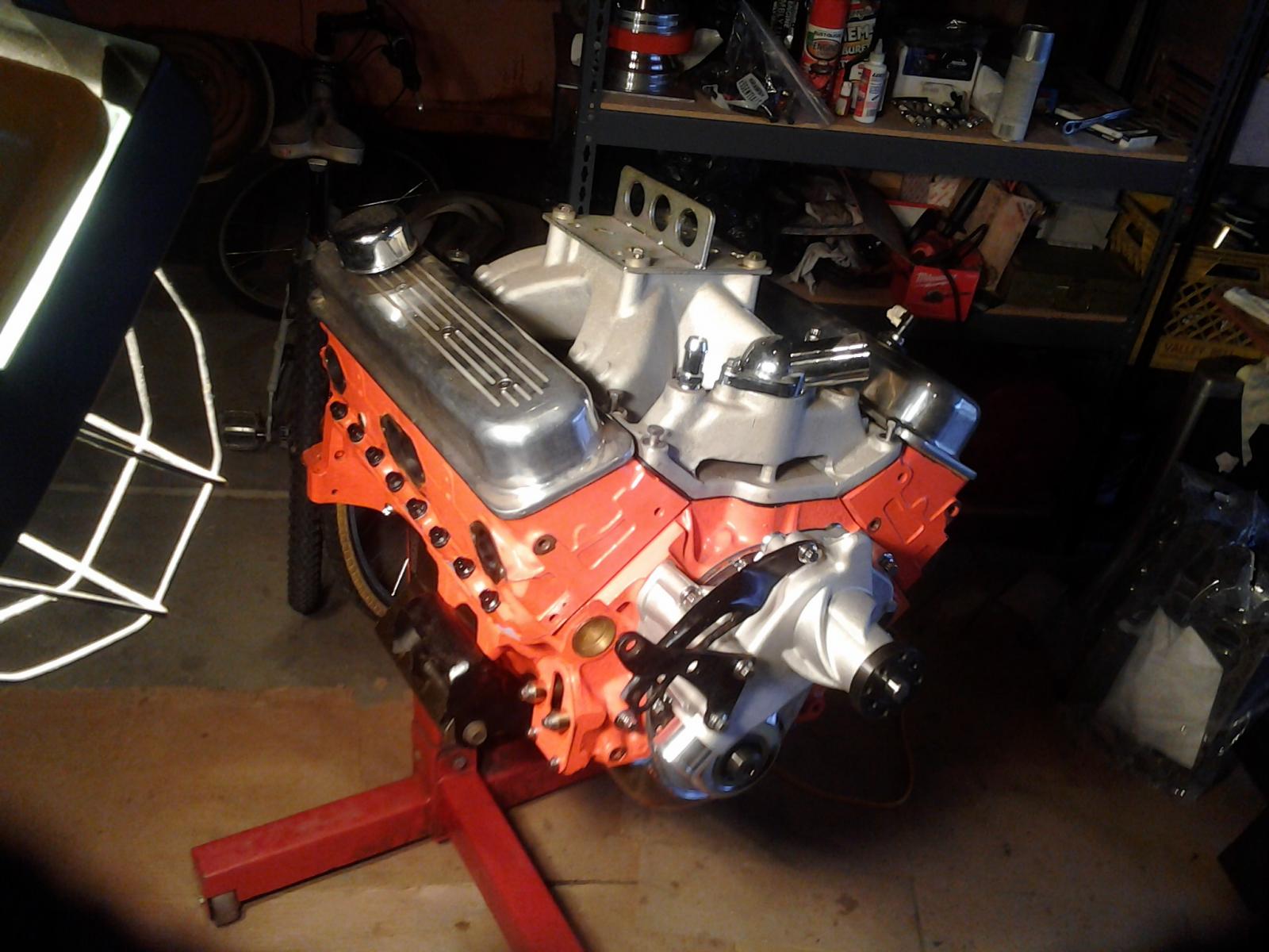

      I installed the other head today. I placed the intake on just to get a look at it. I still need to install the lifters and pushrods and set the lash.
      I am dragging my feet on the valvetrain a bit because I really want to convert it to a hydraulic roller to get some more power. Right now it is cam limited and has a lot left in the heads. I don't want much more duration, just more area under the curve.
      Anybody have some hydraulic roller lifters they are dying to part with?
      This weekend I hope to get some time to swap out the pushrod guides so I can install the adapters and LT1 valve covers. The ball milled centerbolt valve covers just don't look right on the vintage motor.

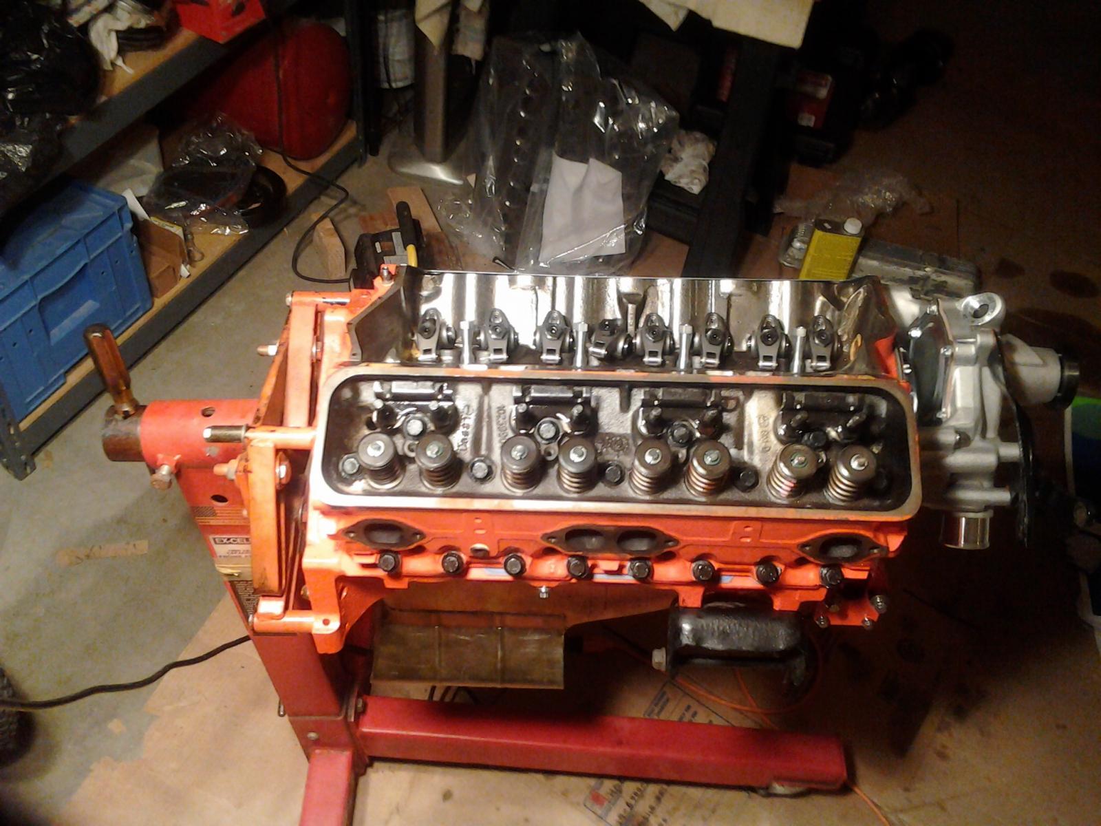

      I installed the lifters and pushrods yesterday. I found that my Speedway Motors valve cover adapters do not like my Comp Cams roller rockers. There is no room between the rockers for the adapters.
      I will be cutting them and then adding another bolt down into the pushrod guides to support the inboard side of the adapters. I hope it works well.
      I have almost all of the paint off the LT1 valve covers. I like the bare metal and may leave them unpainted.

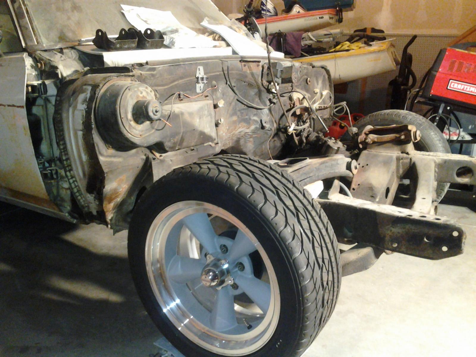

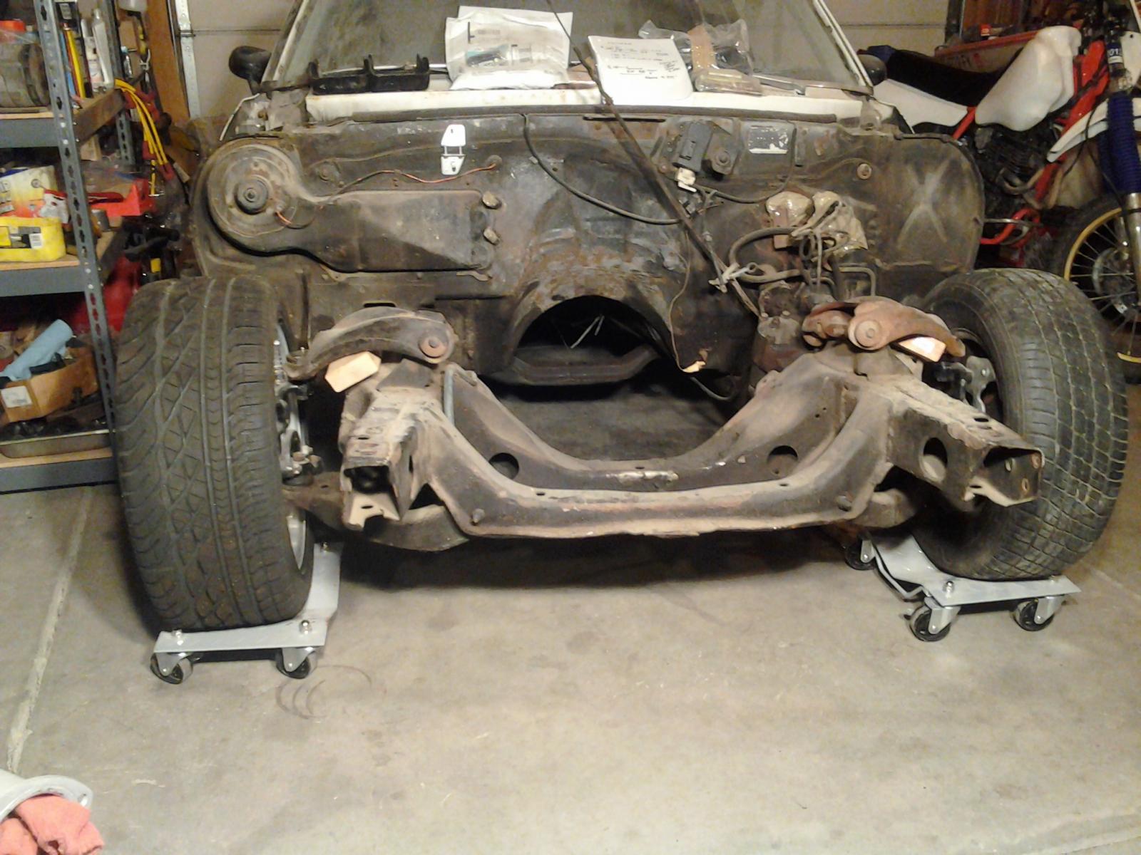

      I think I have collected more jack stands than I need. It comes from having too many project going at the same time.
      The suspension is coming off. The Landrum 700lb. springs and adjusters will go back in. I have an Afco low friction bushing kit with ball joints to replace the old dry rotted rubber. I will use the stock arms.

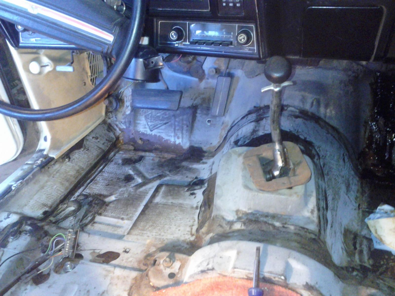

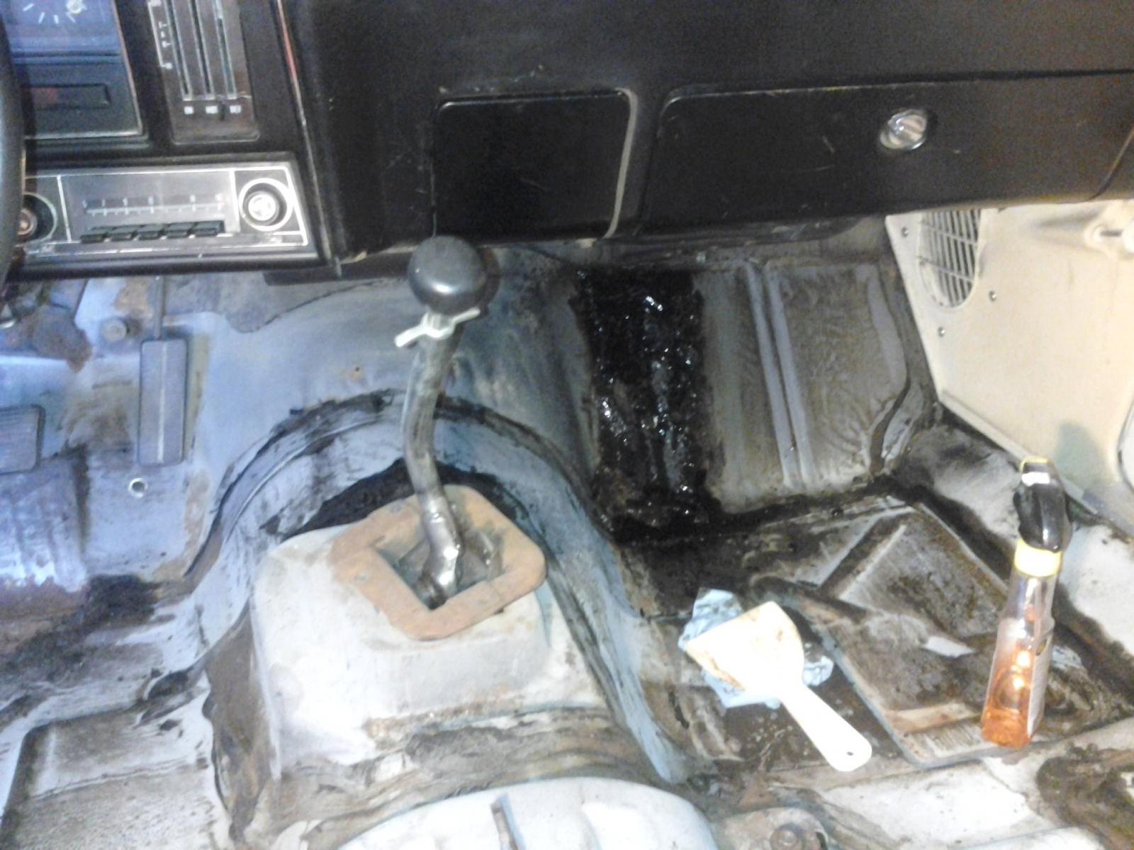

      I removed the front seats and carpet. Surprisingly, the carpet was in pretty good shape after I cleaned it a bit.
      As you can see the floor is in fair shape for 40 years old. This car lived most of its life in Iowa and Michigan. It survived very well.
      I need to make my measurements and begin cutting to channel the frame about 1/2 inch up into the body.
      Wish me luck on that endeavor. Measure three time and cut once!
