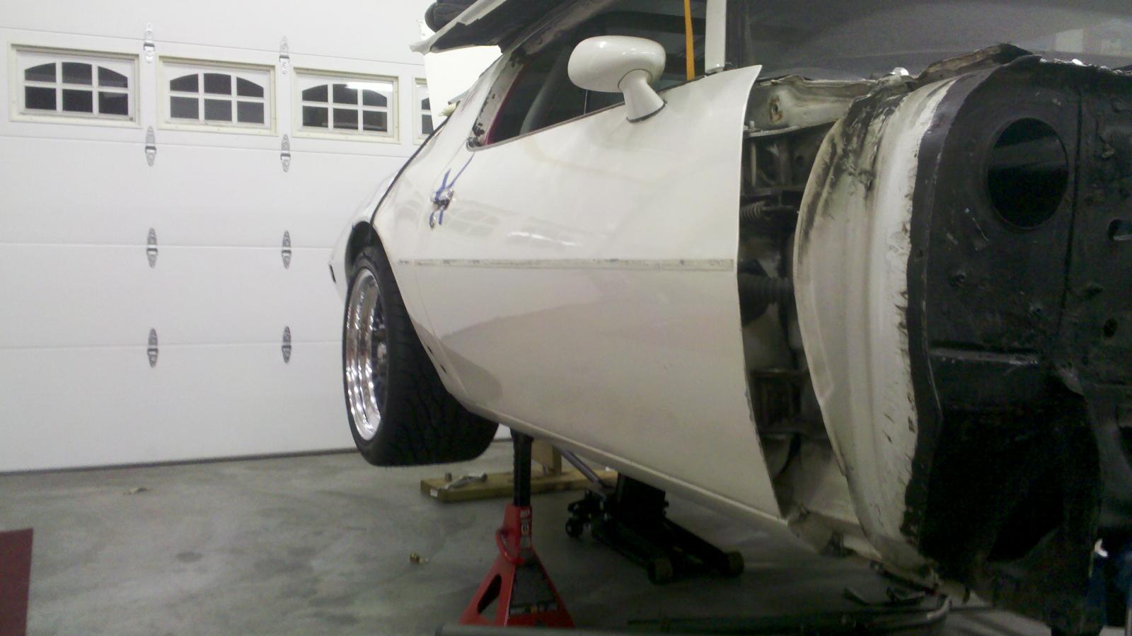

      My front is a 9.5" width 18, sorry forgot to add that. No pics of the front yet, but here is the rear:
      Note that the 335 would require moving the leafs inboard or going with a link setup.

      5.75 inch BS up front for a 275 18"... Rear would be 295 (not sure on back spacing). If you went with DSE mini tubs you could get rears like the car above, 335s w/ a 5.5" backspace but that is narrowing the rear 9". If you don't narrow the rear, adjust the BS accordingly. Hope this helps.

      Hi Chadman! Nice car! what size wheels are those you have on the rear? I want to avoid going the mini-tub route - I want to try and get the widest wheel possible at the rear but without any serious modifications.

      Quote Originally Posted by v8 stingray View Post
      18x12 w/ 5.5 BS (rear is narrowed), 335 Tire. You would need to mini-tub to fit this size. Let me know if you have any other questions, I'd be happy to help!
