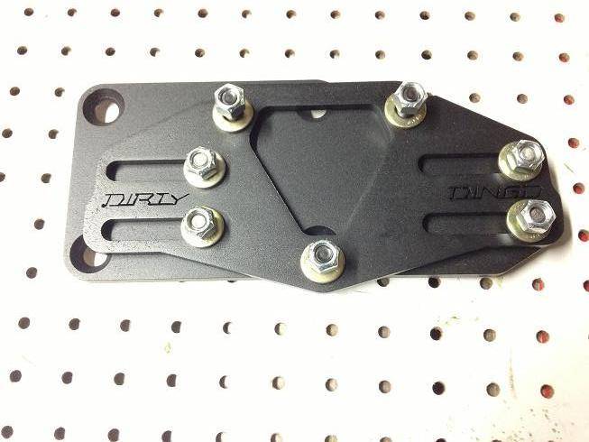

      These are my Dirty Dingo sliders powdercoated black (passenger side). They just arrived a couple of days ago.

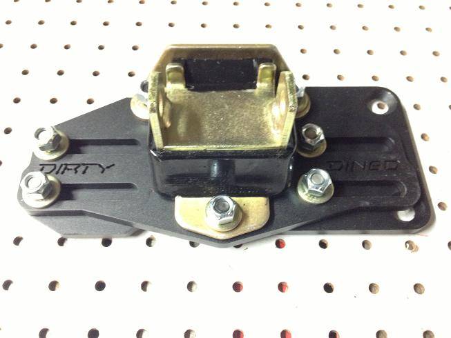

      And the driver's side with the Energy Suspension poly motor mounts loosely attached:
