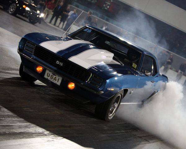

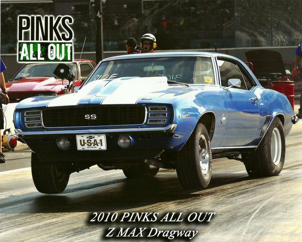

      Nitrous fed 582 Big Block using our mini-tubbed 4-link kit.
      Best ET 9.84
      Best 60 foot 1.42
      Best MPH 139.88
      This same kit also posted .96g skid pad and 48 mph slalom numbers(255 & 295 tires). That was actually the Yellow '70 Nova we took to the first Super Chevy Handling Challenge.
      -J
