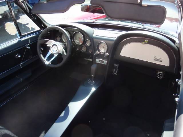

      By the way I have one in my 66 corvette. I don't abuse the trans as it's stock and engine is 505 HP at crank. I have tap up and tap down shifting but no gear indicator so it a cruiser only.
