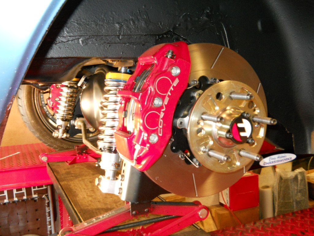

      I went with the full floating rear axle. Moser sells this 9" floater minus the center section and brakes for $879. It can be ordered in any width and you weld on any brackets you need for your suspension.
      http://www.moserengineering.com/circ...floater-9.html
