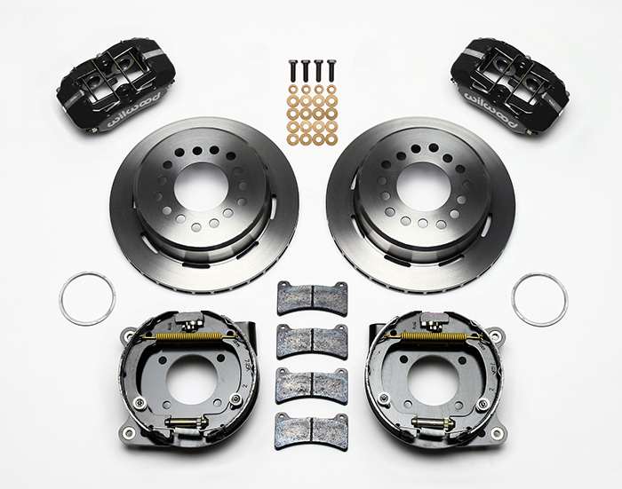

      Follow this link and go about half way down the page for a possible solution (hydraulic line lock): http://www.arizonazcar.com/brake.html
      71 Formula, 455 SD/KRE D-Ports, Crower solid cam, TKO 600, 3:73 Eaton posi. 17" ARE 200s, , 1LE brakes, Koni, Rancho adjustable bars, Hotchkis springs
    8. #28
      Waterloo, Ia
      1,408
      Its too bad Wilwood dosent make the eldorado style rear caliper with the mechanical rear parking brake. It would be a nice upgrade for a very common swap. My right stuff eldorado style rear parking brake works great.

      Wilwood does use the same mounting sized D154 rear caliper (in single and multipiston) as the Eldo/TA 2.5" piston on some kits that have a better integral E brake. Since it is a floating caliper it is a little better about not having pad knockback in hard corners.

      The integral drum style Ebrake is a much better unit. They bite much harder and most all OEM's use them now as well.
