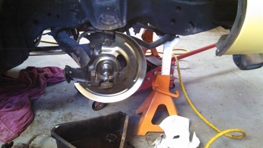

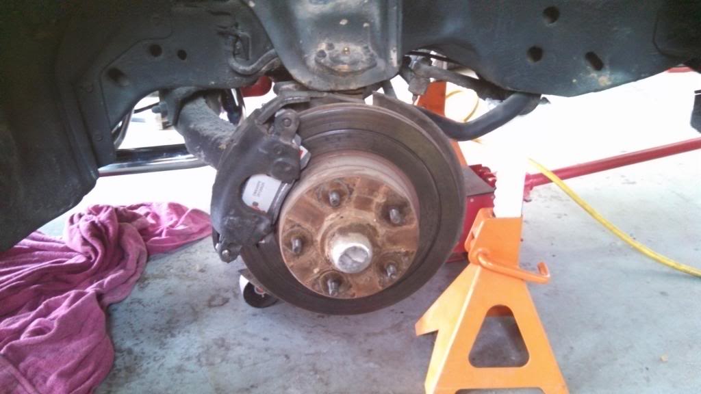

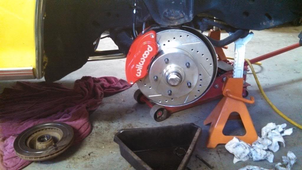

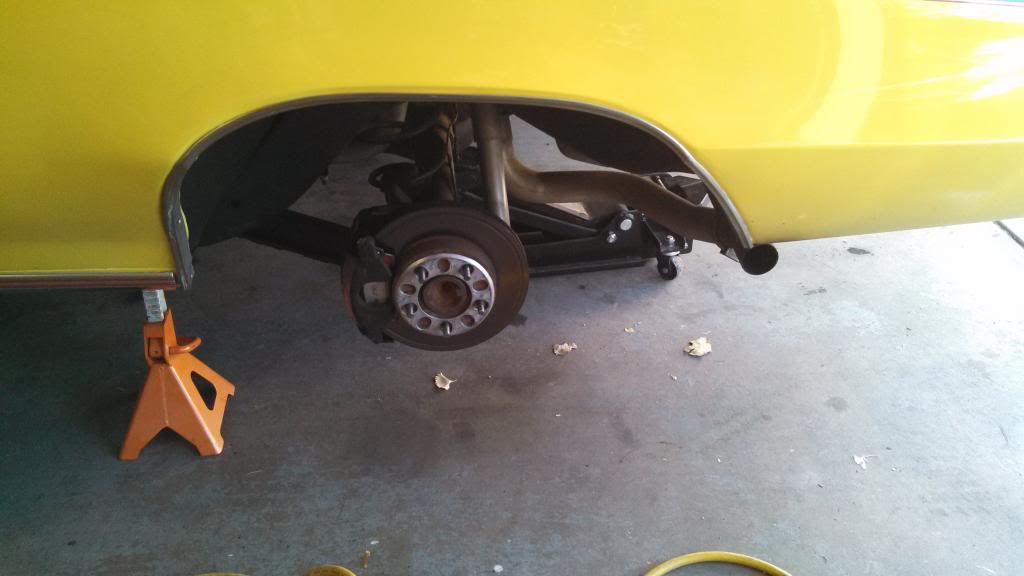

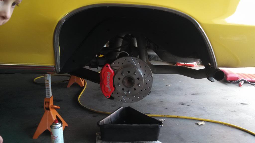

      I just upgraded on my 72 GS. Here is my summary:
      Well I had pretty much talked myself into taking the new calipers off and going back to OEM D52s due to the fact the wilwood D52s did not fit in my stock 15 inch buick ralley wheels. The wilwoods are slightly larger on the outer edge and the buick wheel is not a true 15 wheel...they use the same center as a 14 inch wheel....and bring the hoop in to match...so I would call it a 14.5 inch wheel...
      I was running a stock disc setup in front and a rear disc setup from a 76 Cadillac that used d52s. All used to clear my stock wheels.
      I decided to do a performance test before I pulled the wilwoods back off.
      Calipers are staying on.
      My 30-0 braking distance decreased by 13 feet! It was interesting because based on the seat of the pants test I did not think there was any significant improvement. I did not believe the results at first...repeated 3 times.
      Wish I could have done a pre 60-0 test.....but the neighbors frown on 60mph anything and I couldn't drive the car very far before I fixed the sticky rear caliper.
      In summary:
      Pedal feel improved
      Rear bias improved - no more rear lock up
      Braking distance improved
      Stock buick rally wheels don't clear wilwood d52 calipers. Fronts would clear if 3/16 wheel spacers added. Could not space the rears out enough without causing tire clearance issues.
