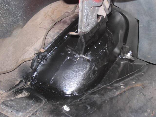

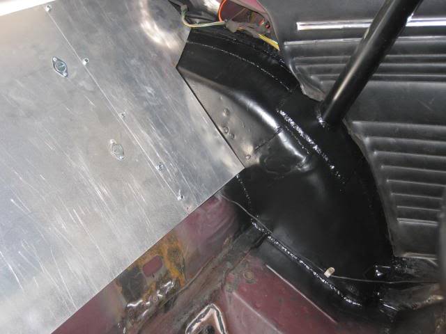

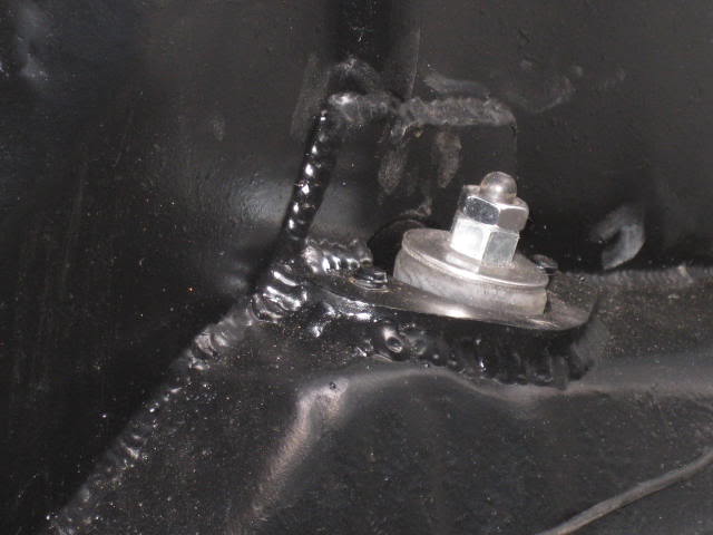

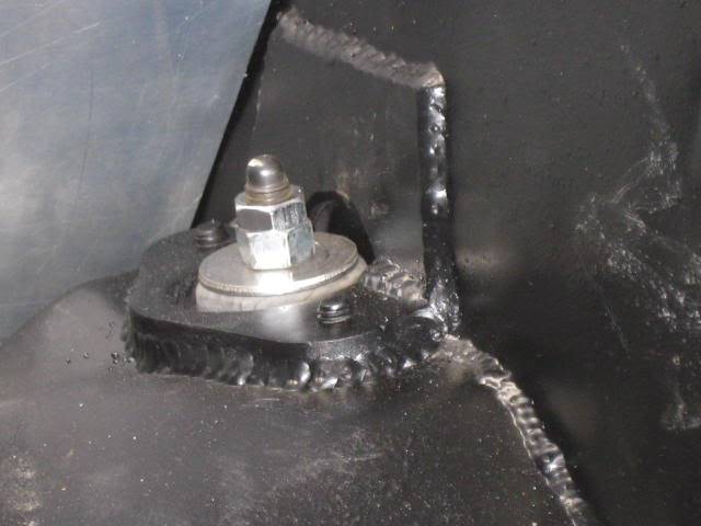

      No need to buy mini tubs. Take the existing wheel housings in the trunk and move them inward 1 9/16". Weld a strip of sheetmetal in between. Leave the lower shock mount and move the upper over. You could fit a 315-325 depending on who makes the tire. Worked for me.

      No offset shackles. Still used stock tank. I did narrow the stock tank afterwards to move my exhaust in board of the leaf's but it isn't necessary unless you want to run your pipes all the way out. I cant post the pics of the work while it was in progress because they were sent to me via e-mail but if you give me your e-mail address I can send them to you. I do have some pics I can post of it completed......give me a sec and i'll dig them up.

      Running 17" wheels. Clearances are fine but tight. I have about 7/8" to the leaf and about 5/8" to the quarter panel with a 315. Rear quarter lips have been rolled. If you intend on lowering the rear quarters over the rear tire a watts is needed if you will race the car in some form or another due to the differential shifting from side to side when driving hard into corners. I'm working right now but when I get home I'll e-mail pics.
