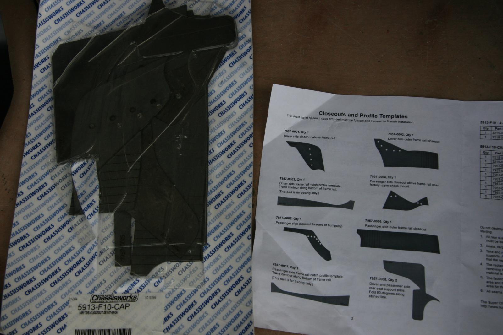

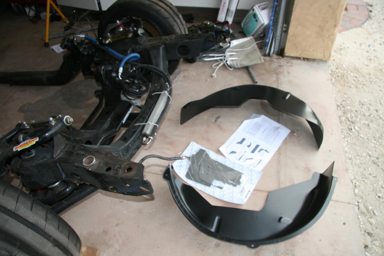

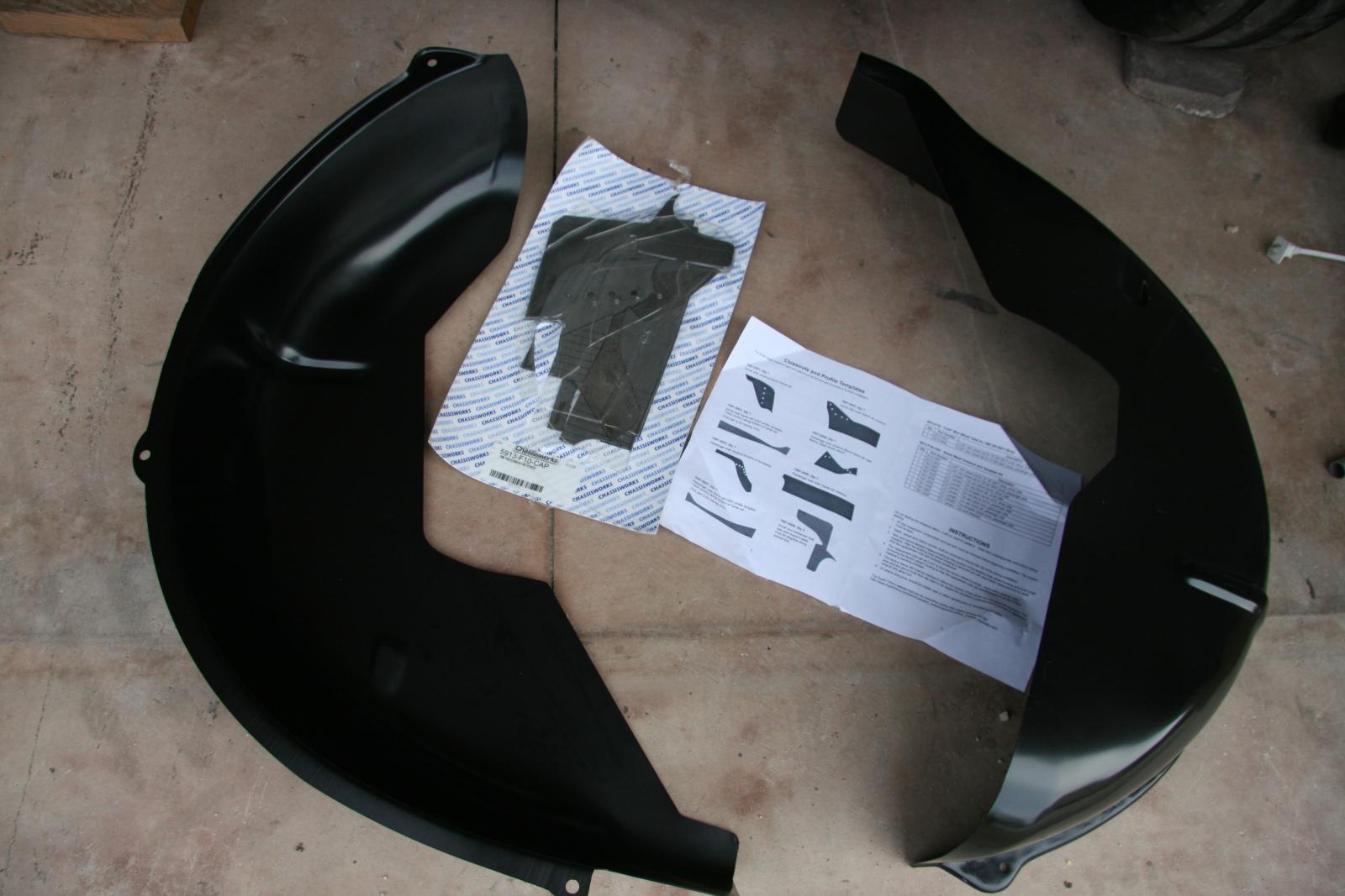

      I purchased and had the DSE installed on one of my 67 Camaros. Had to buy sheetmetal to make the filler pieces. I am also working on a 2nd 67 camaro of which I purchased the Chassis works mini tubs. The sheet metal fill pieces come provided in the kit, and appear to be the same as the pieces needed for the DSE kit. see pics. Quality seems good.

      Thanks a million Art. I went and picked up my kit today and will be working on getting it in soon.
