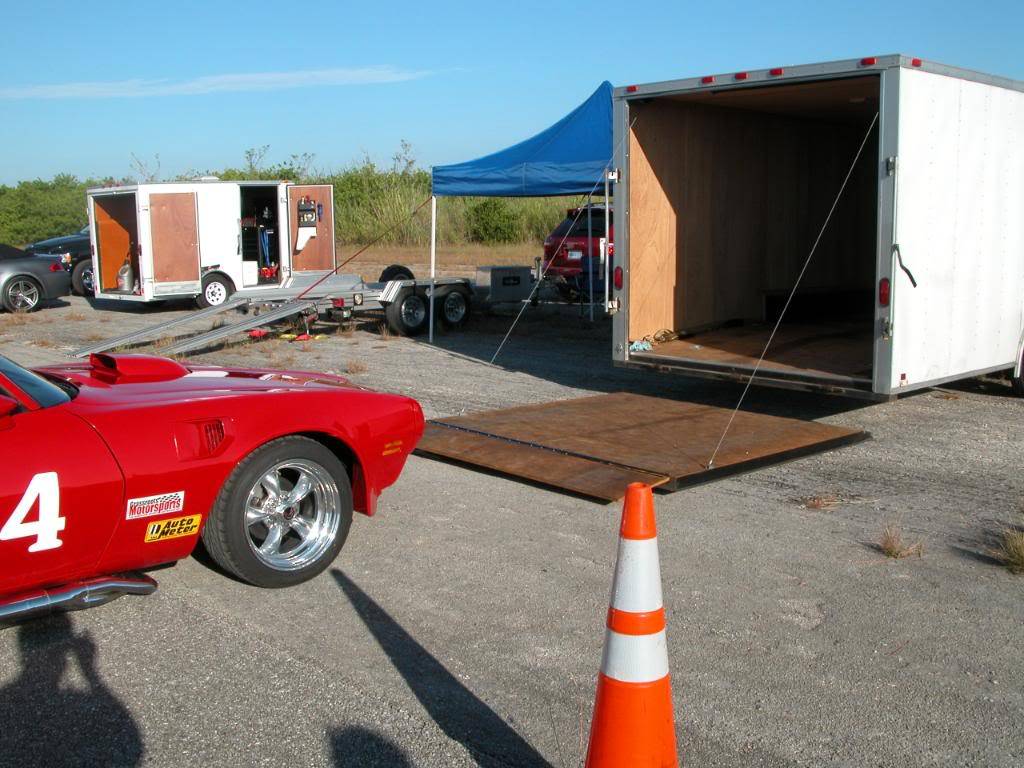

      That's my method, but the collection of ramps needed to get my car in/on the trailer without losing my beloved CF splitter means a lot of pushing. Then once I get the doors clear, I usually drive it the rest of the way off.
