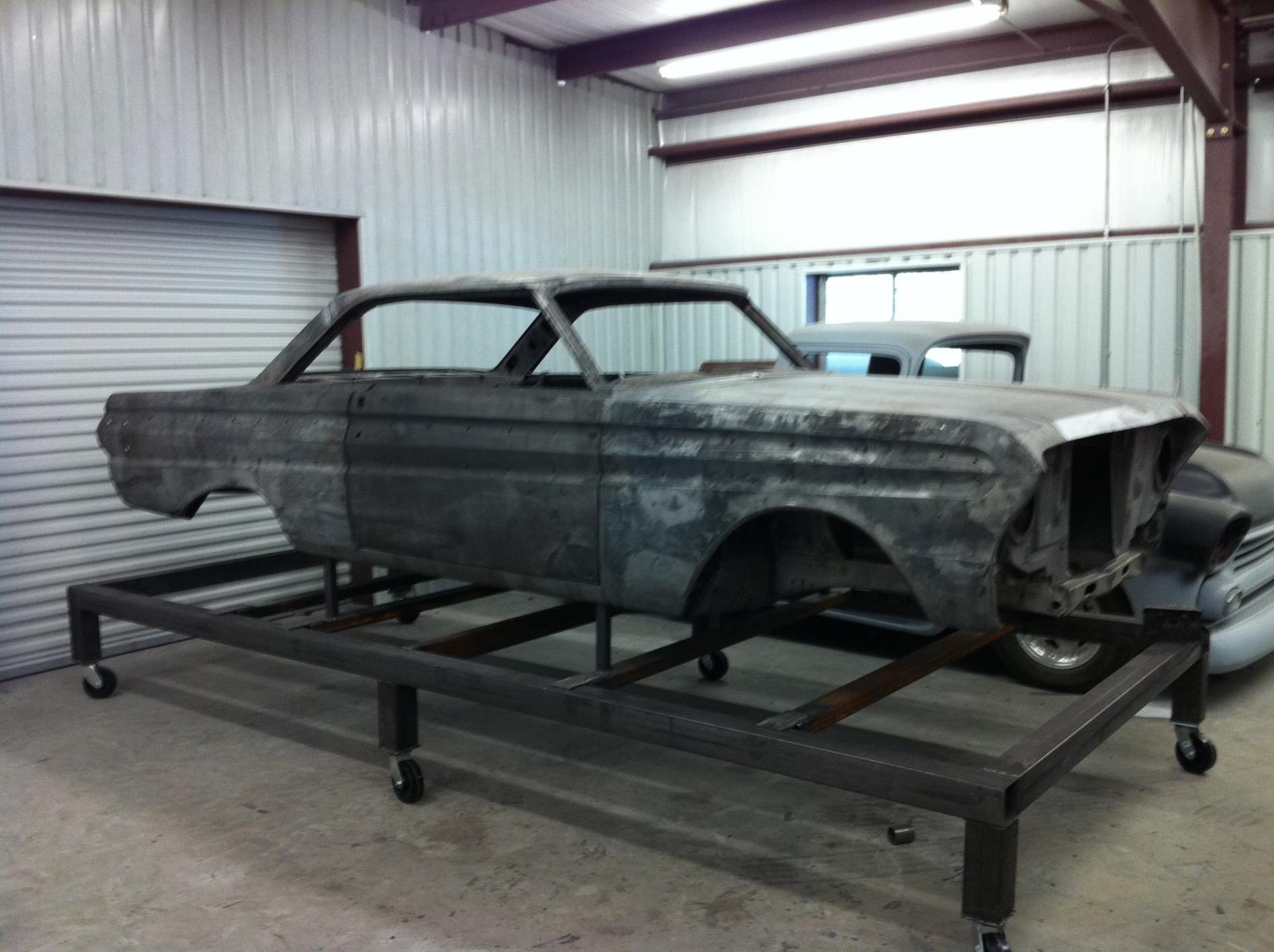

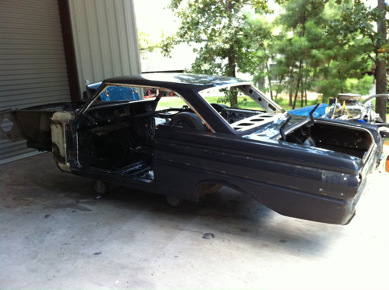

Size:  193.3 KB This is the way it looked before teardown...
      Name:  Falcon Teardown 1.jpg
Size:  488.6 KBName:  Waiting for quarters.jpg
Size:  182.2 KB4 days later, then off to the stripper...

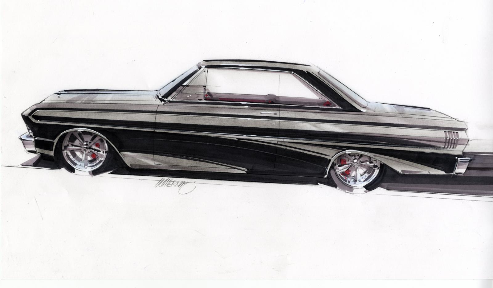

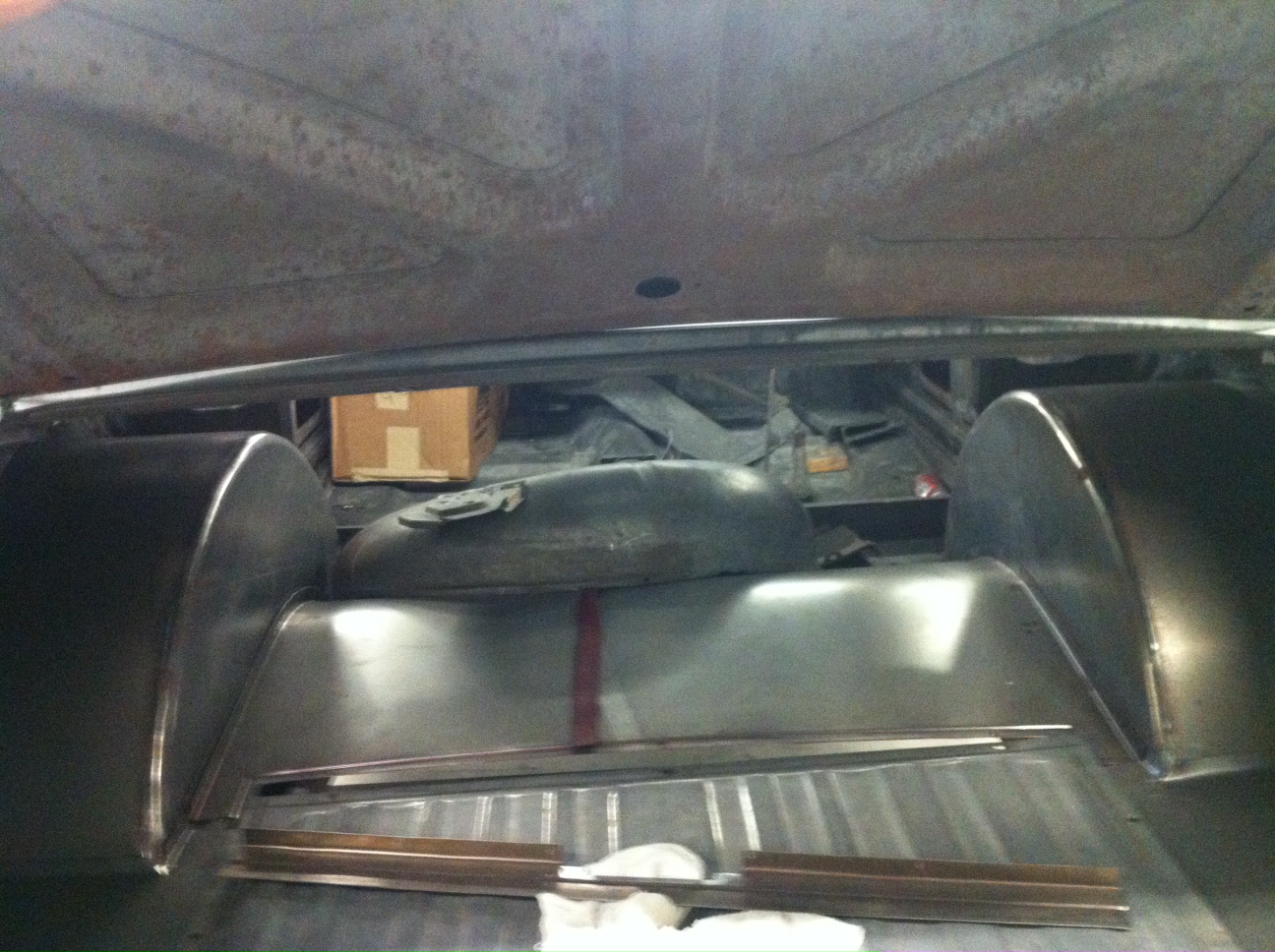

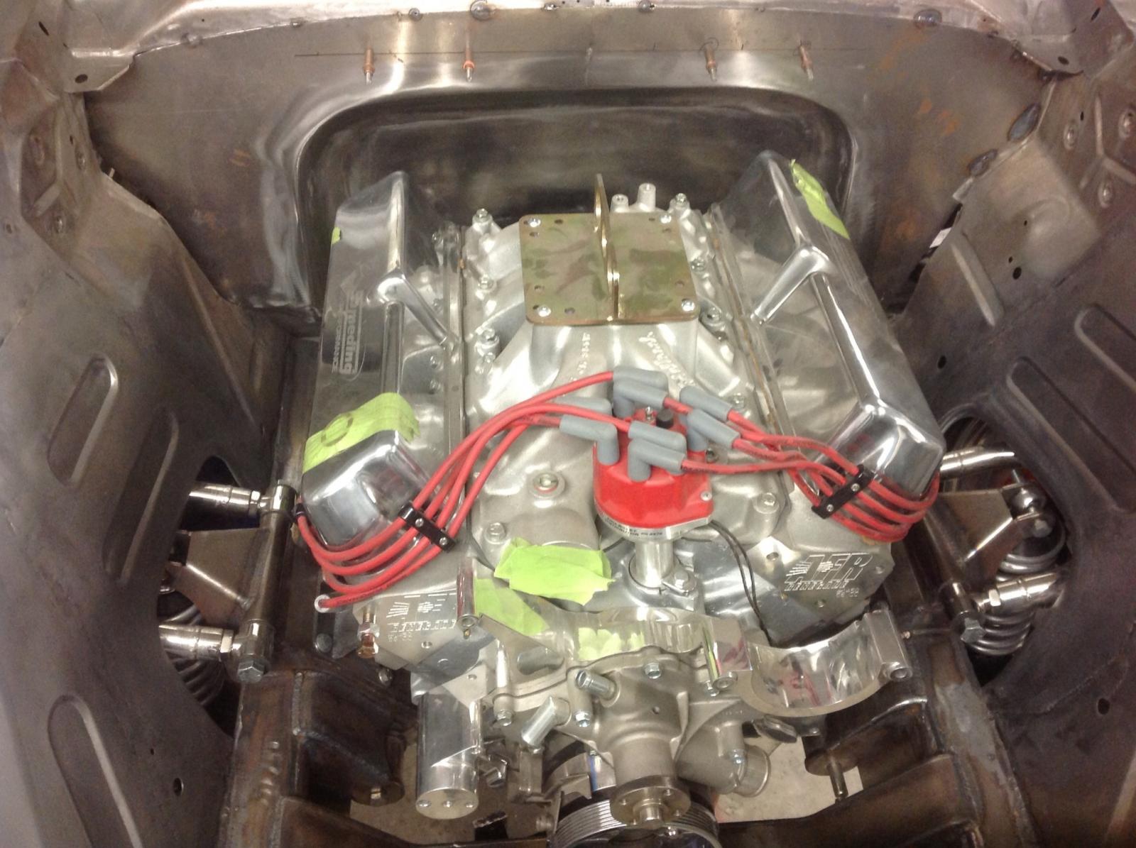

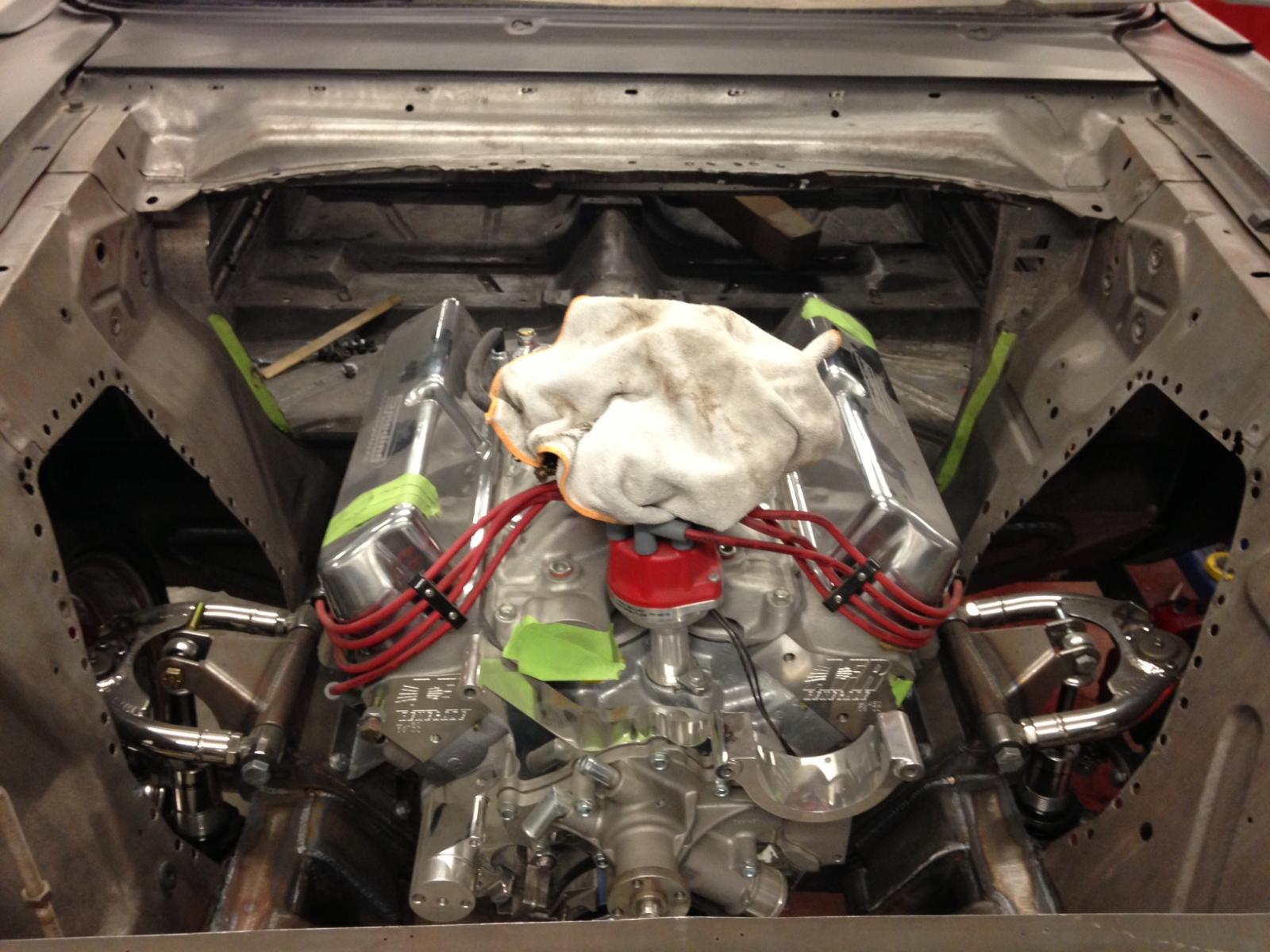

      Thanks for the feedback. The plan originally wasn't to go this extreme; I was planning on a decent rebuild w/a 406/AOD, coilover FS, basic 4 link out back, reuse the interior that I redid in 2006, reuse the 17" Torq Thrusts, etc. Then I decided that I NEEDED a 427 in it. And a 5 speed. The nearly 600HP mill then needed a better cradle, so I went with the Pro G FS. In order to get the ride height right and still keep the taller Windsor under the stock hood we had to chop, modify & move the double x-members, set the engine back (there went the firewall) then modify the LCAs and go with a rear Flaming River rack. Out back, the outer wheelhouses had a bit of rust and needed patchwork, and the 18x10s out back needed a bit more room, so we moved the rails in 6", fabricated new tubs, and built the custom 4 link. The rendering was done a year or so ago. Good thing I have a spare (the Fairlane).
Size:  412.0 KBName:  Feb bird 3.jpg
Size:  195.0 KBName:  Feb bird 6.jpg
Size:  186.5 KBName:  Rendering 2.jpg
Size:  118.9 KBName:  tubs1.JPG
Size:  541.0 KBName:  Fairlane SM1.jpg

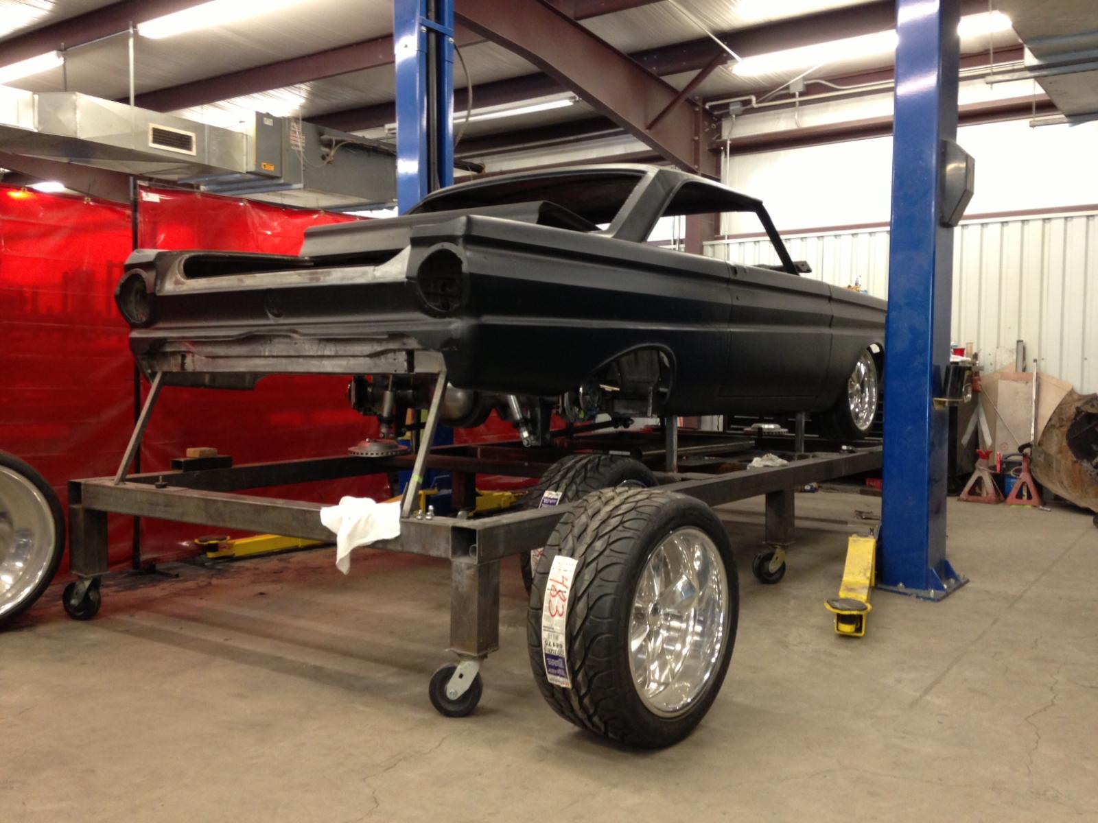

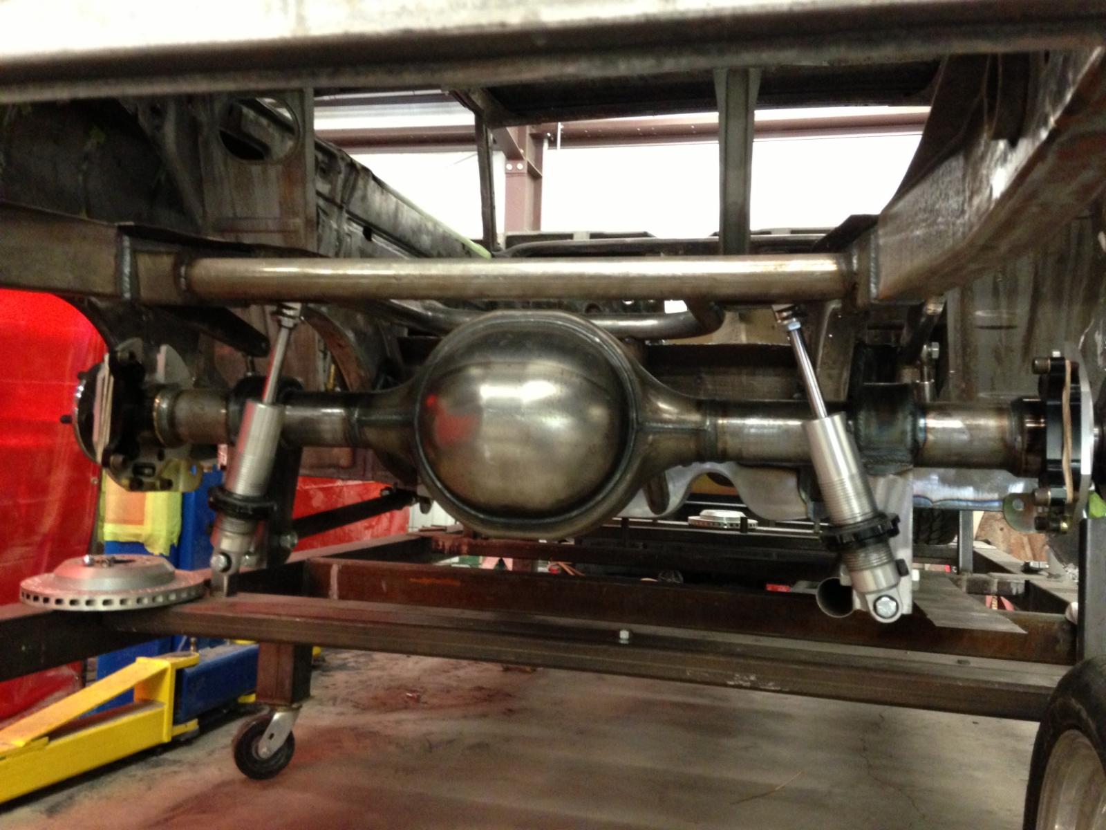

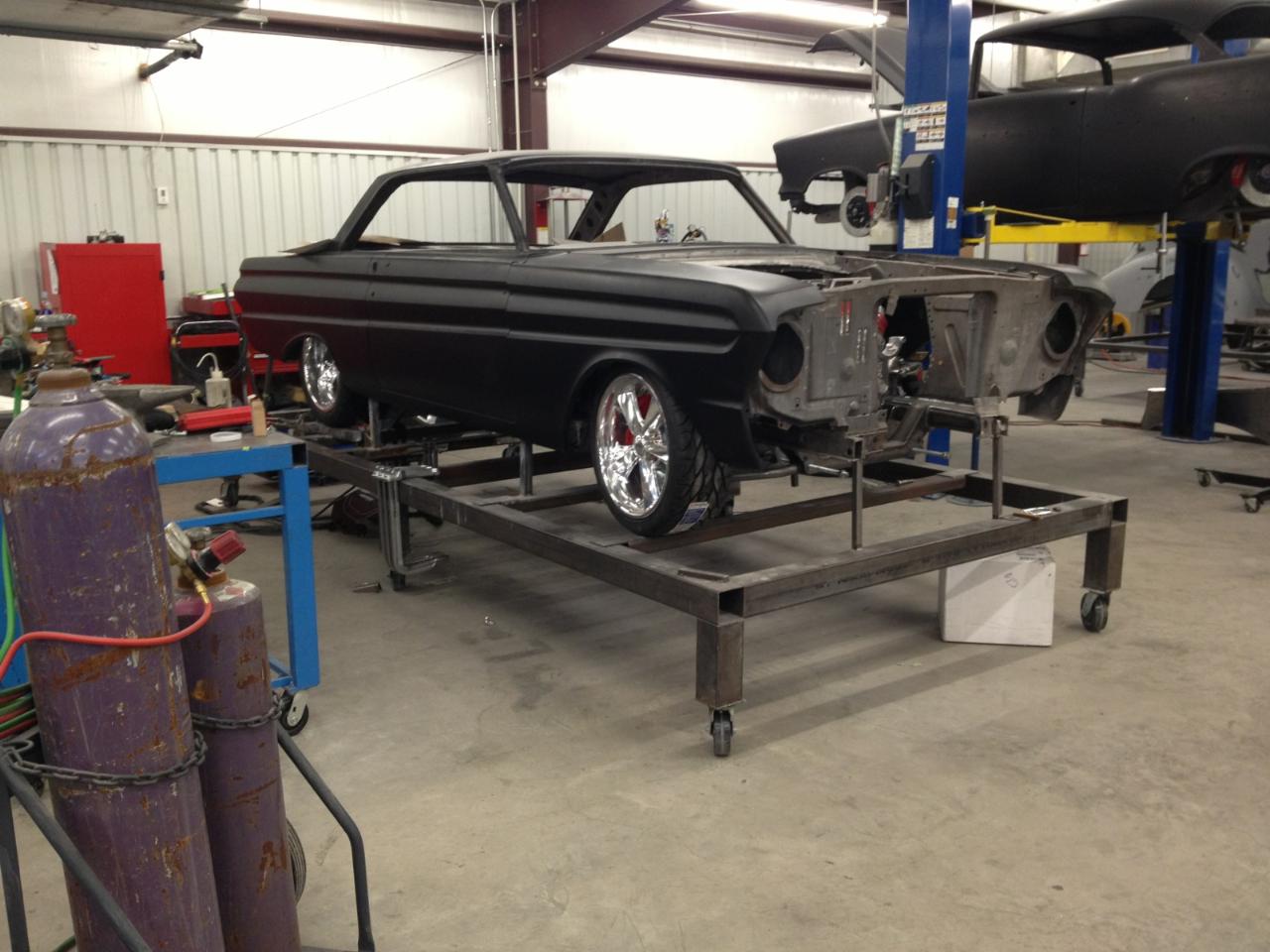

      April Updates - Finally off the stand
Size:  197.7 KBName:  image.jpg
Size:  206.2 KBName:  image.jpg

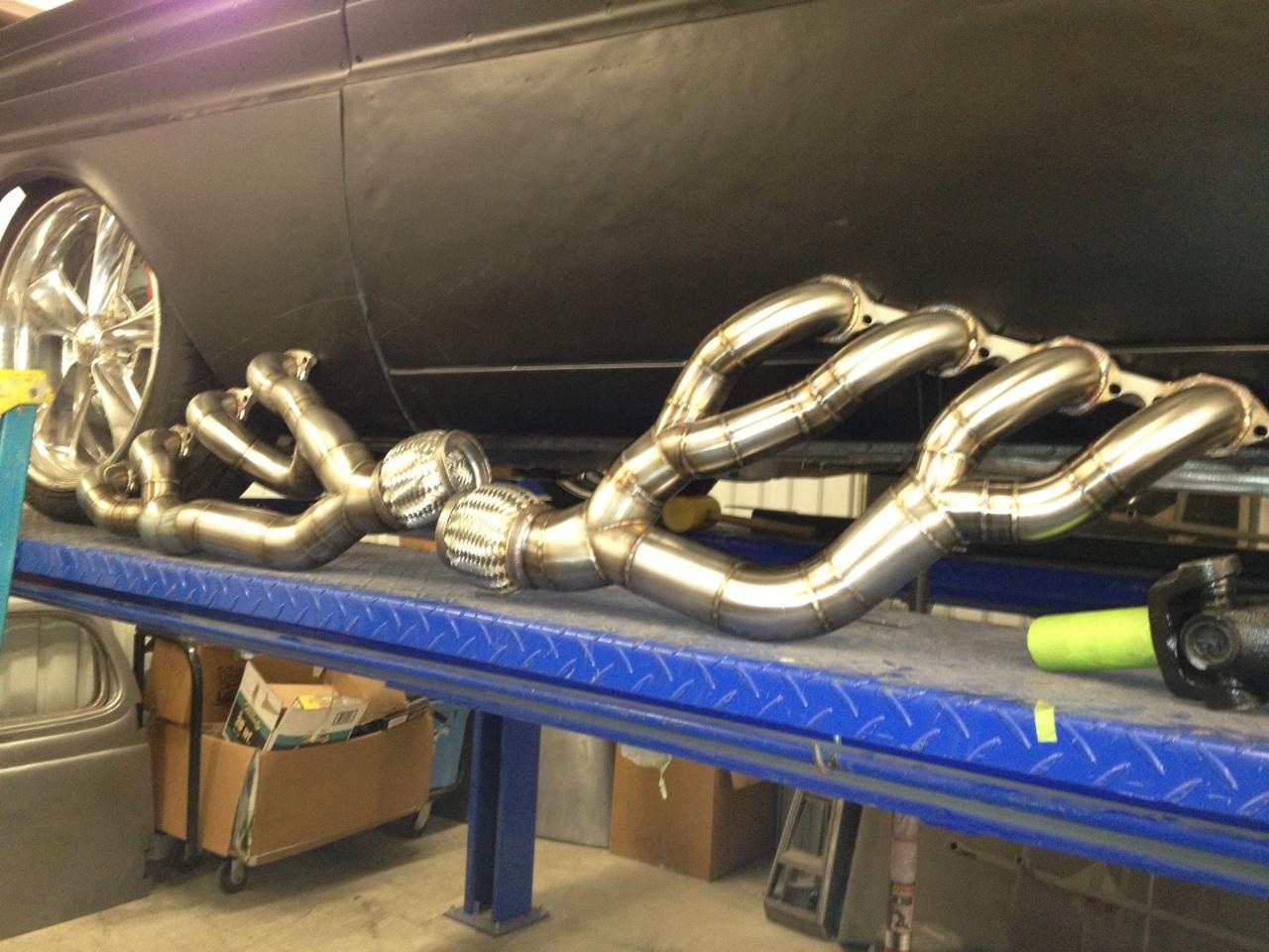

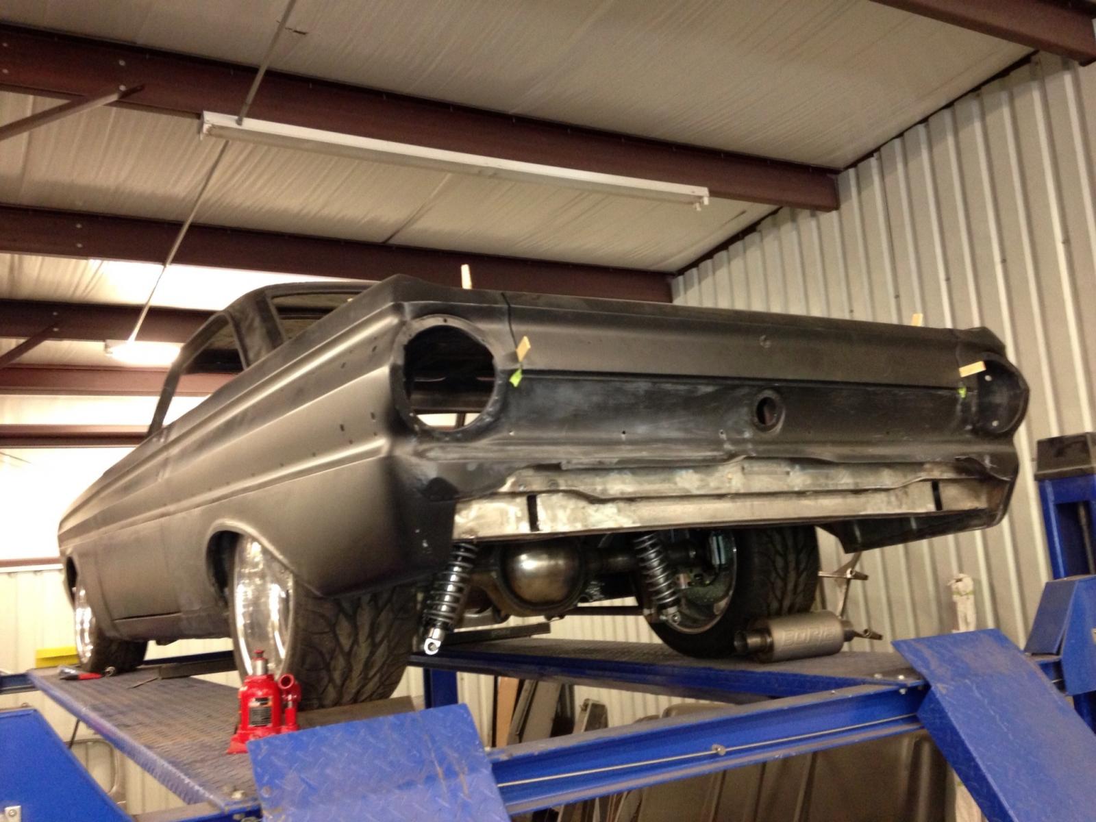

      Suspension fabrication is complete, firewall, trans tunnel & underhood sheetmetal done. Headers fabbed last week, rest of exhaust to be complete next week.

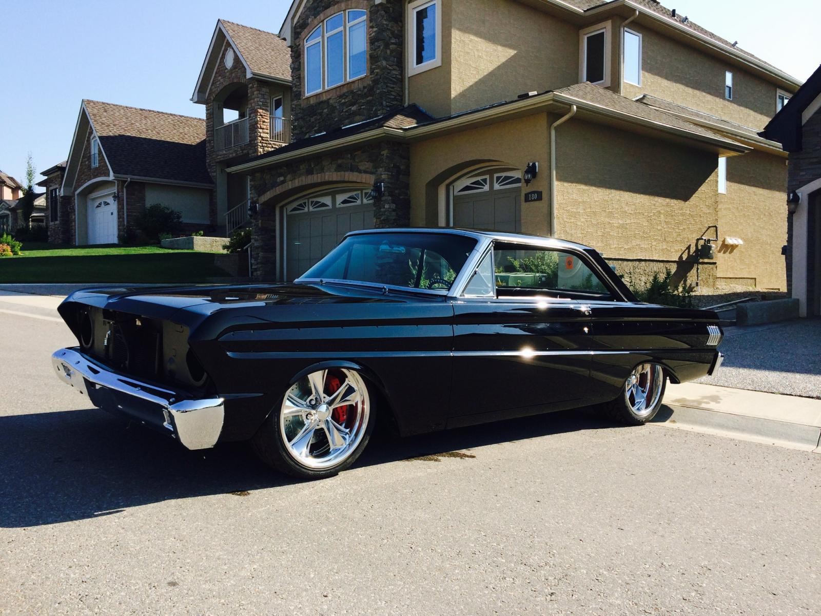

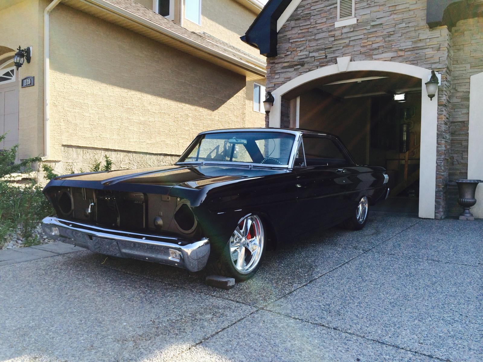

      Done(ish). It's a beast...

      Looks awesome, get some rolling shots.
      1965 Falcon Hardtop
      Dec 2010
      708
      I see pictures of great plumes of tire smoke on the horizon . . . followed by difficult cleaning of pretty black paint. The Falcon looks great!
