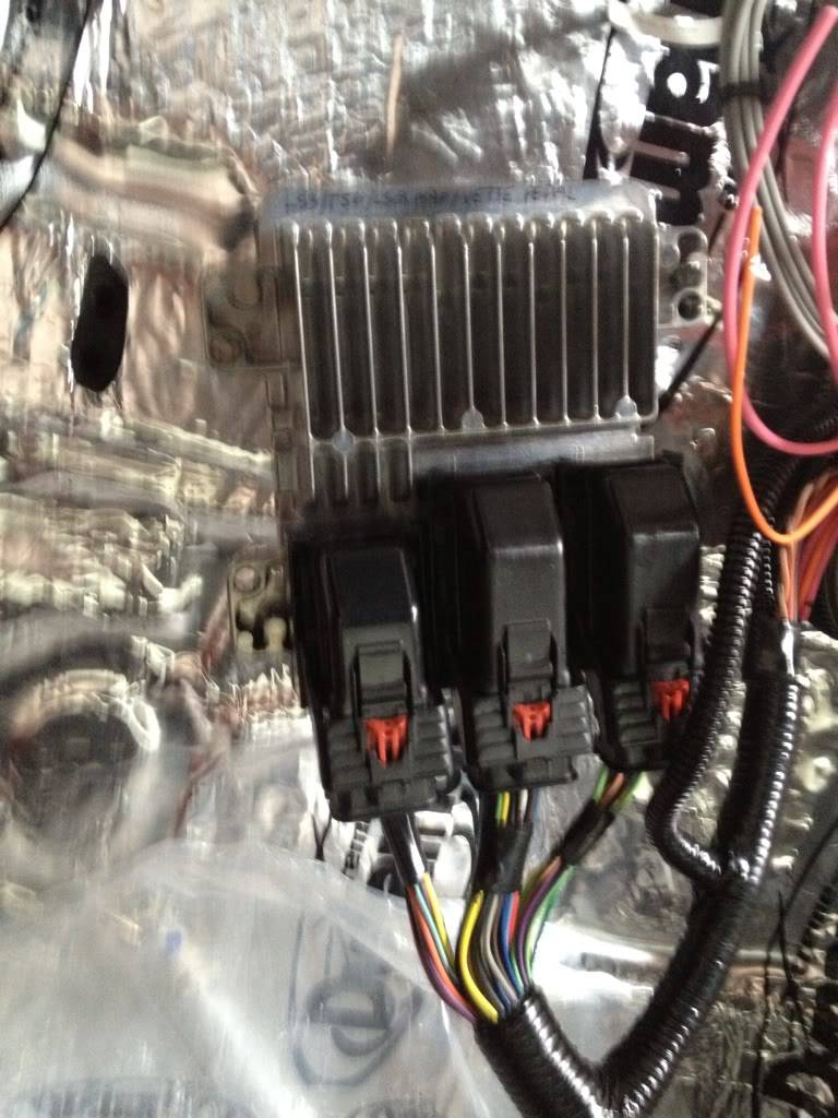

      Here is the ECM from Speartech.

      We should all do what we want, so I'm not knocking your wish. But with all the space in the fender area why would you want to sacrifice more interior room?
      Since you are running the vintage air you won't need the original heat blower motor our the vents for it. I found that dead space perfect for front speakers but it could hold your ECM as well.

      I bought a GM ECU bracket and mounted it above the glove box while the dash pad was off in my 69.

      The ecu just snaps into the bracket. I screwed one side of the bracket to the metal part of the dash which the pad covers. For the otherside, I made an L bracket and fastened it to the fire wall. I wish I had taken pictures, but I didn't. It's not too bad of a job to remove the ecu if needed.
