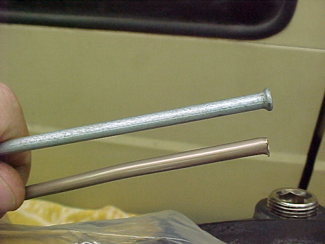

      Picked up some new brake line. Anyone else use this?
      I was picking up brake line fittings at my local auto parts store and he showed me this brake line from S.U.R.& R. It's a nickle plated line that bends very easily and won't rust. It is also made in the USA!
      http://fuelsender.com/brake_line.html
      Compared to the zinc coated line it is much nicer looking.

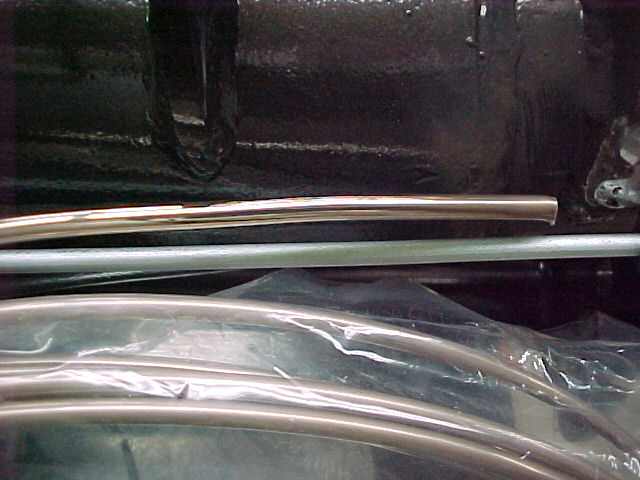

      Just for chits and grins I polished up a short section.... looks real nice.
      I haven't bent this other then to test it but it bends real nice. I'll give it a run and let you know how it works.

      Quote Originally Posted by astroracer View Post
      Sure its nickel plated or a Cu-Ni alloy aka Cunnifer or NiCopp? - Volvo and some others use it - NAPA carries it ~$2/ft. I ran it on my Nova along w/SS outer spring wrap to protect it. Its nice stuff. -Bob

      Quote Originally Posted by BBPanel View Post
      Thanks Bob,
      Maybe he did say nickel alloy... I got the 25' roll for 40 bucks with tax... It does say a few OEM's use it on their site.
      How did you like it? Did it bend and flair okay? It seems to be very easy to work with so I am hoping I made a good decision.
      Thanks Bob,
      .... How did you like it? Did it bend and flair okay? It seems to be very easy to work with so I am hoping I made a good decision.
      Mark
      As the others have said - best of both worlds. I did use a bender for the tighter radius bends and it double flared easily.

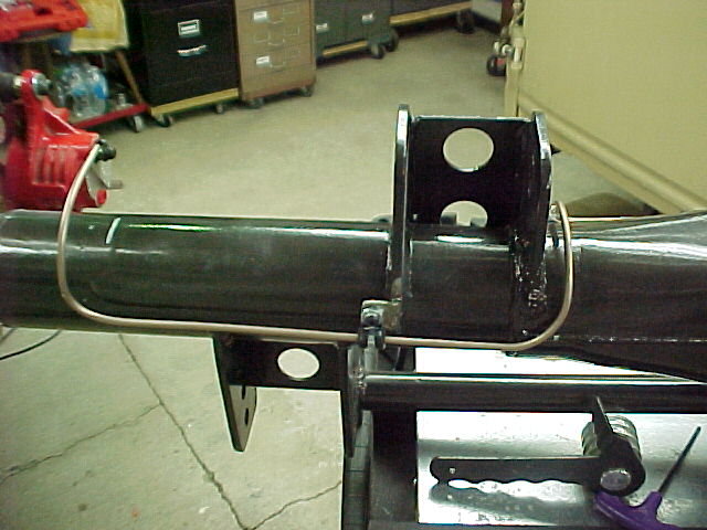

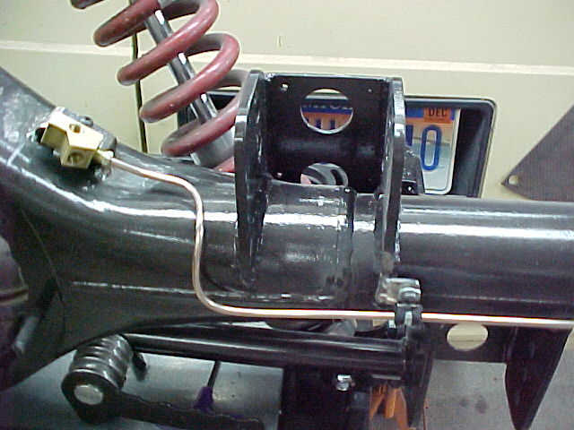

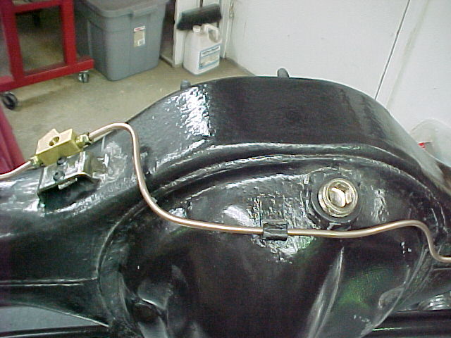

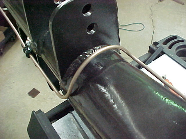

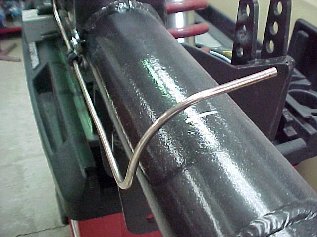

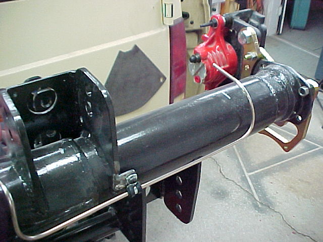

      Thanks Bob, much appreciated! I got out in the shop tonight for a couple of hours and all I can say is this stuff is great! It bends and flares very nicely and polishes up to a nice shine!
      I ran both lines on the rear diff tonight in a little over an hour. And that included polishing one of the pieces and doing a couple flares...
      Polished compared to the zinc plated stuff. I like.
      This is the drivers side going out from the junction block.
      The passenger side was a little more involved but I got it done without wasting any material!
      I will be making another bracket for the clamp you see in the middle of the picture.
      The line routes along the back of the housing until it gets to the upper four bar bracket. It then sweeps up over the tube to the front to get it away from the shock.
      I know it's a circuitous route but this was the only way I could see to do it cleanly.
      Both lines sweep back over the axle to the brackets for the soft line (use your imagination to "see" the brackets)
      I still have to sweeten up the lines and make a couple of mounting brackets but the hard part is done and it didn't take long at all...
      I posted this in my build thread so I'll continue it there.
      Thanks for all of your comments guys.
      Mark
