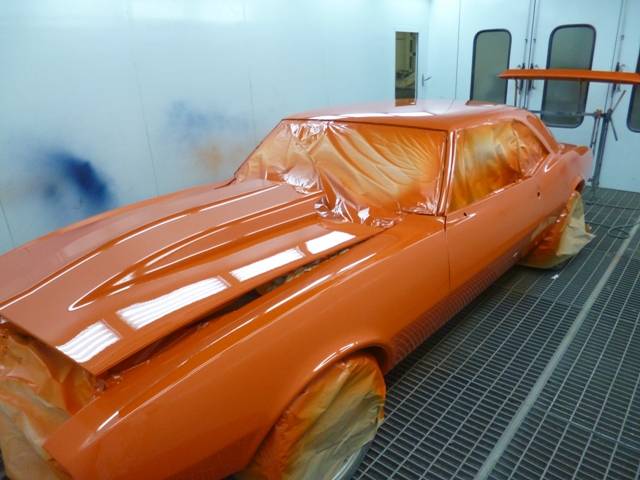

      This is a pic of the car from the paintshop...chrome deleted or blacked out, so looking mostly at black/smoke rims

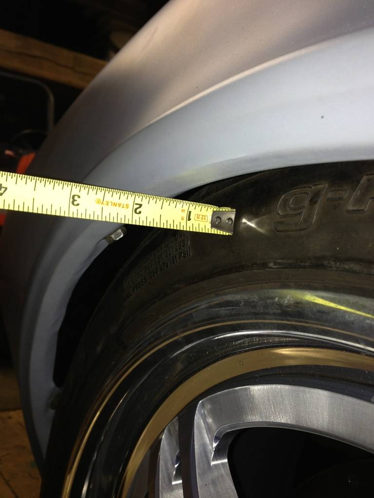

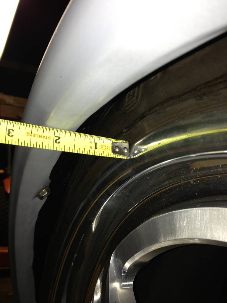

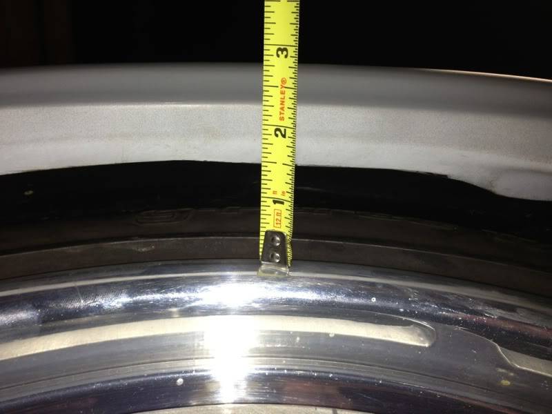

      Hey the paint looks awesome. I have ridetechs try-turn kit, front muscle bar and stock frame, uppers and lower (control arms are on order) and have done a lot of reading as I also wanted to nail the stance and have the wheels fit correctly. My situation is a bit different but we are after the same goal. After reading a 10" will not fit without a roll/pull and some metal work. In the pictures below I have a 18x9.5 (8" barrel/ 1.5" lip) but the backspacing is 7.10" so I needed to change my wheels with new lips and barrels. I read the majority of people running 9, 9.5, and 10" are using 5.5 - 5.75" of backspacing. So knowing that we went with 6.5 barrels and 3" lips. They are not here yet but even with them I may have to do a little roll. I would think a 9" would be a safe option and you can still fit your 275 up front.
      Here are some pictures of the front spacing to show you. Im on air so the the first picture is semi up which reads about 1.5" and the other two are dumped and reads about 2".
      Once I get the new lips if I can remember Ill grad some new pictures..good luck.
