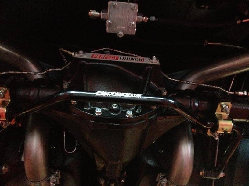

      I'm doing the same swap in my '67 Camaro. Right now I have a Holly Black fuel pump above my axle, but will be going with an in tank pump for the LS. I was planning on putting the new regulator in place of the old fuel pump.
      Here's a couple shots of how/where my old pump was mounted, not the best pics, but it'll give you an idea:

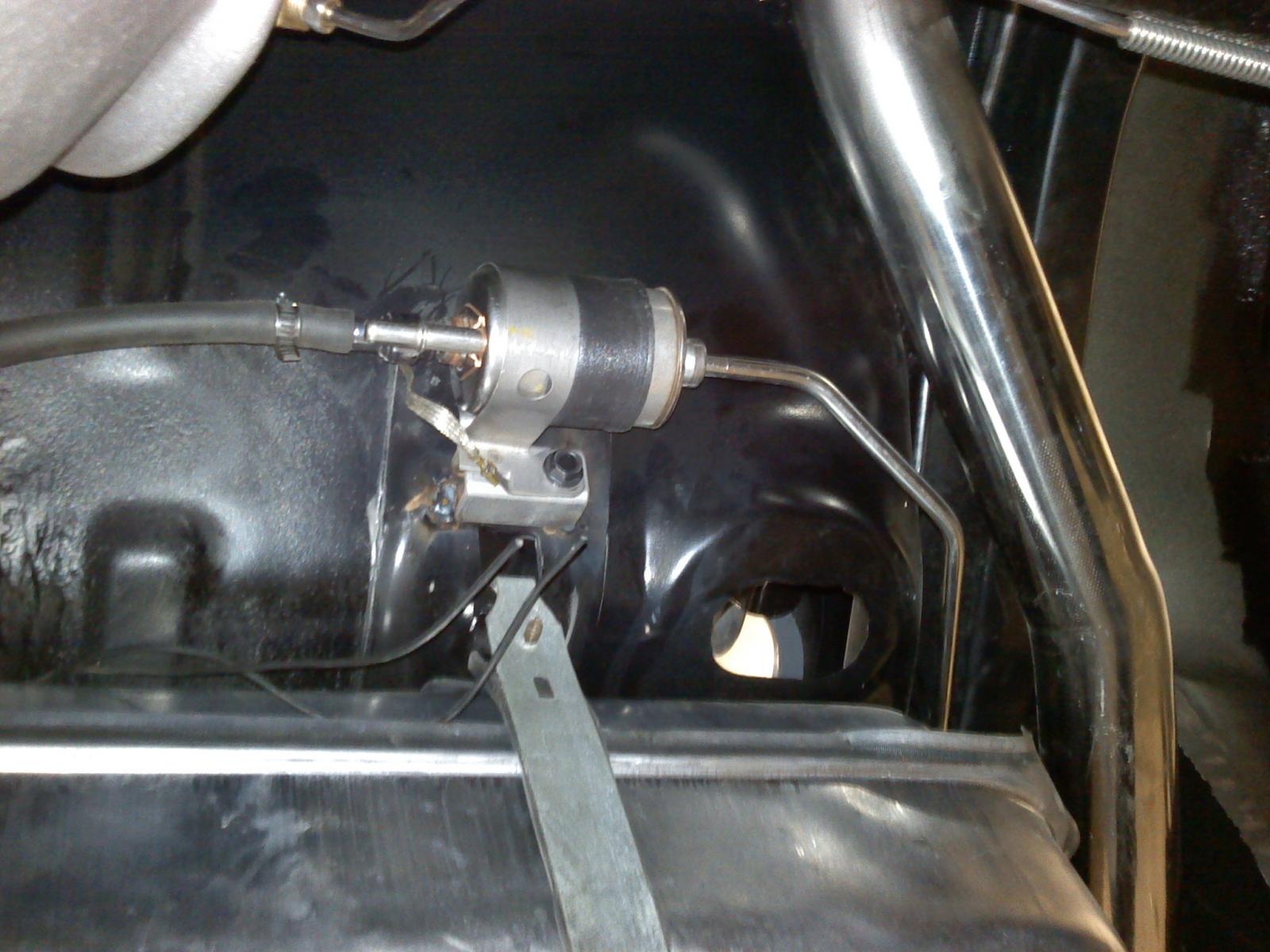

      I welded a 1"x1" 1/8" wall piece of steel tubing To the drivers side gas tank mount, and tapped it for the screw. The picture is just mock up mode, I used fuel injection clamps.
