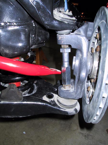

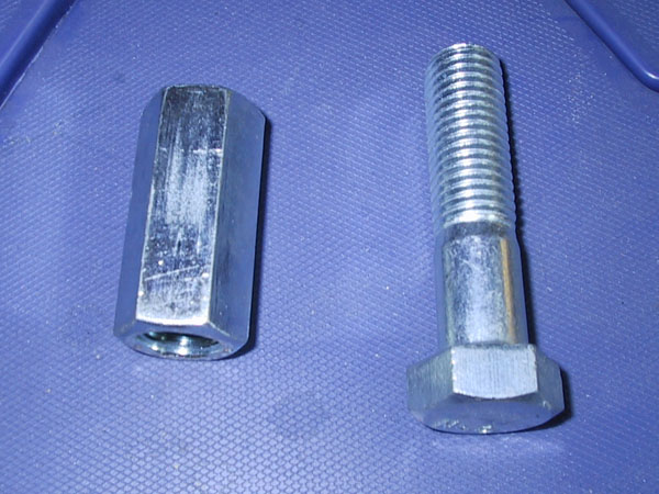

      My recommendation would be to install a safety chain, load some weight on the frame, put a jack under the LCA, then disconnect the LCA from the lower ball stud. If the castle nut is loose, but it hasn't popped, then leave the castle nut loose (but still enough on the bolt to hold once it does pop). Go down to your local hardware store and pick up these:
      Install between the 2 ball joints and turn the nut until it pops...like this:
      Then of course, just CAREFULLY remove the castle nut using the jack to keep the LCA in place.
      Good luck and be careful!
