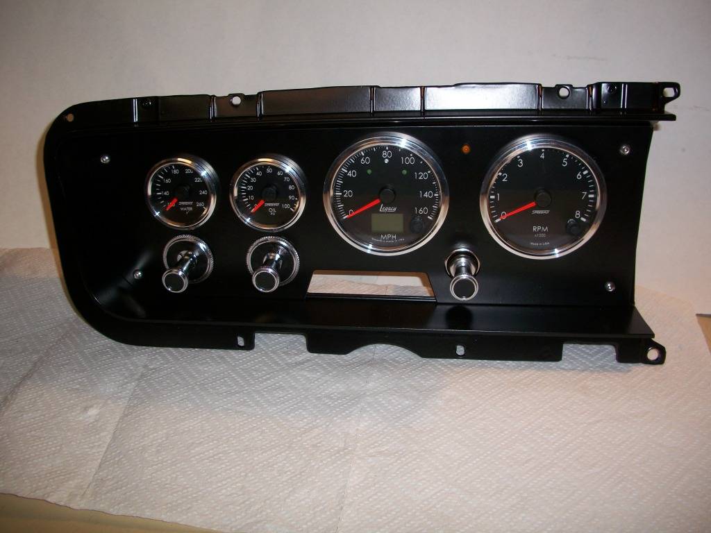

      I don't know if this will be of any help to you. These are of my 1965 Buick Skylark gauge panels. The flat panel the gauges are in is .125" aluminum. The gauges are by Speedhut. The one that goes on the right is still under construction and is not powder coated yet. Hopefully it will give you some ideas regarding the Speedhut guages.
      Left hand panel
      Right hand panel

      Nice work. I was considering the Legacy gauges, but they didn't have a rev warning feature. I want to have the gauges inset into the dash like the factory units. That is the hope, anyway.
