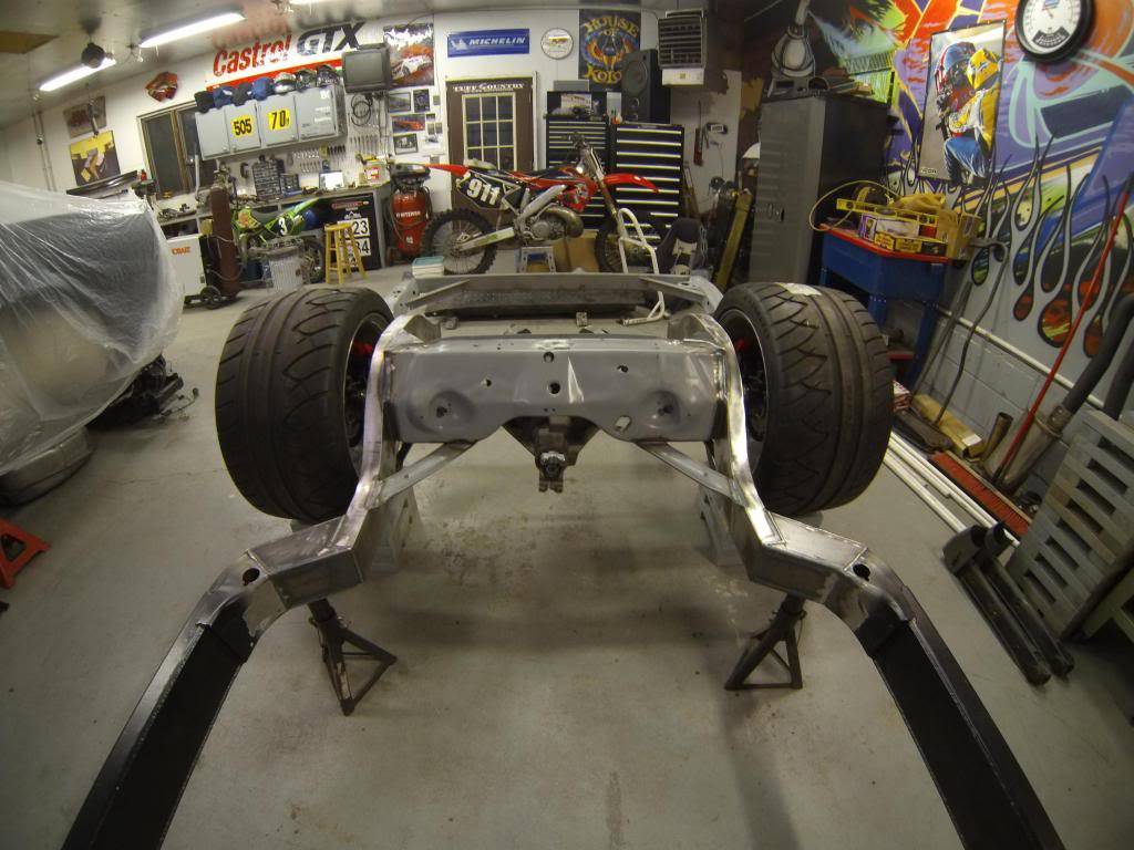

      Name:  New Frame inside weld.jpg
Size:  268.8 KBName:  New Frame boxing rear.jpg

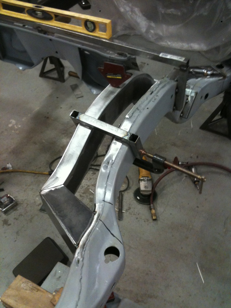

      Name:  New frame top corner.jpg

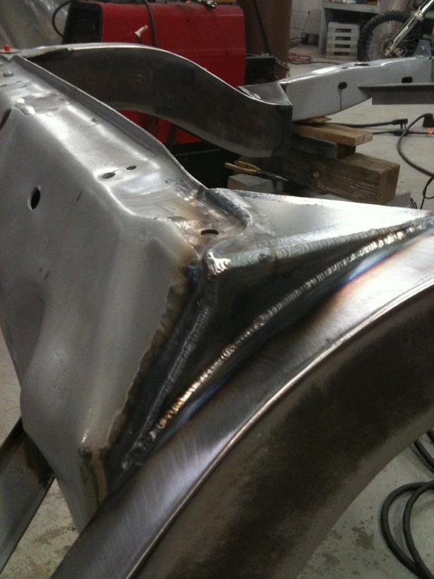

      Nice fab work and build.

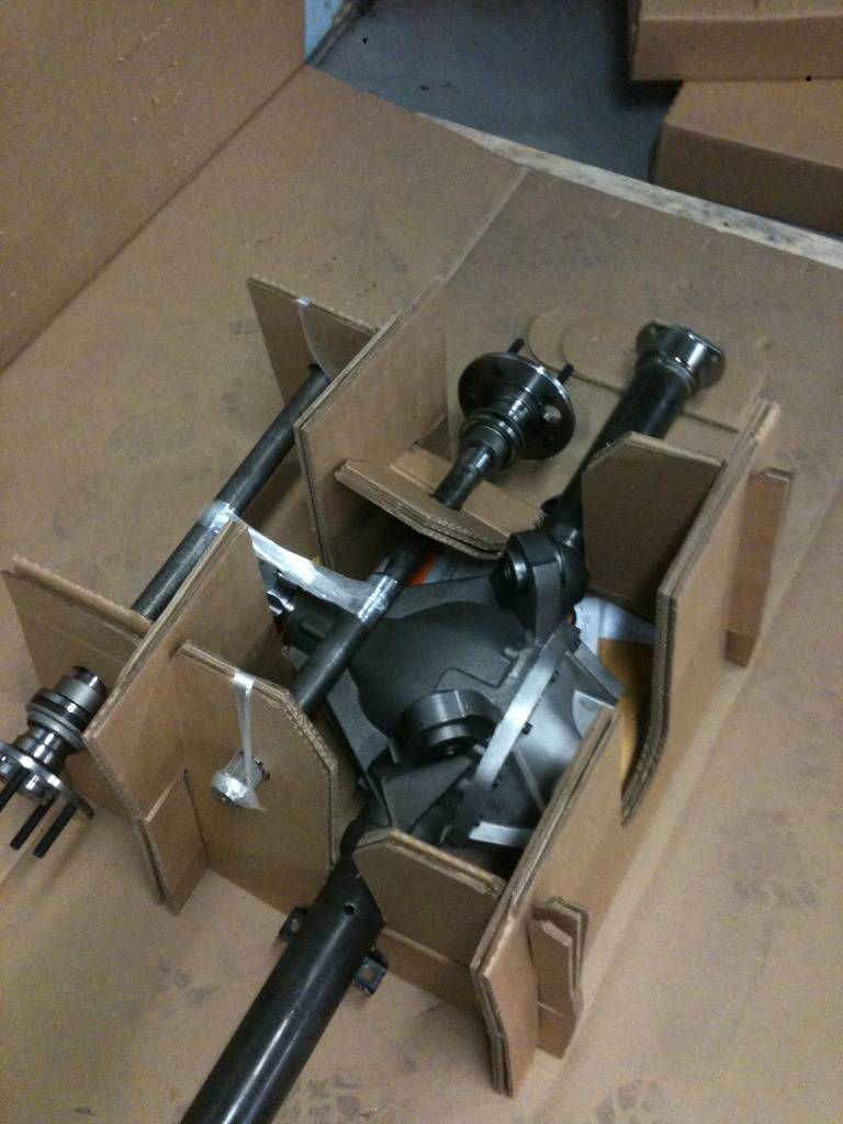

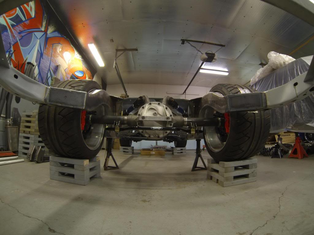

      Well, I changed my mind about 10 times on which rear axle to go with but I finally decided on a Moser 12-bolt with 33 spline axles, Detroit Trutrac, and 3.42 gear. I almost bought a Currie 9" but I wasnt impressed with their sales/tech people when I called them. Currie acted like I was bugging them when I called with a few questions. Moser on the other hand, was very helpful and seemed to know exactly what I was asking for in every way. Plus the 12 bolt just looks right in a GM.
      Justin Snow
    10. #90
      Sep 2007
      York, Pa
      457

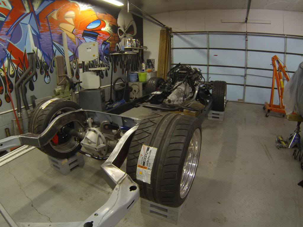

      I did some very basic mock-up with some of the new rear suspension. Upper control arms bolt rite in like factory but nothing is there for the lower arms yet. I will need to build the lower control arms and frame mounts. Also my new DSE sway bar is hitting the new frame rails so I need to do some brain storming there.

      Love the build! GN's have always been a favorite of mine. Might be worth making a call to Moser to make sure they didn't send you the housing that has the raised upper control arm mounts. Not positive they offer that for G-bodies but I know they do for A-bodies. The raised mounts help for drag racing but are not good for handling.

      They never mentioned an option for raised upper mounts. Now that you mention it I have seen an A-body 12 bolt with really high mounting points but I dont think mine are that high. I thought about making a few different adjustment settings where the upper arms bolt into the frame by making three different hole positions.

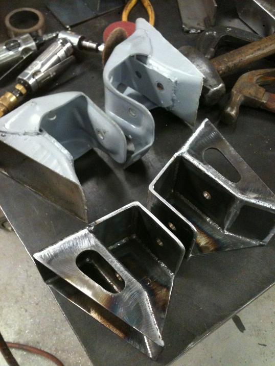

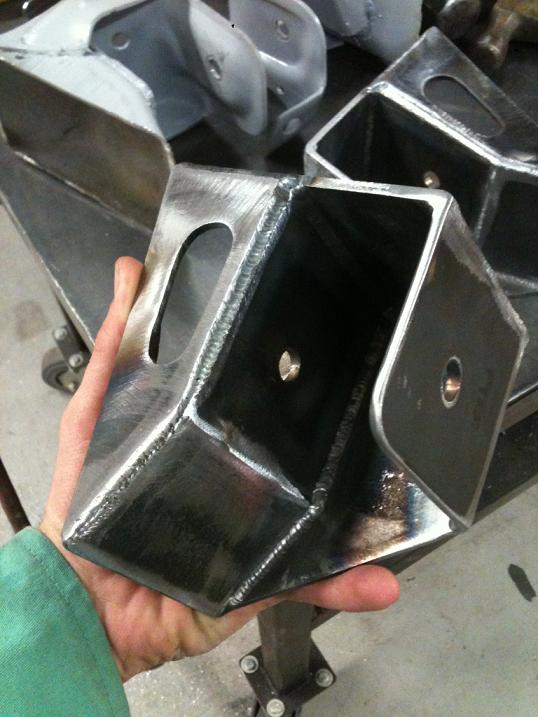

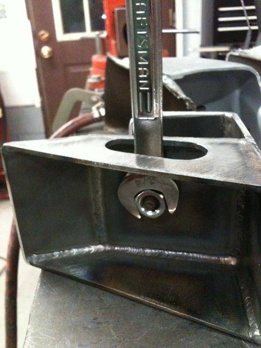

      I spent a full day building new lower control arm mount for the frame. Again, I just went off the stock design and just tried to beef them up a bit.Name:  LCA mount hand.jpg
Size:  54.7 KBName:  LCA all 4.jpg
      Justin Snow
    15. #95
      Sep 2007
      York, Pa
      457
      I made them with a little access hole in the bottom to fit a wrench. This way I dont have to drill through the side of the frame and use long extensions like the factory did.

      Here's a comparison of the factory welds on the control arm brackets I cut off compared with the new welds on the brackets I just made. ..Shame on you GM!!
      Justin Snow
