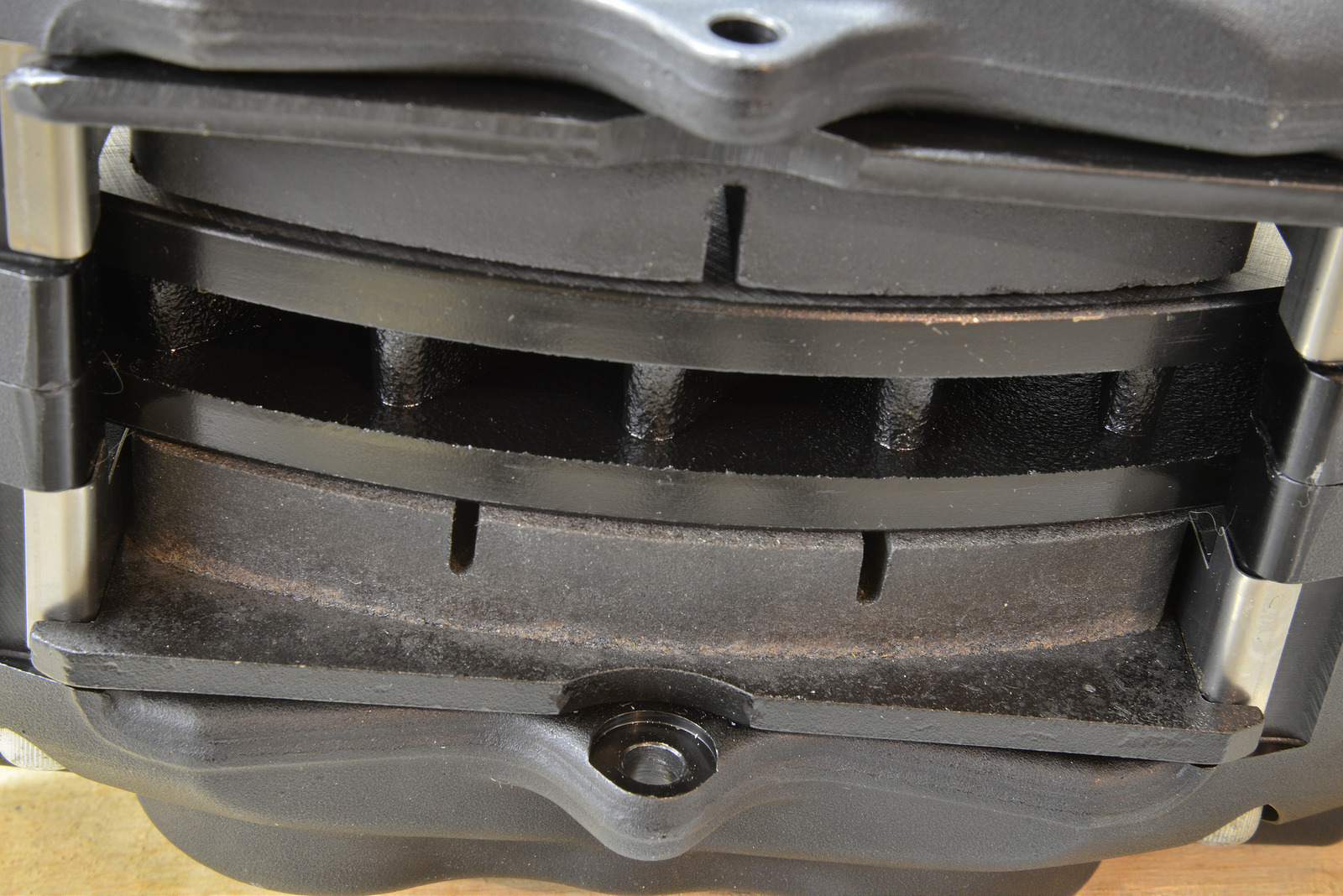

      Everything went together quite nicely once all of the correct parts were on hand.... Needed to have the rotor hats drilled out to fit the base of the studs (https://www.pro-touring.com/showthre...r-Larger-Studs) but otherwise, a nice install.

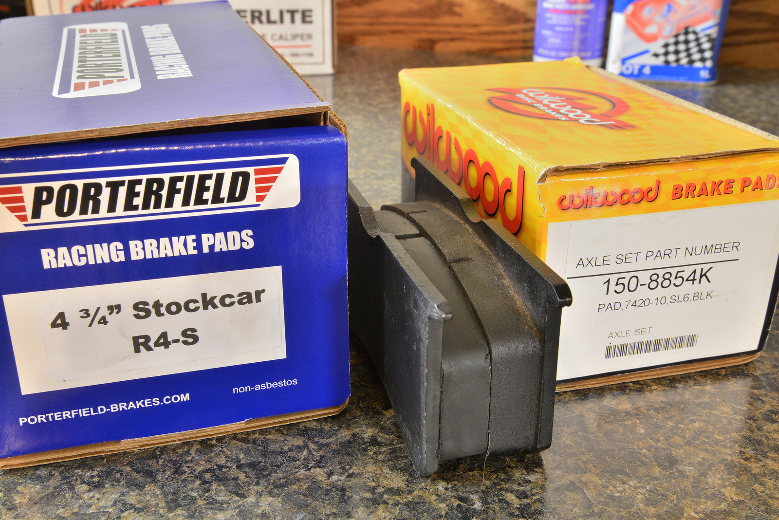

      Unfortunately it looks like you have the standard Wilwood 7420 pad issue. The pads looks to be sticking up beyond the edge of the rotor by about 1/16". Rest assured its not your bracket, its the pads. For some reason Wilwood adheres the friction material to high on the backing plate. It you get pads from Porterfield or Hawk, you will not have that issue. Probably others as well.

      Very interesting, I hadn't really noticed before. I think that the picture makes it look more pronounced than it is but I'll have to go back and take a closer look now...

      Please do. And pictures for reference. Right click - view image for a larger version.
      Porterfield top, Wilwood bottom.
