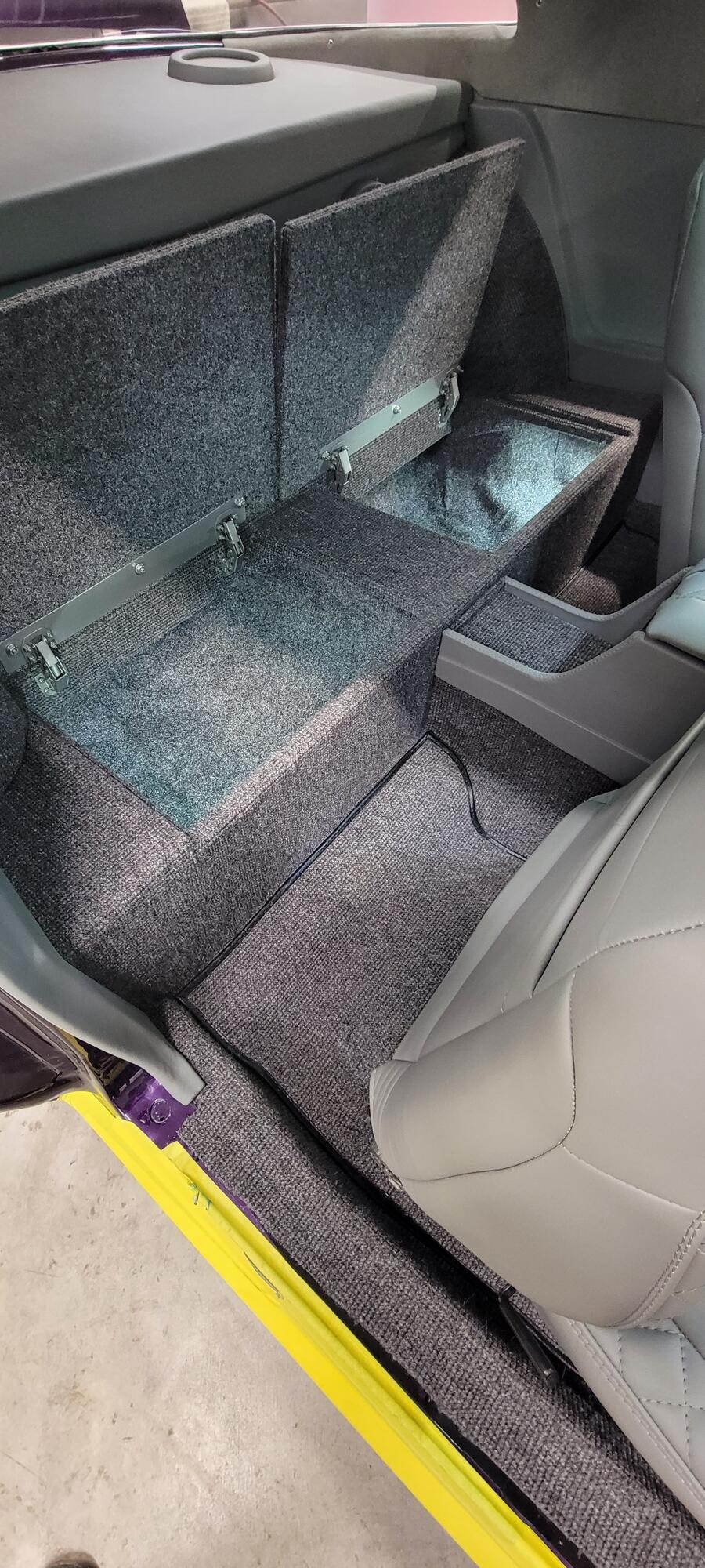

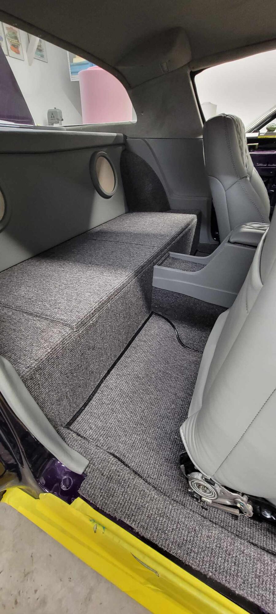

      I'm thinking deleting my rear seat too and just running the carpet back to the very rear of the floor and maybe even up panel where the rear of the seat used to be. And I am doing it for weight savings. I have a rear trunk mount battery set up so I'm not worried about the "car is already nose heavy" issue.
