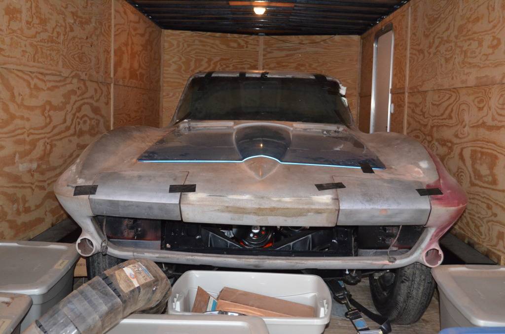

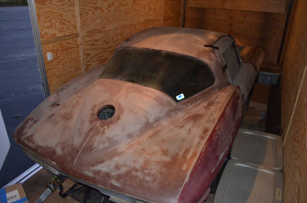

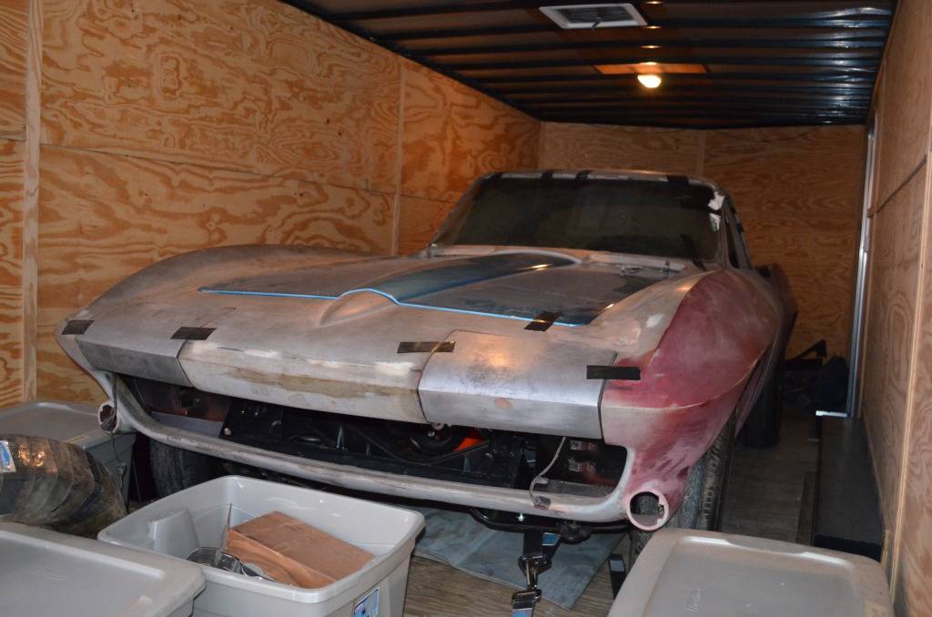

      Here is my current build. I bought the car in early July and the paint shop started on the car in mid September. I have been busy selling off the majority of the original parts and reconditioning the others that are needed
      Details:
      -1966 Coupe that was originally a 327/300hp powerglide car with power windows, power brakes, power steering, and air conditioning.
      -Chassis, drivetrain, and wheels: The new frame will be from Street Shop and will have C6 Suspension with independent rear suspension, 18"-20" foose legend wheels with 315 rear tires, LS3 crate engine, tremec tko 600 5 speed.
      -Exterior: Color is to be decided, but i am leaning towards a very dark blue with a metallic grayish silver stinger. The body will stay stock with the exception of the 67 BB hood and 64 fuel injection emblems. At this point I am planning on running side exhaust, but that could change.
      -Interior: Autometer custom gauges, 64 carpet(b/c i like the way it looks with the vinyl lacing, it fits better in the rear compartment and will be easier to adjust to the new rear floor design), upgrade to vintage AC, 2011 black leather power seats.
      Anyway, here are some photos. I will upload more once will pull the body next week. The fully restored chassis with engine and trans will be going up for sale immediately after will pull the body.
