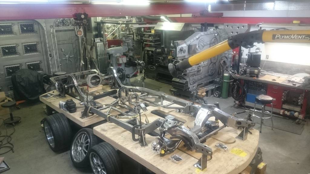

      finally getting some time working on the car instead of the shop the new plan is to design and fabricate a watts link and a torque arm rear suspension still on the fence about running airbags I might just go with coilovers instead .also moving the motor back a few inches and the front suspension up to bring the crossmember and suspension up in the front.

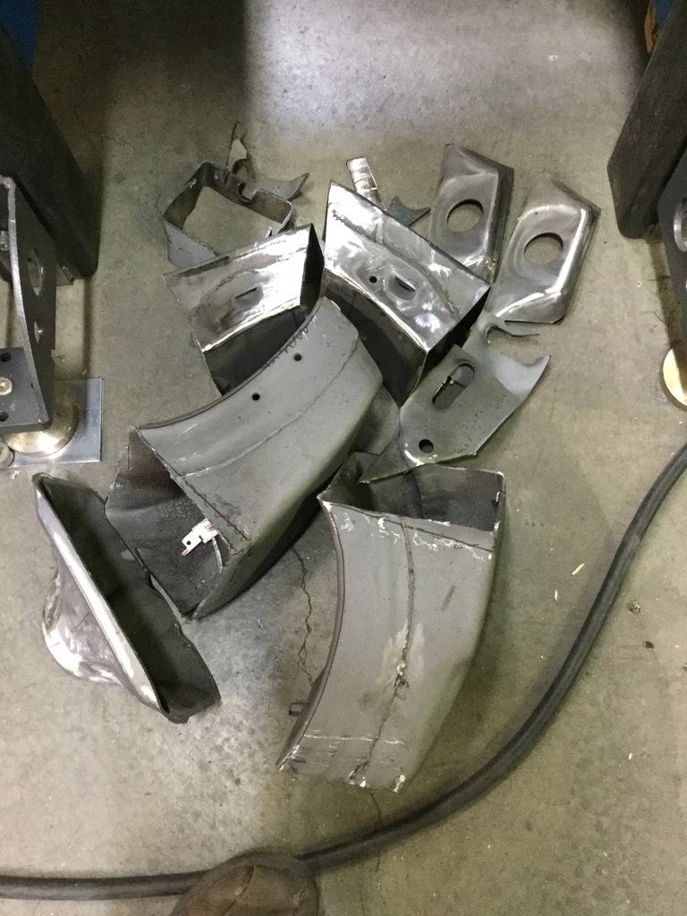

      finally getting back on track with more cutting and chopping! I used to tell myself that a custom chassis is way to expensive! I now know the pain and agony of how time consuming it can be! not much left of the original frame left now!

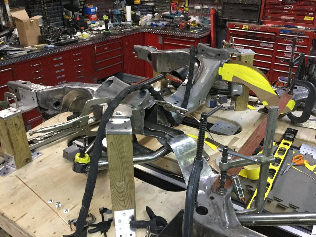

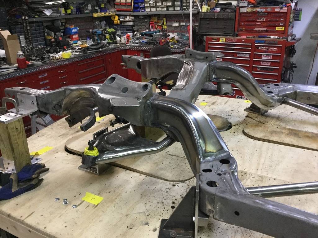

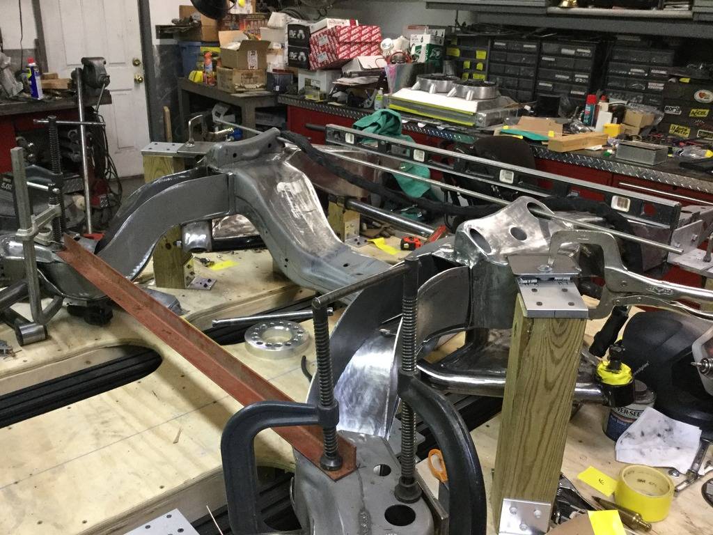

      finally making some progress with the Chevelle frame this had proved to be quite a challenge the frame transitions are tapered ,twisted with offsets and elevation changes at the same time . there is over 55 ft of welding involved in these two pieces! and now the frame is one again!
