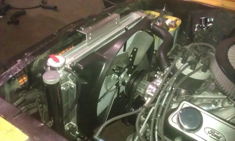

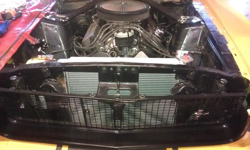

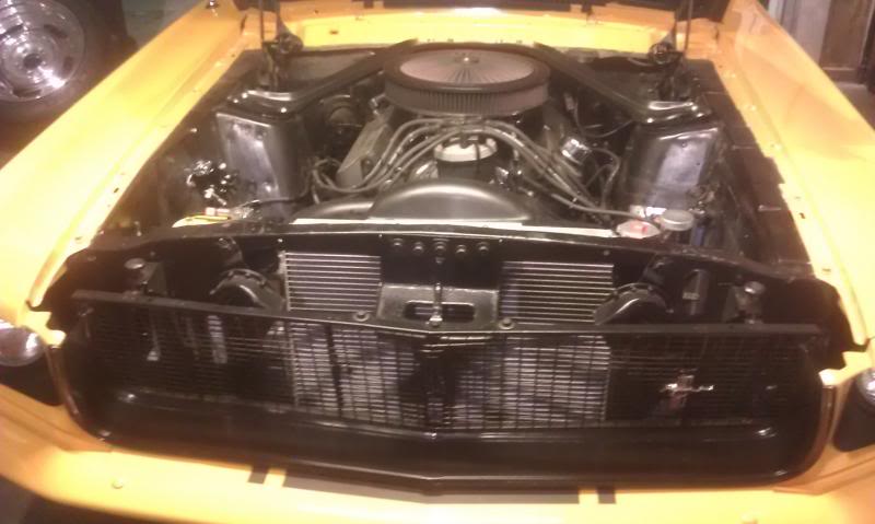

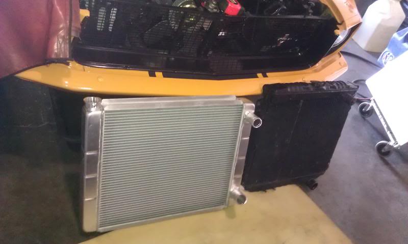

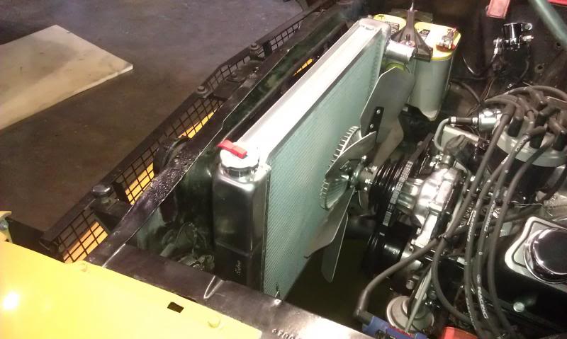

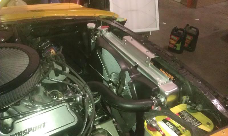

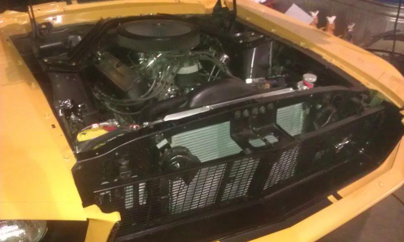

      ...Here's how my day went. The original radiator sprung a leak so I found a cheap aluminum alternative. Took all day to do it all right, NOT a direct bolt-in by any means. I had to hand-make brackets for everything, shroud included.

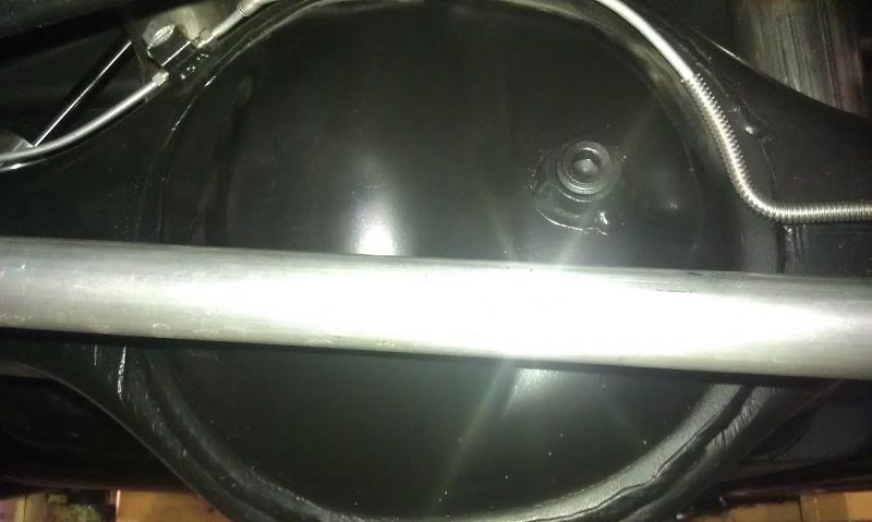

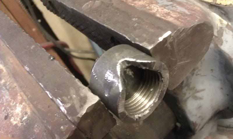

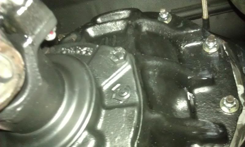

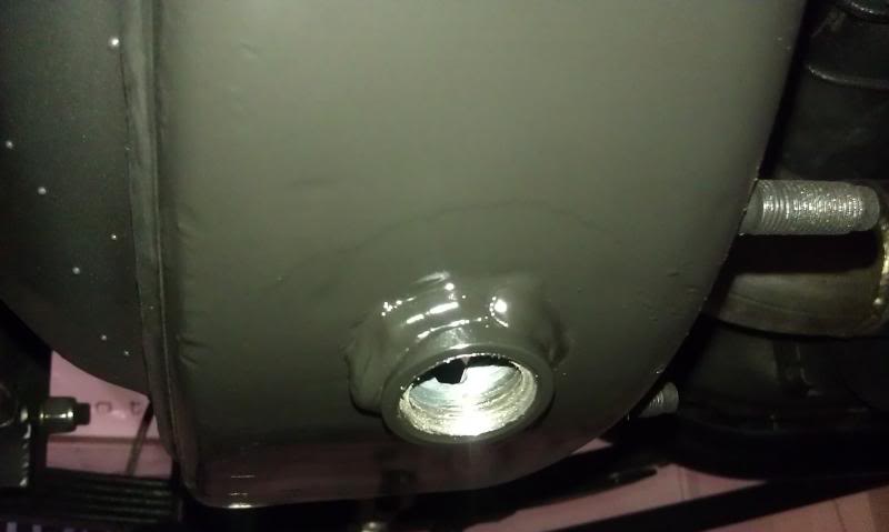

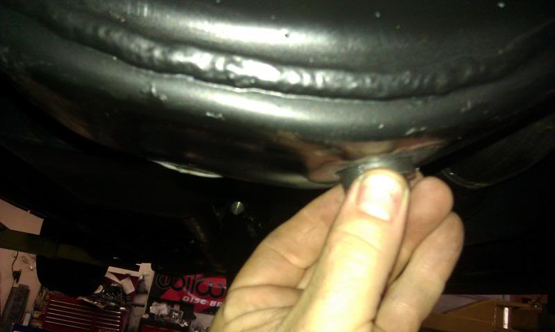

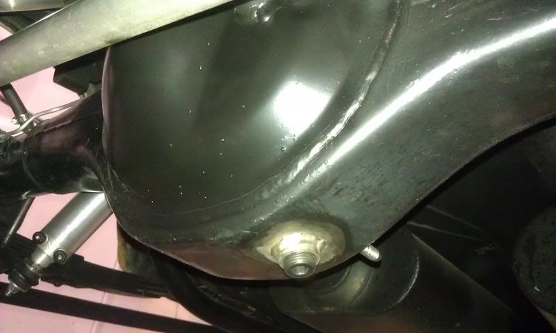

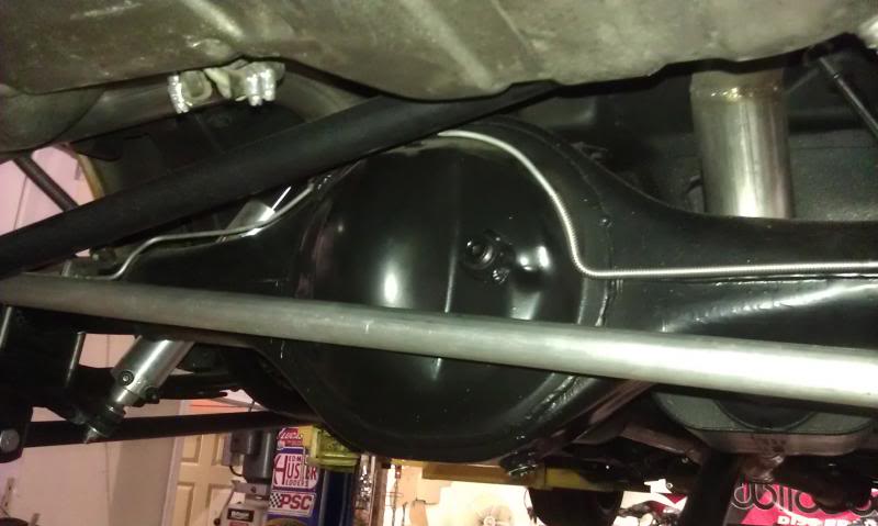

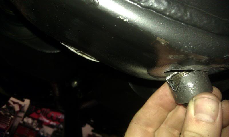

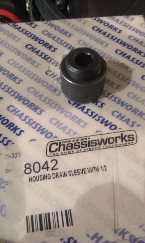

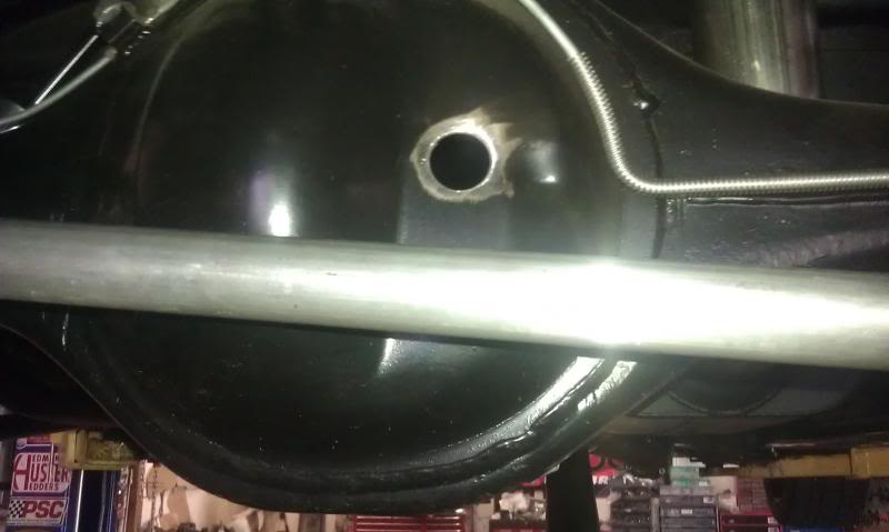

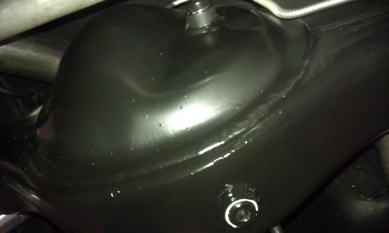

      Swapped out my 4.11 gears today for 3.70's that have been fitted into a nodular case. I also welded in drain and fill bungs to my 9" housing.
      ...Going to countersink the drain plug for a little extra ground clearance.
      ...Decided to cut a drain passage into the recessed/countersunk area of the plug for better draining.
