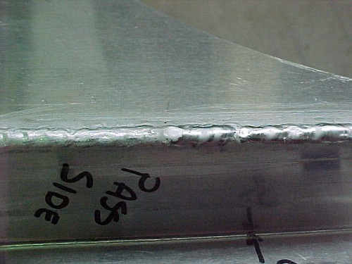

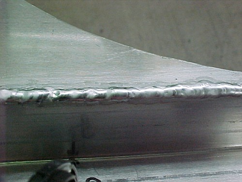

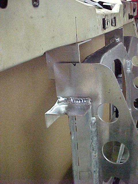

      Here are a couple of welds I did today on my radiator shroud for the van. I was using a 1/16 pure tungsten electrode, a gas lens with a #8 cup and had the max amperage set at 90 with the foot control running at about 75%. I set the pulse at 1 per second and had the frequency set to "AUTO".
      i still have a long way to go and fillet welds still kick my ass...

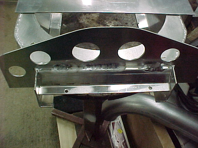

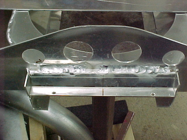

      Here are some I did on my trans cooler shroud.
      These are not pretty but they are strong. I was running the same settings on the machine when I did these. I really had to work to keep the verticle plate from keyholing as I brought everything up to temp. What is the secret to getting the flat plate and verticle plate up to "puddle" temp without blowing through the "on edge" piece?

      Those welds look pretty decent giving the amount of experience you said you have... I assume you are using 4043 filler.. try some 5356..... I cheat when welding stuff like that... I have prob 20-30 pieces of 1x1 and 2x2 90 deg steel in different lengths as well as several pairs of c clamp vice grips that I use to not only keep the parts square but it soaks up a lot of heat and I never blow through... I can weld without them and sometimes situations dont allow their use... but i take the extra second.....

      Thanks Harley,
      I did have the radiator shroud parts clamped to a 2 x 2 stick of steel tubing, directly behind the weld joint. You are right, that helped a lot. I will try doing that with the trans shroud. Didn't even think about it, thanks
      Another piece of info I picked up tonight was to increase the frequency when doing fillet welds. Focuses the arc better and makes a tighter heat zone. I'll be working on that in the morning.

      Sorry I left out one last thing, you mentioned the blow through you are getting when you bring your plates up to temp. There are a few thing you can do, pre-heating the tungsten on a seperate piece of AL, Spotting both plates seperately at the to be welded area, or with the foot pedal and patience bringing the arc heat up slowly and then bridging across the two plates. Just keep at it, it will come with time!

      Dont use your pulse control at first, get used to running beads without it. The skill you will develop without the pulse will greatly aid you when you finally get to the point you want to be at and run pulse. If you really want to use pulse a no **** trick I was tought was to find a song that has beat that will match the PPS (pulses per second) you set it at and stick to it. The rythm of the song will help with the co-ordination of diping the rod in the puddle at the correct time. As far as adjusting the frequency, when you adjust the frequency you are just changing the negative or positive side of the AC. The negative side and positive side of the AC band affect the cleaning action (negative) or penetration (positive) of the arc during the welding process. Something else to consider is to reverse your amperage setup. When you determine a good working amperage, set the amperage on your welder and let your foot pedal be just an on and off switch. Some people like it some people dont. It just helps you to concentrate on the puddle more. Try welding on different types and tempers of AL 6061 T6 is a great learing tool to start with. The alloy content of differernt types changes the weldability and can make life hell given the wrong type.
      -Last tip in regard to your post a little tip that alot of people dont think about. never NEVER clean your weld area with a steel, or stainless steel brush. It can actually contaminate your weld area. use a green or red scotchbrite pad. Anyother questions feel free man! and remember PRACTICE PRACTICE PRACTICE

      Mark I will agree with some of what you have done and been suggested to you. Here is my two cents from what I was taught in trade school and being a fabricator. With a 1/16" "green" tungsten a cup size of no bigger then 3/8" set your machine to 60-80amps account,of course your gas is argon.....I prefer to set the pedel so that I can go "full throttle"...it's easier to just lift your foot then realize you've accidentally pushed it down farther then you need. The filler wire should be 1/16" . Try putting your hoses over your shoulder I found it made moving my hand easier when I didn't have to move the weight of them with my wrist. You can use a s.s brush to clean your material but make sure it's never been on carbon steel. The "clear coat" aluminum oxide layer can be burnt thru but you'll find the alum.will heat up quicker and produce nicer welds with it ground off either brushed,scotch bright etc. Hell if the metal has oil on it try oven cleaner . The cleaner the better with aluminum. As much as you want the stack of dimes look remember Nobody will really see the welds when the truck is done so for now concentrate on good welds then after some experience you can move to producing better looking welds. Just cause a weld is pretty doesn't mean it's strong and vice versa. Oh another thing your tungsten needs to have a balled end you can do this by sharpening the tungsten a point (using a bench grinder with either a new wheel or use the side of a used one grind into the length of the tungsten not 90deg.to it...the reason for this is there will be microscopic grooves in the tungsten which need to be online with the tip not 90 deg.to it as that will change the characteristics of the arc). The balled end needs to be 1 1/2 times the size of the tungsten so in your case 3/32 to make the ball switch the welder to dc electrode positive full amperage and bring the tungsten about a 1/8"from a piece of scrap mild steel step on the pedal you'll be able to see the ball form.lift off the pedal and don't move till the gas stops flowing. This will cool the tungsten as well as shield it while it solidifies. Finally go out and buy miller weldings weld calculators about ten bucks there is three to the set...stick...mig...tig..they are paper slide rules and have lots of info for setting up your machine amps...volts...gas...etc

      Are you sure you are using a weldable series of Al?....Like I mentioned earlier some Al types are WORTHLESS to weld. That is why you may have a puddle going on one piece and the other is giving you crap. Are you letting the puddle develop before you try to add the filler? I know its a pretty simple question but I have seen it done before. Hopefully Jesse can save the day!

      My personal,firsthand opinion is balling the tungsten is a waste of time, especially when welding sheet metal. Pure will ball with usage, 2% will tend to stay sharp. With a smaller ball or pointed tip, your heat will stay focused where your welding. Helping keep warpage to a minimum.
      The trick to making "dimes" is filler wire feed. You can feed it fast for a closer stack or slower for a spread out look. Play with travel speed and filler feed rate until you're happy with the look!

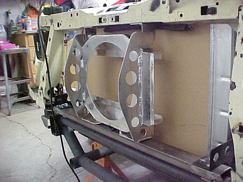

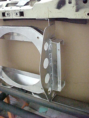

      I spent this evening getting the shroud placement figured out, bending the upper brackets and getting those mounted.

      Mark, that's a pretty damn nice piece!

      Thank You Sir! It is now that the welding is done... Jesse went over a few of my "welds" and cleaned them up a bit. I think I did okay when I welded the main assembly. The fillet welds kicked my ass but i think I have it figured out now. We'll see tonight.

      I too suggest you using 2% thoriated red tungsten when welding anything .090 and below...grind tip to a crayon point and it shouldnt ball up its not what your looking for when welding sheetmetal.There are a lot of theories behind what material to clean material with and in which direction you just have to find what works for you.There are many variables when it comes to welding AL.

      x3. The green tungsten and a balled end was the way to go with a sine wave AC machine, but with modern square AC machines the pointed thoriated tungsten will give you better accuracy and better looking welds.
