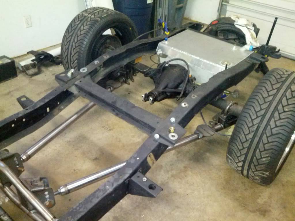

      Below are a few pics of where it sits now, to give an idea of what I'm working with. As of right now, I'm planning to go outboard of the frame, behind the axle, and fabricate an adjustable mounting setup of the rear of the trailing arms.
      Thoughts??
