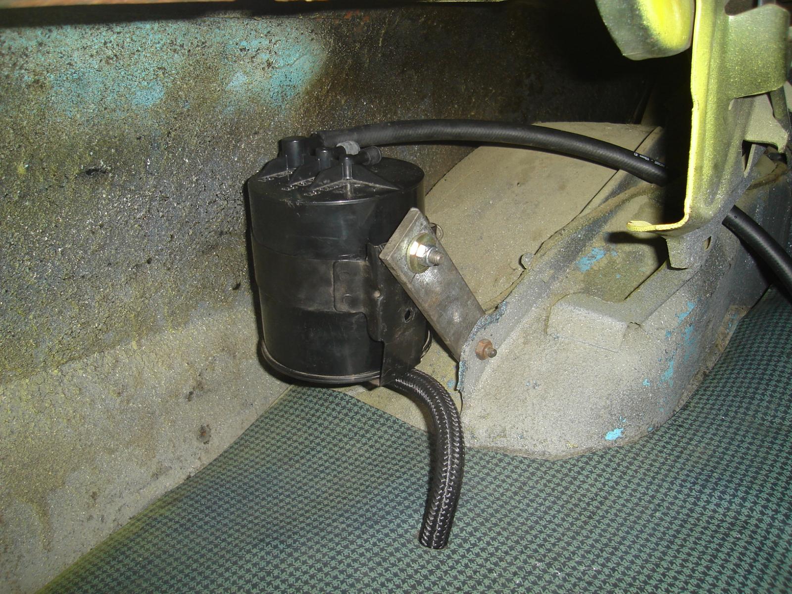

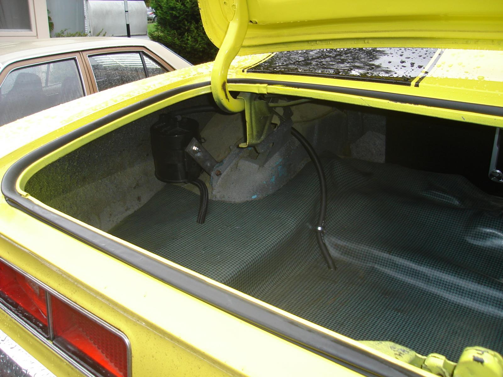

      I mounted a charcaol canister in my boot with no problems and it only cost $10

      heres a pic of my setup. I raced the car at Sandown raceway today with no issues.
