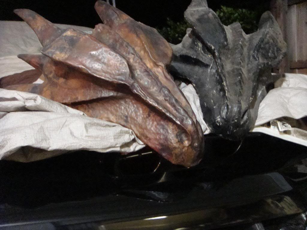

      Nobody fully mentioned it yet, but one of the first things you will learn with your welding projects is that proper fabrication skills are just as important to achieve proper welds. Here is one of my old projects as an example, A copper dragon head hammerformed in sections over a wood form I carved, then welded together. Do something like that just for fun & your other projects will seem easier.
