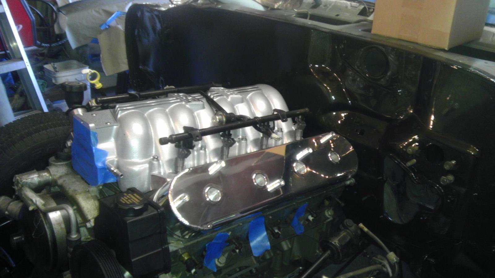

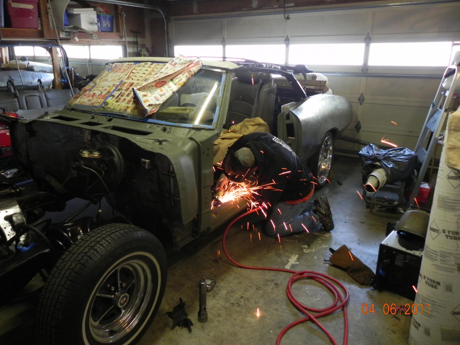

      This is where the project started, I was only supposed to change the motor! When ever I tried to clean up one thing it led to cleaning up the next thing!

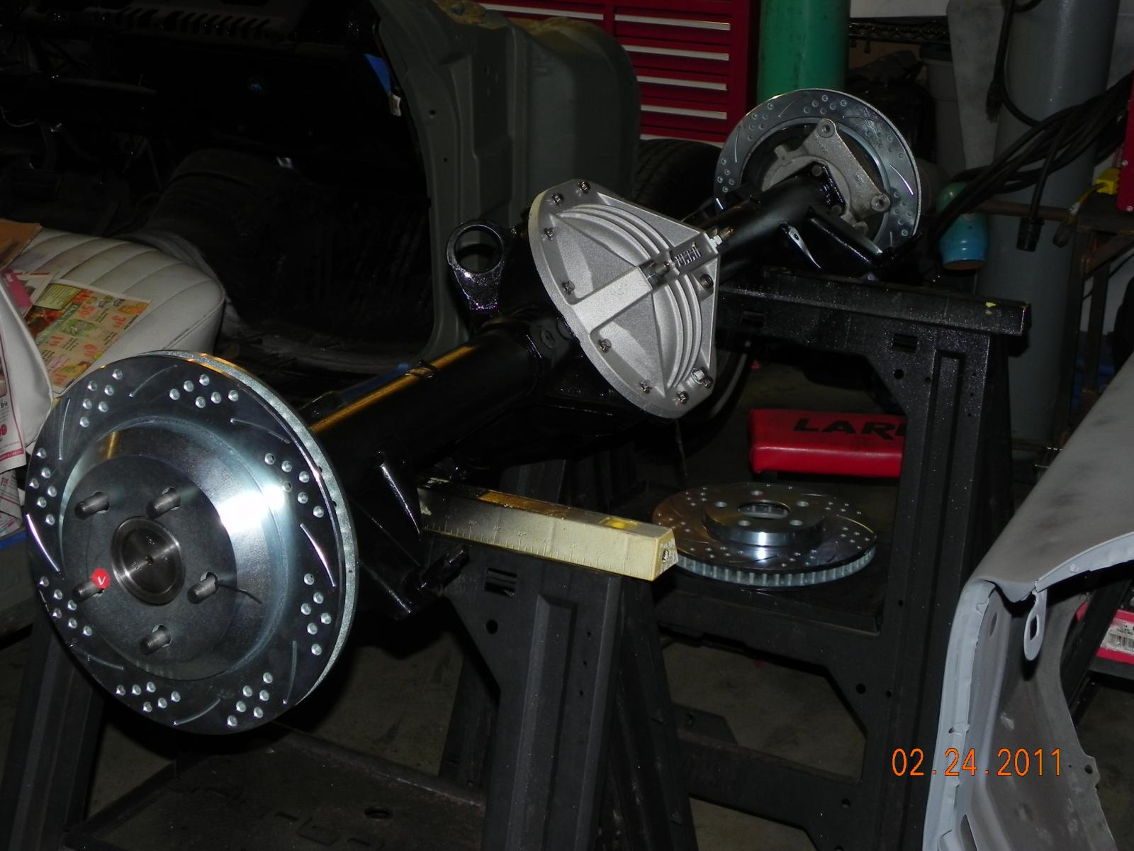

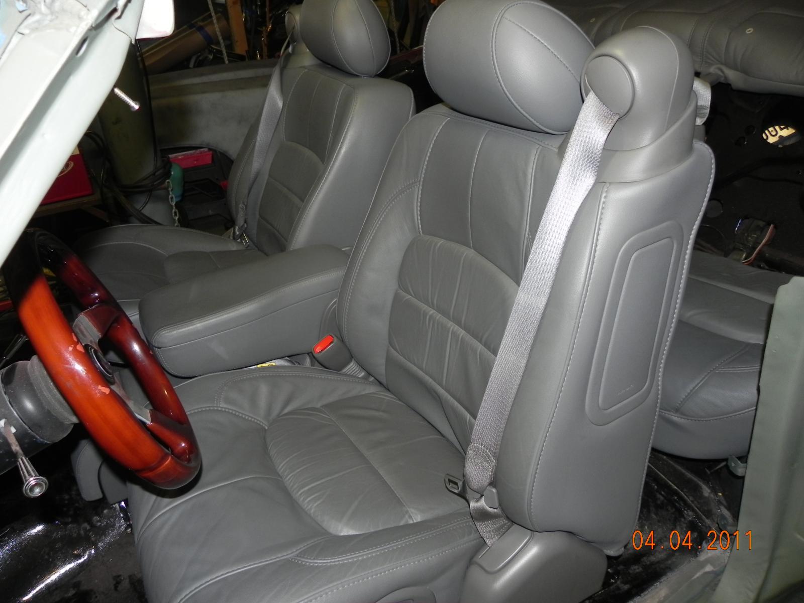

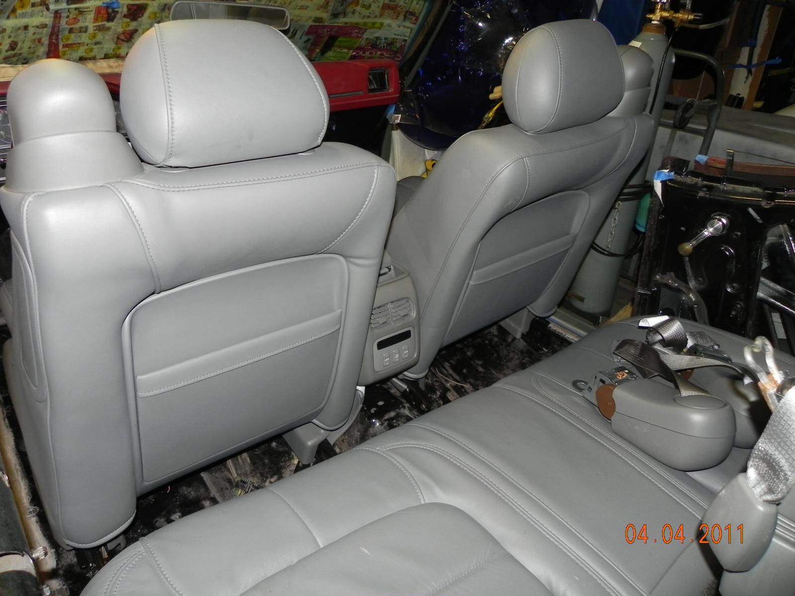

      Freshly built rear end,new axles,bearings,seals and Eaton posi with 3:73 gears. Test fitting seats in these pics. Me and my friend Bryan trying to figure out how to get seats to sit lower. Ended up changing the shape of the floor boards to get them lower, also backed each bolt with a wide based 3/16" steel plate and now is secured with 1/2" bolts. I figured with these heavy seats better to over build than under.

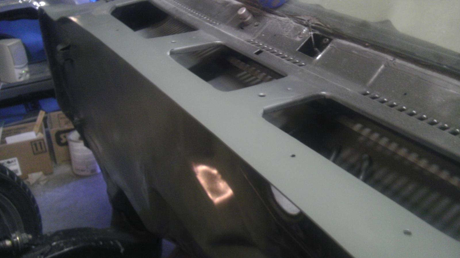

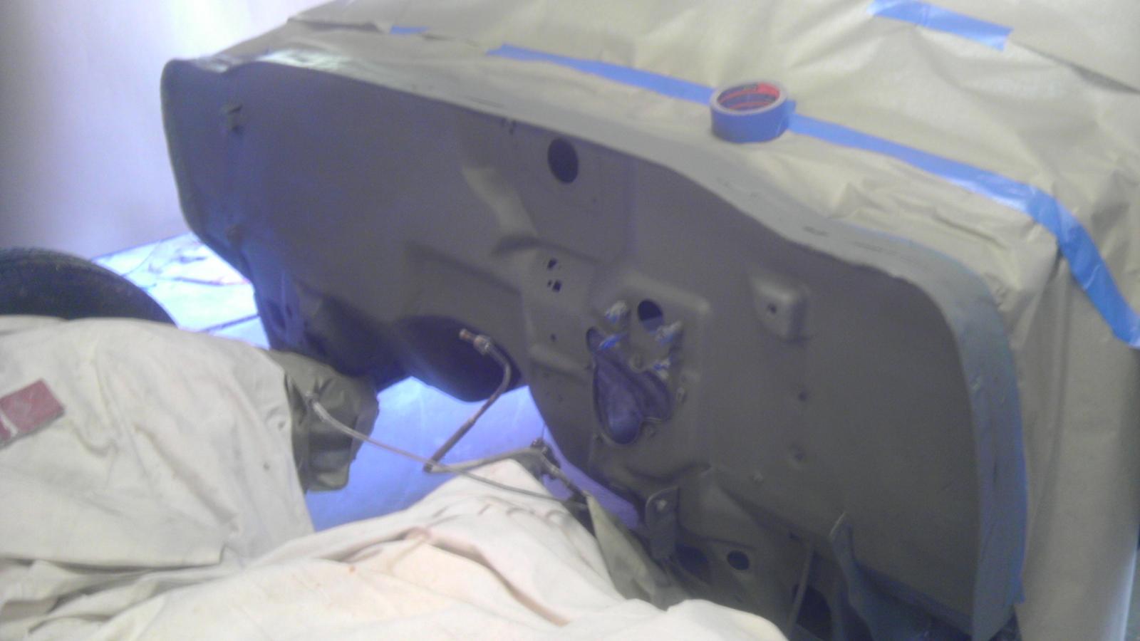

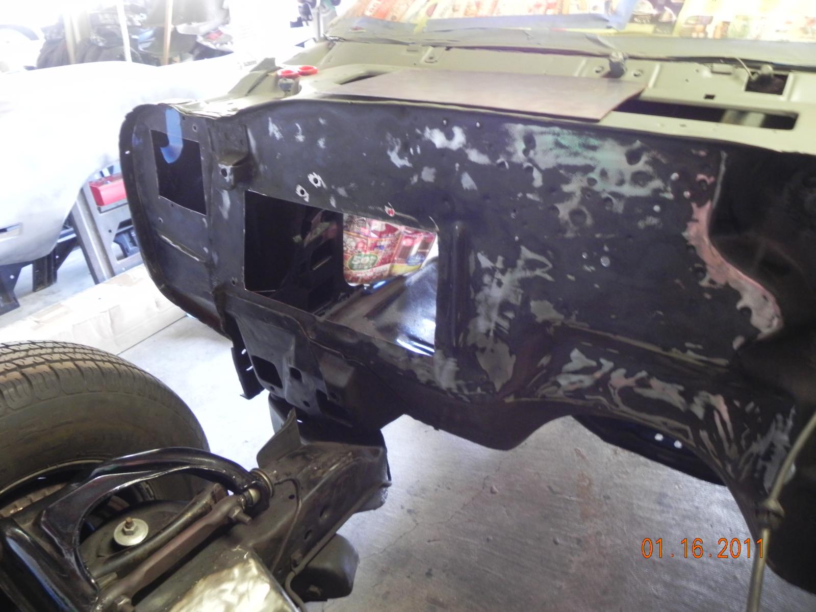

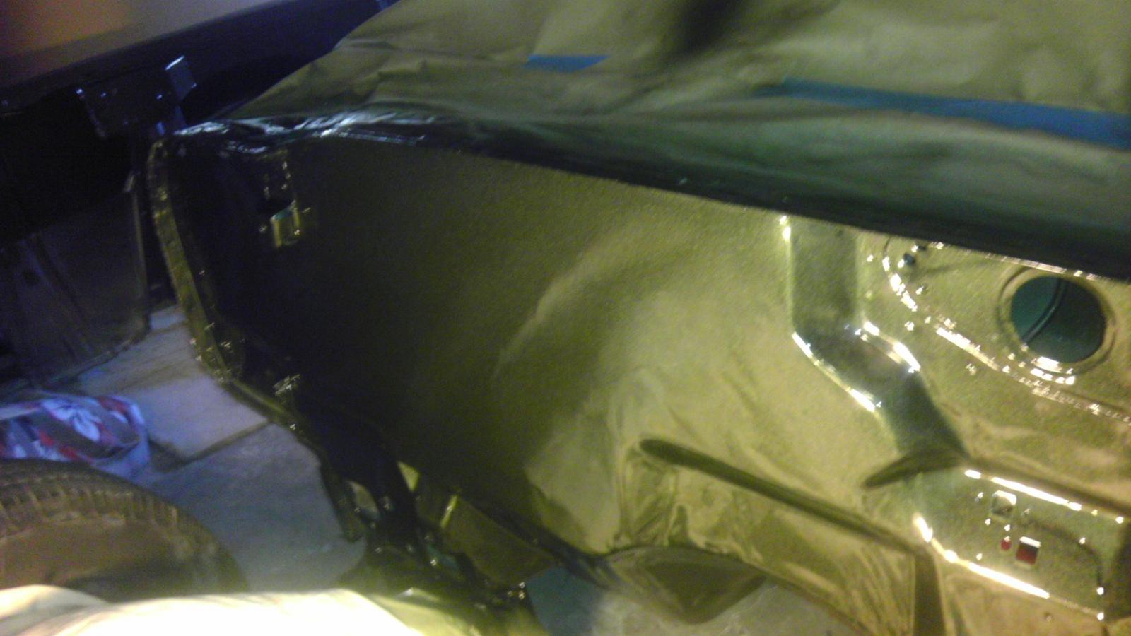

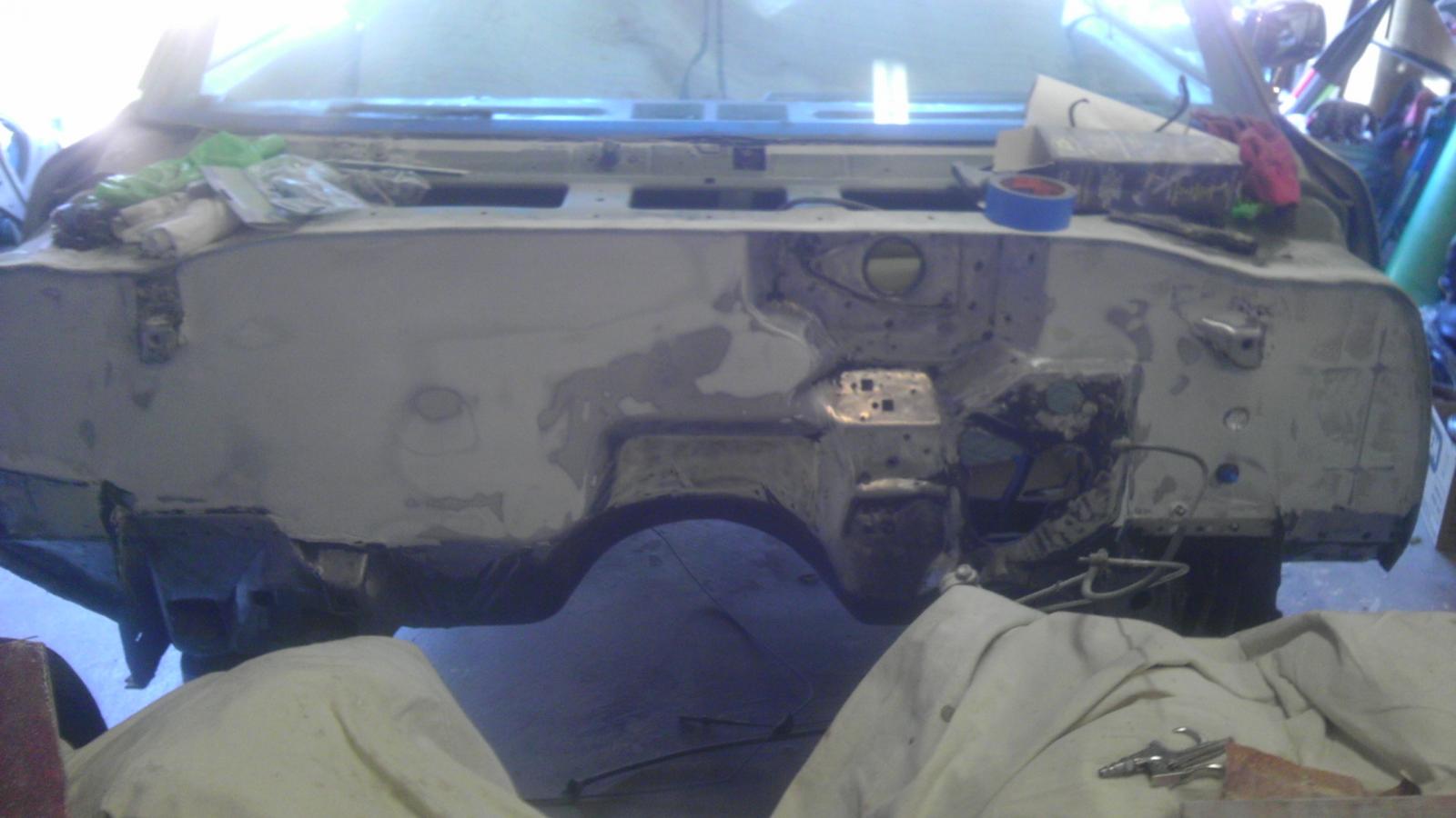

      Had the firewall painted,but I am redoing it now. I now floated my cowl smooth,no seam seal.

      Attachments not working. Interesting project, so far. What are those seats from? They are HUGE (and probably heavy, too), but they look comfy!

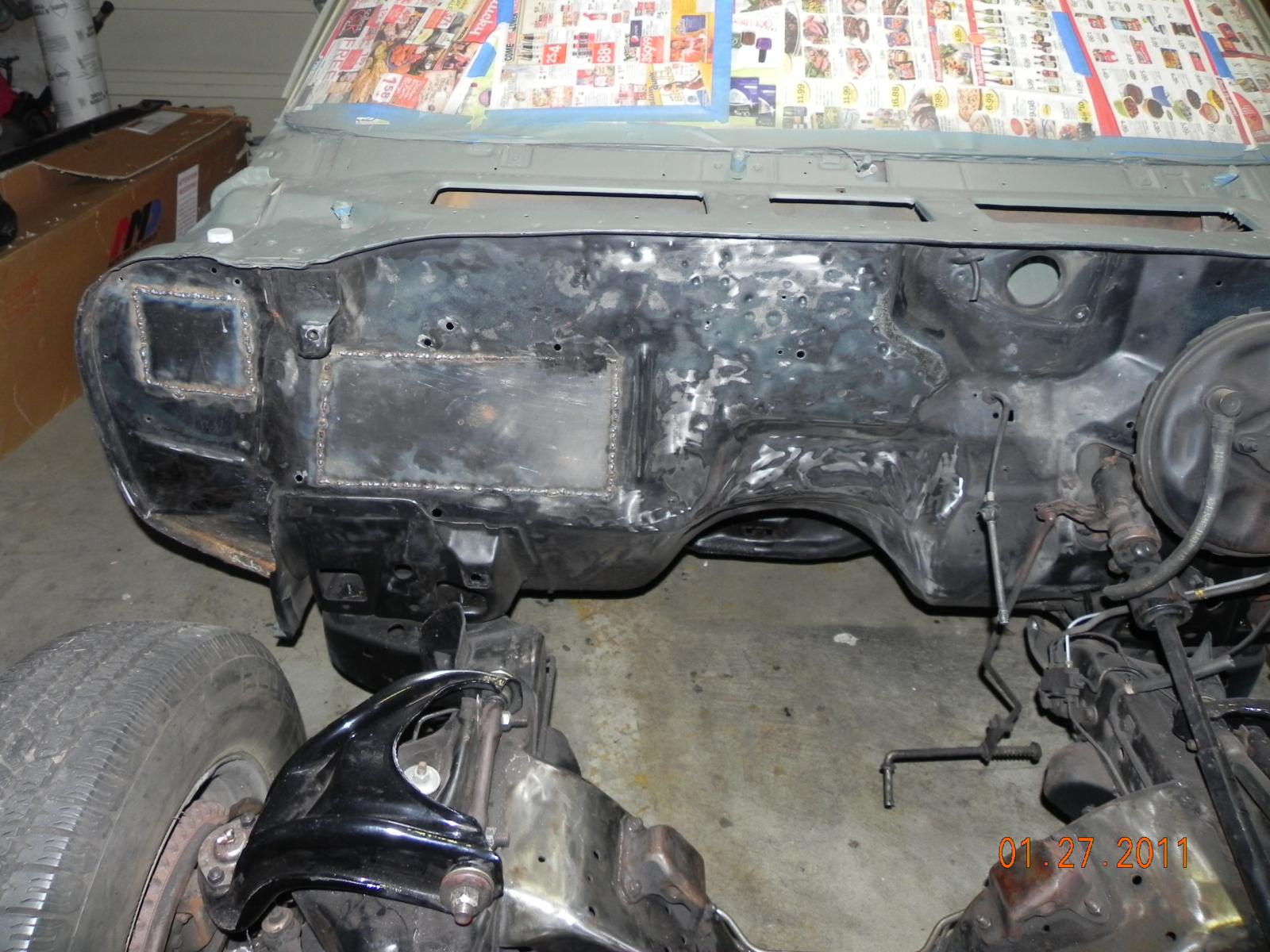

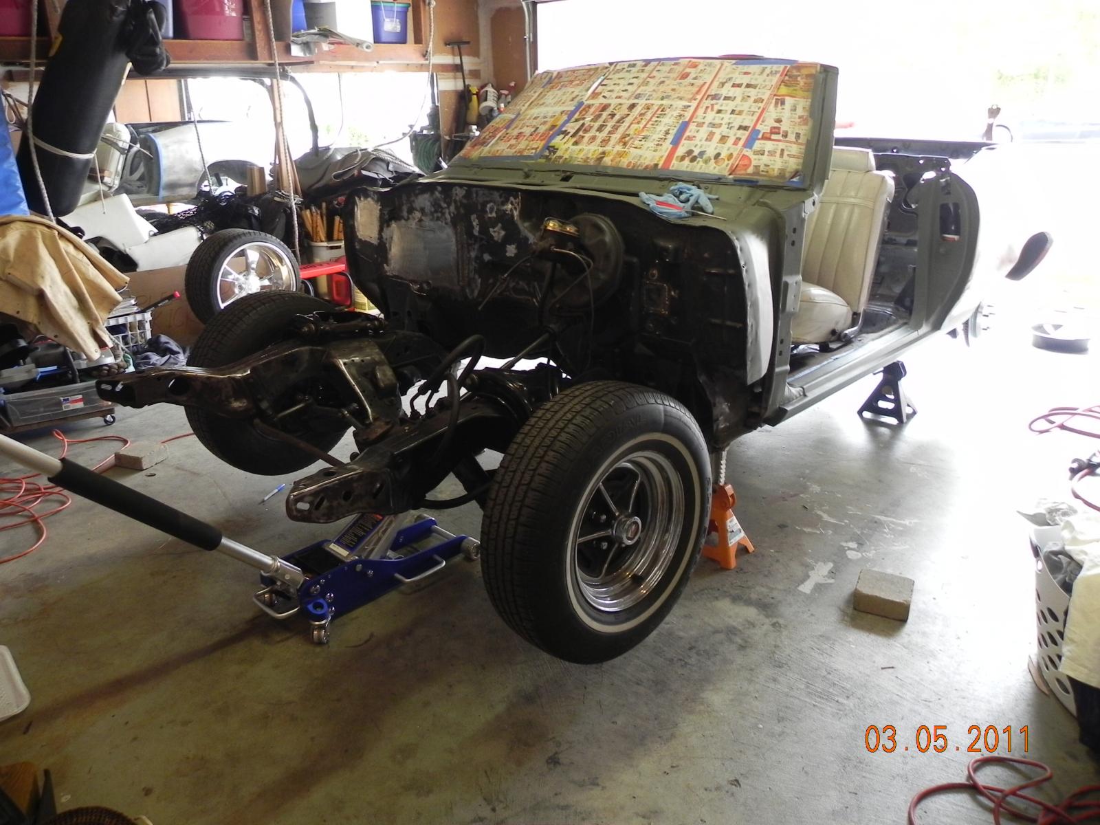

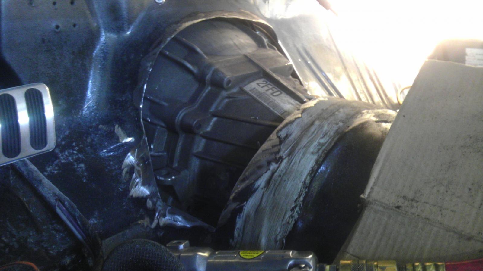

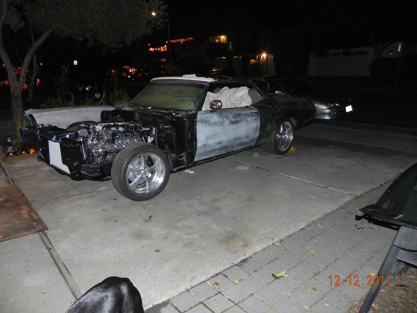

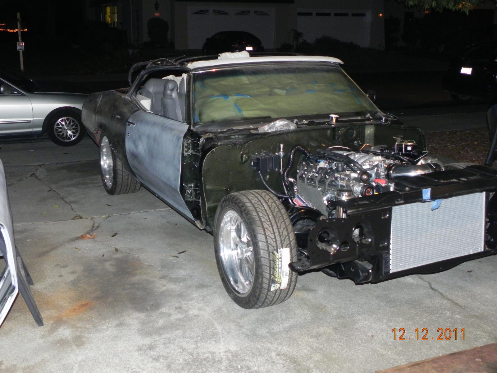

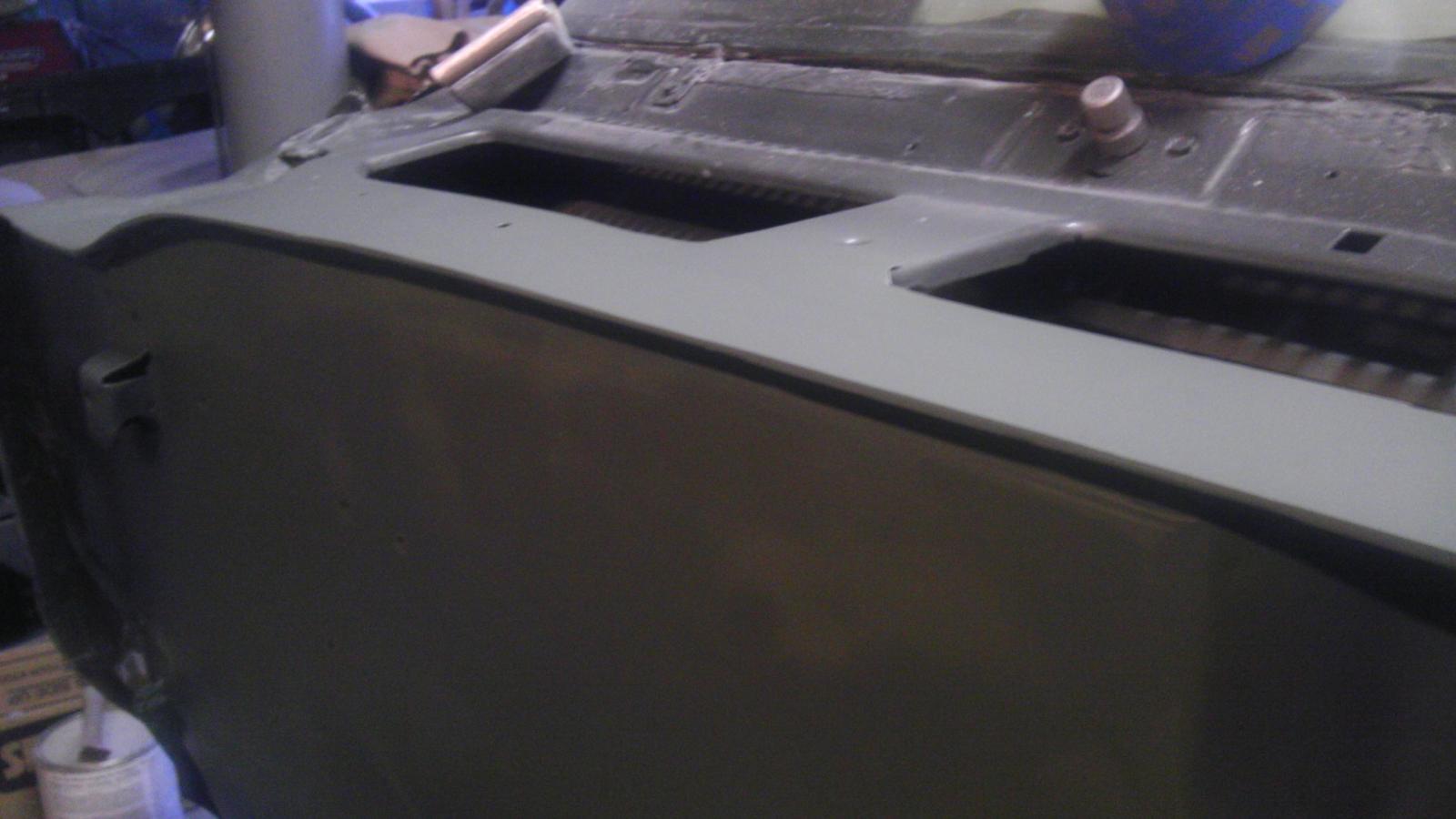

      I was supposed to do start up last christmas, then ran into a hickup. Found my transmission bell housing pressed up against the trans tunnel where I didn't find until I was doing wiring for transmission. From this point I pulled engine back out,widened the trans tunnel. Also rework the cowl and firewall section, had some things I didn't like so I figured now is the time. And also decided to order up my ridetech control arms,coil overs and Hotchkiss sway bars.

      Thank you,yes the seats are heavy! Hahaha! They are out of a 05 Cadillac Deville. Needed it to be comfortable for the family when we go to shows or events. I'm gonna try to repost pics.

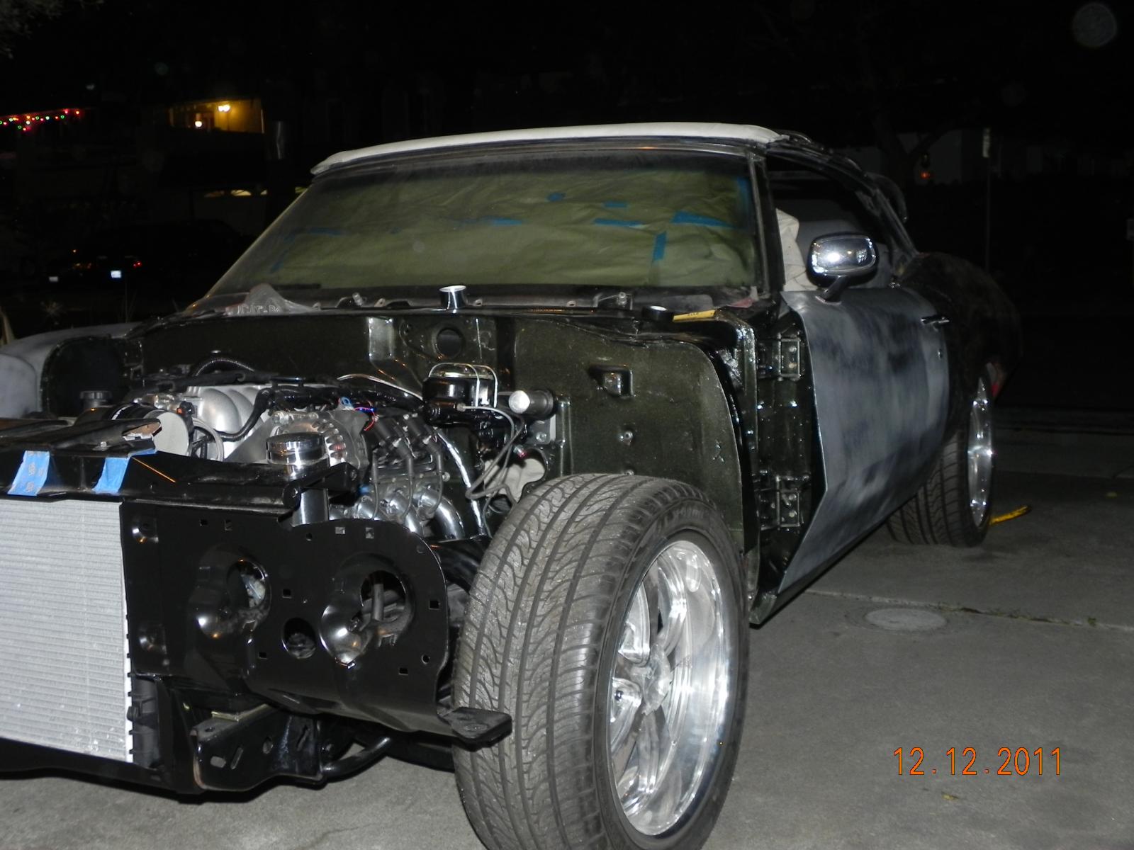

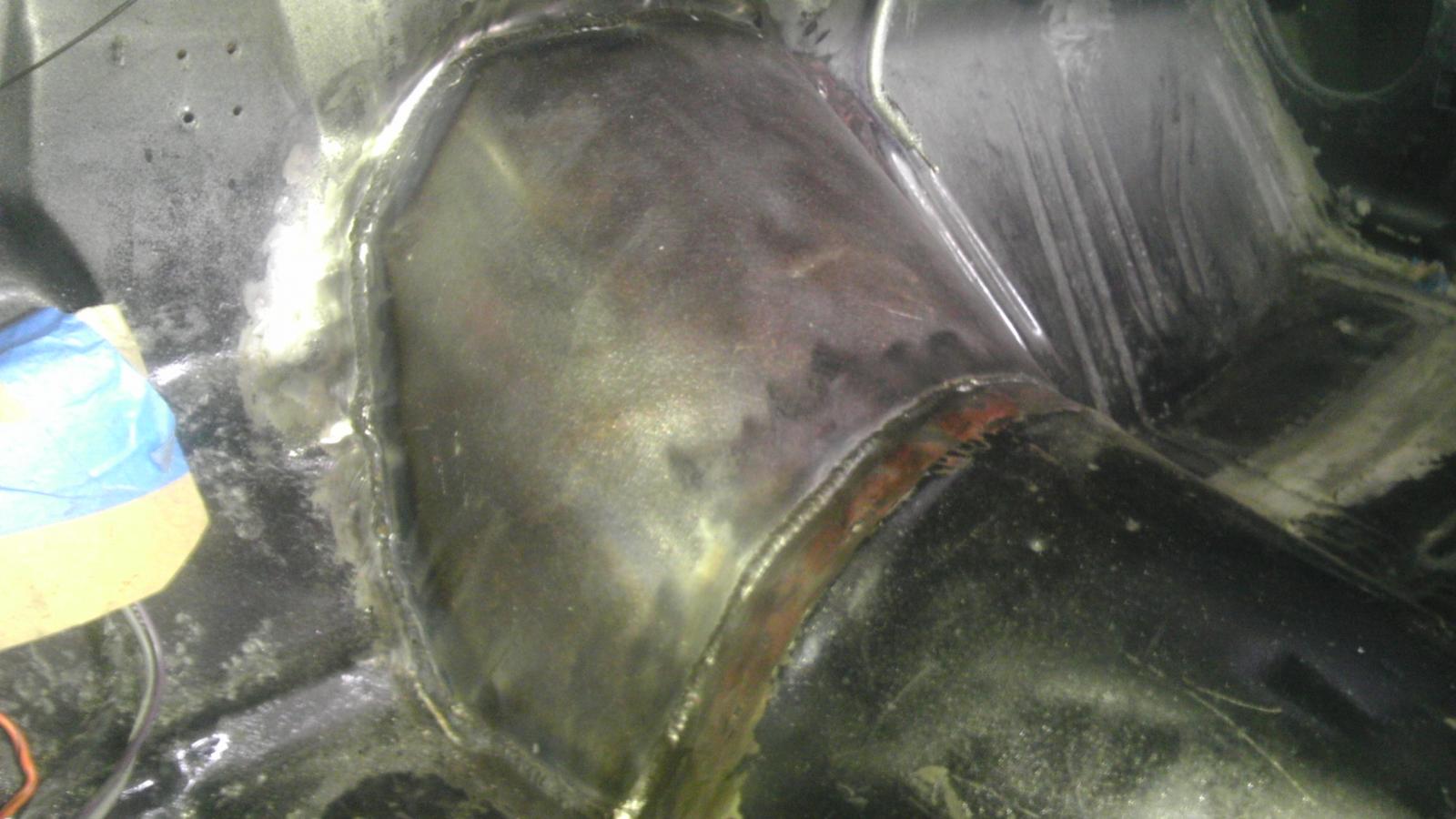

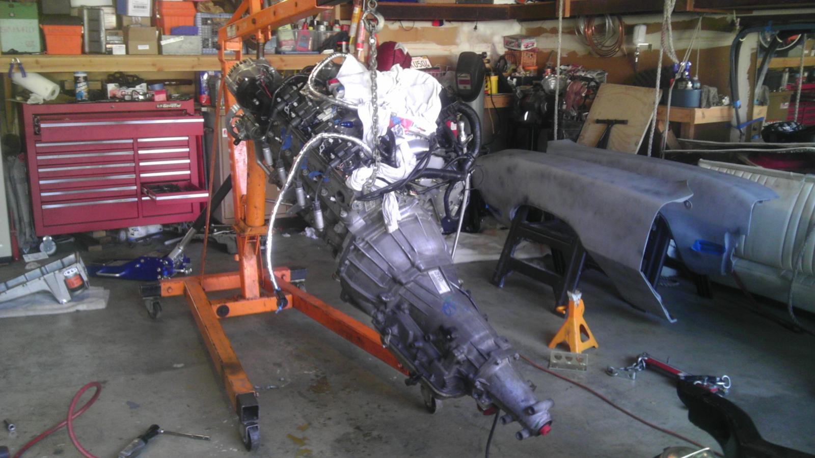

      When I test fit the motor and trans, later found that the bell housing was pressed up againts the trans tunnel. Ended up pulling it back out expanded the trans tunnel with some help from my friend Bryan. From this point is where I re-did the firewall and cowl.

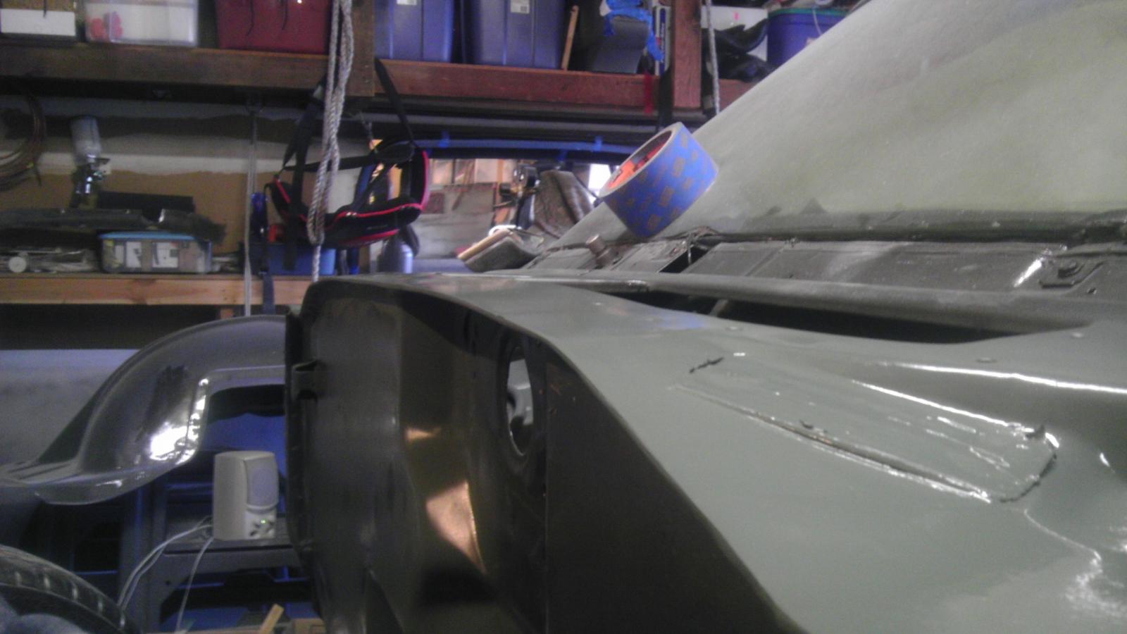

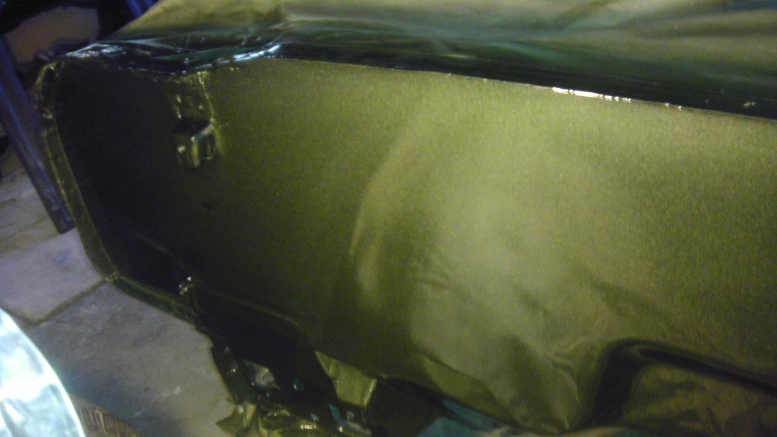

      Removed seam seal,hammer and dollied the edge and used fibergalss filler to smooth it out.

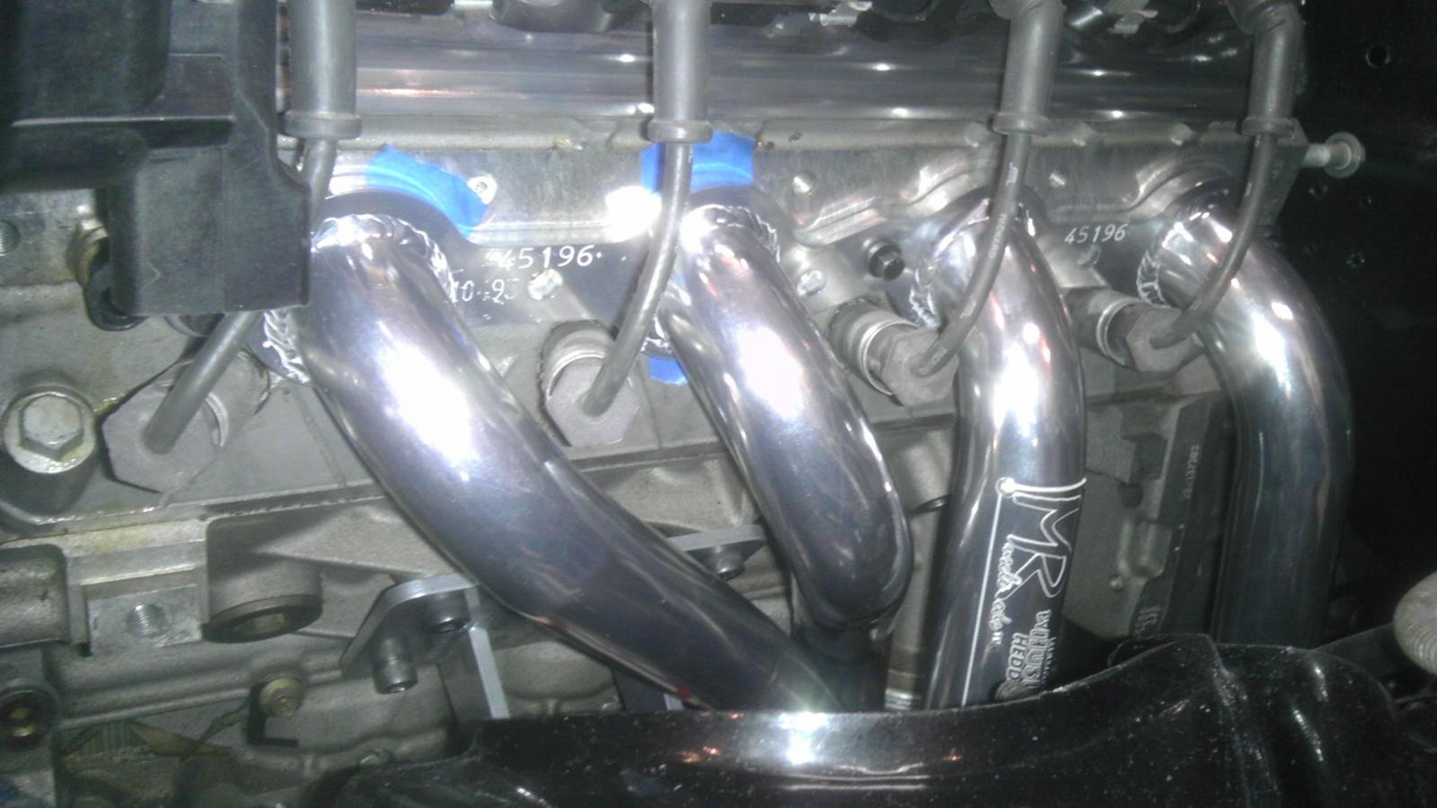

      Dec is def a good goal. I did the same thing you talked about with pulling it out of the garage, take it out around the block... it gave me alot of motivation(thats where that video came from). Unfortunitly i ended up having a bad oil pickup and i wiped that motor out that was in the video. I first had a rear mount which was very to set up and worked good. Currently i fabbed up a set of ss headers that i bought a cnc flange for my heads and went from thier. i run the turbo in the front now. The next time i do it to a project it wont be so bad. I learned from a bunch of my mishaps during my build. With the ls1 in yours, putting a turbo would be a cake walk. noone makes turbo headers for a nailhead so you got to get creative.
      But, your lark is going to look sick with the wheels and stance. Are you shaving any of the emblems or is the exterior staying all stock?
