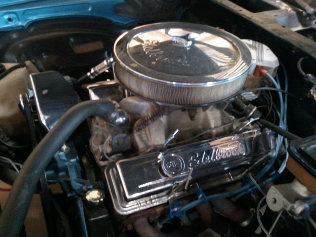

      recent activities... pulled the motor and trans ... tear down has begun

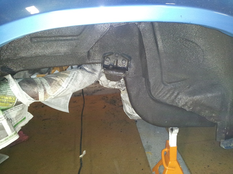

      on to pulling out the rear end... leaf springs.. and gas tank... all came out pretty smooth... i was going to re-use the original leafs... but after spending 2 hours buring out the front bushings... i noticed that the bottom leafs were cracked .. so after a complete waste of time .. i purchased new performance springs with energy bushings... switched the drums over to disks... calipers on it now are only for mock up... they will be switched over to willwoods towards the end of the build... also took the gas tank out stripped and repainted it ... also it received a new sender and 0-ring

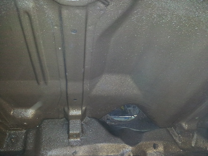

      after that ... the under side got a new coat of under coating and begun to hang the new rear suspension and diff..

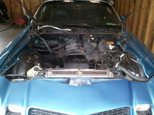

      after i got all of that completed ... i started on the front of the car... pulling the front clip off... to strip it down ... repaint... new bushings... and to mock up the new motor and trans...

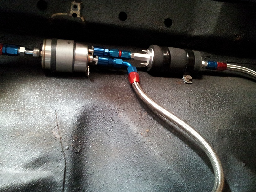

      my pops swung by with his baby to help me plum the the new fuel system

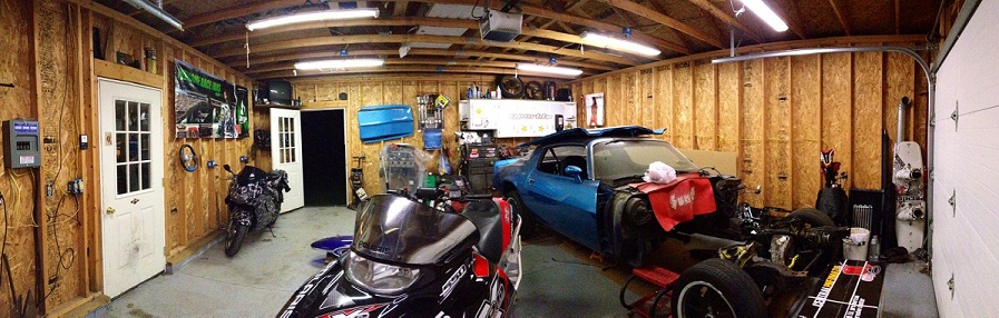

      Just thought i would share this... a buddy of mine swung by to help out... he took a pan-o-rama of the garage ... i thought it looked pretty sweet..
      Oct 2012
      164
      Country Flag: Australia
      That panorama shot is pretty cool.
      Looks better in pieces. ;-)

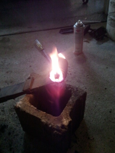

      got the suspension stripped off the frame... welded up some useless holes got them re-ground down .. i tell ya what... gm "tuff" coat is a pain in the balls get off... easiest way to get it off i found was a propane torch and a scraper... makes a hell of a mess tho
