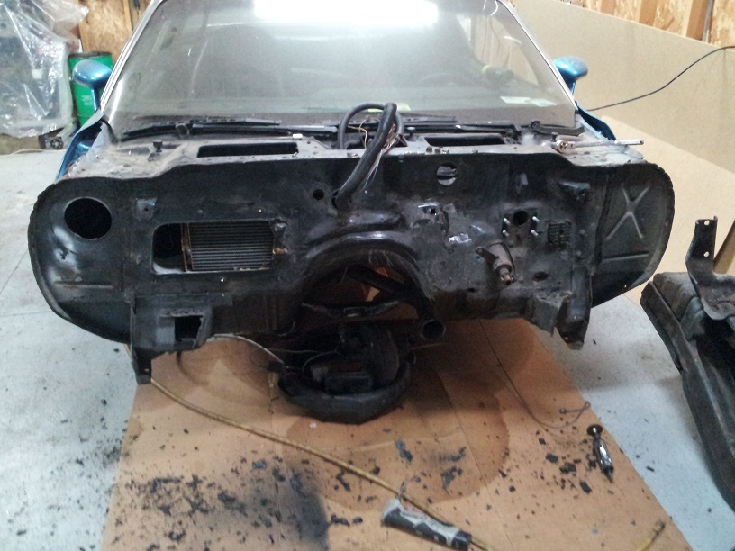

      begun to strip the fire wall... man the goo on it is naaaasty stuff... what did you all use to get this thing stripped and painted? anyone try oven cleaner or paint stripper? please fwd what worked for you guys

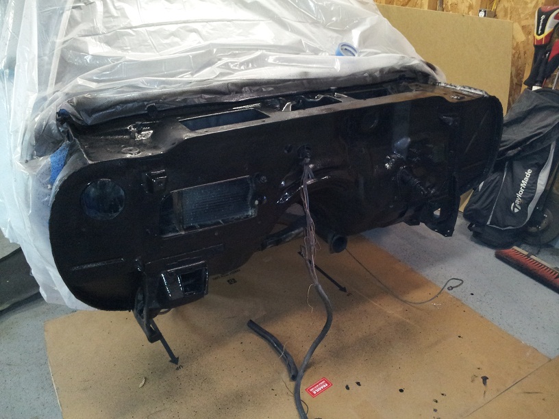

      well... made a little progress... got the firewall stripped... trimmed the drip rail off... and got some body filler on it... now off to sanding ... primer .... and paint

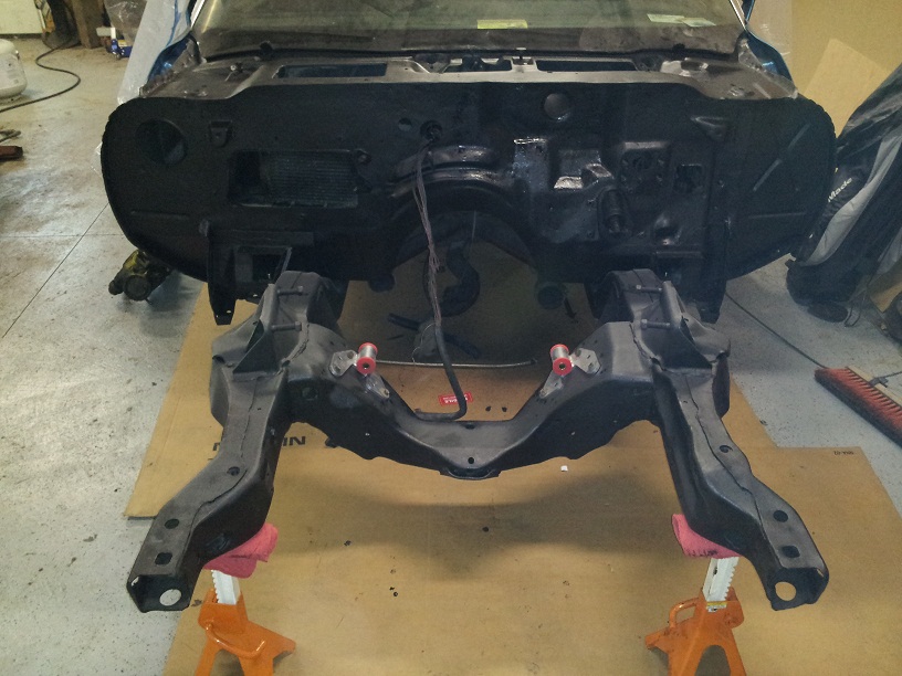

      Over the brake.. got to make some good progress... finished filling, sanding, and painting the fire wall... mounted the frame back up with new poly bushings... and mocked up engine and trans mount... just have to drop them in and make sure everything is aligned..

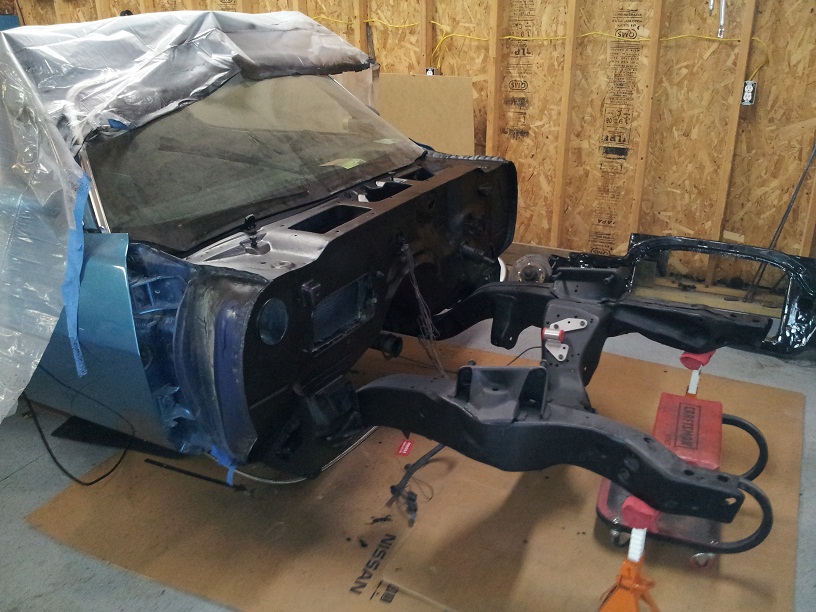

    20. #40
      Aug 2009
      ERIE, PA
      307
      thanks Leigh,
      Thats pretty much what i'm going for... i'm not a big fan of chrome... more of paint to match stuff... so i'm going to try to keep it as clean as possible
