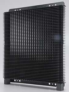

      11x11 B&M cooler
      I got a 11 x 11 x 1.5 inch B&M cooler for a SBC350 + TH400 in the worlds heaviest FSJ Cherokee ( 7000lbs ) The fan is a Ford 11-12 inch from a radiator (2 fan setup cut in half) The cooler is located in the back sucks air from under the car.. When running fan constantly the temperature keeps at 80C = 176F.
      A 15 x 8 cooler should do fine even without a electric fan when located in the front.
      Lars in Philippines
