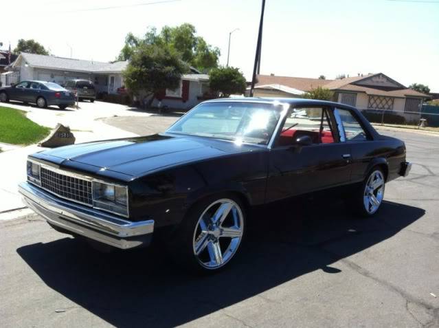

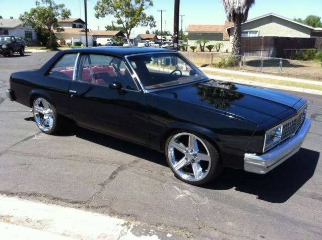

      Im going to be going with the same front end pictured in the 1st pic.. blacked out, and bumper sectioned and tucked powder coated satin black as well..
      is the el camino front end more desirable? more appealing? do post a pic if you have one, id like to see

      If youre sticking with a light color and chrome rims then yes you need an el camino front end,direct bolt on check it out.

      [QUOTE=Trans;943250]If youre sticking with a light color and chrome rims then yes you need an el camino front end,direct bolt on check it out.
      [QUOTE]
      Plan was satin black.. everything else blacked out with a touch of brushed aluminum here and there to tie in with the rest of the chassis and motor accents..
      thanks for the pic! opens my eyes to that idea, never really noticed the elcamino front end before... definetly considering that now..

      Quote Originally Posted by Trans View Post
      meh. the later nose (came stock on malibus, not just el caminos) looks too much like a caprice IMO. the earlier single lights look better, but to each their own. I always preferred the single headlights to the quads.
      anyway, I love this build! I had a '78 malibu for a little while in the early '90's (w/ a 3 speed stick!) but didn't have the money at the time to finish it.

      its a cheap mod,defenitely looks better than the malibu
