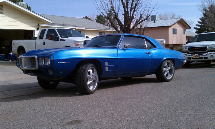

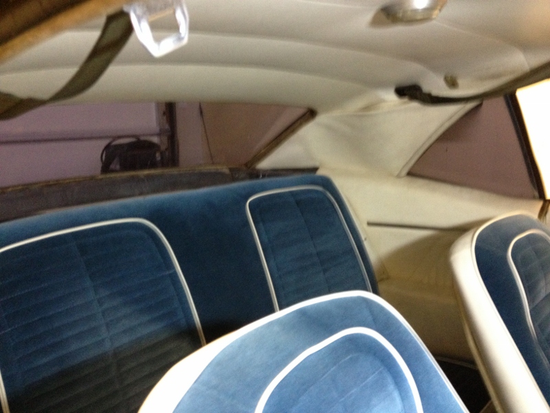

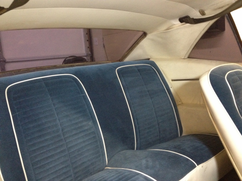

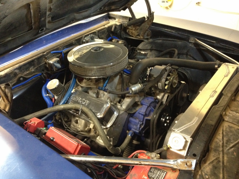

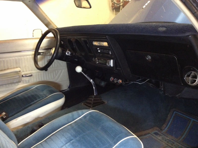

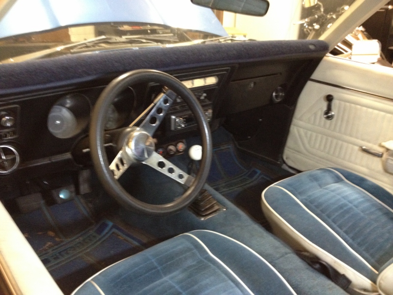

      Before photos: (I apologize for the grainy photos, I am not a photographer)

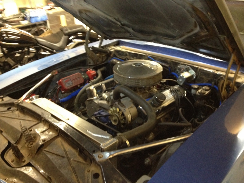

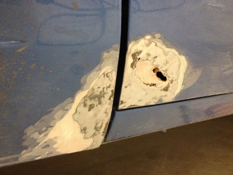

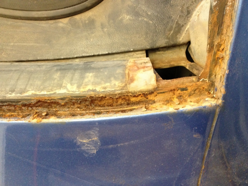

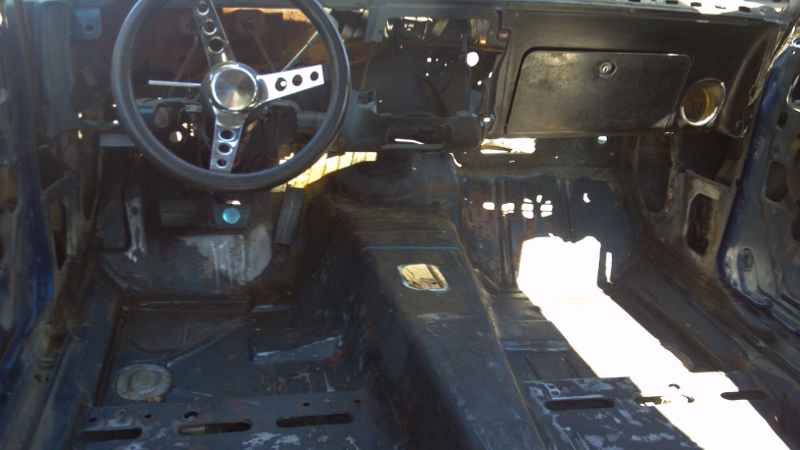

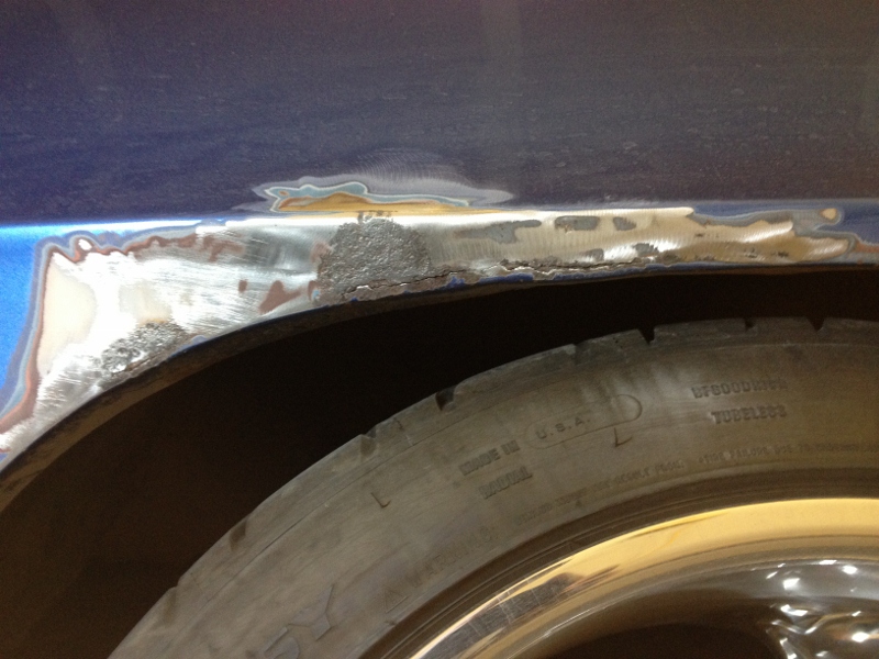

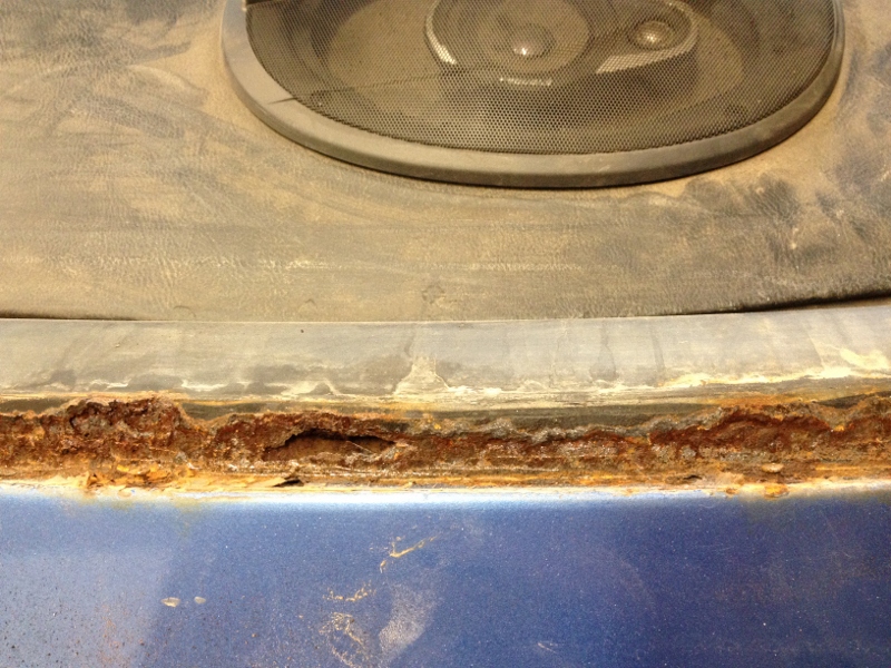

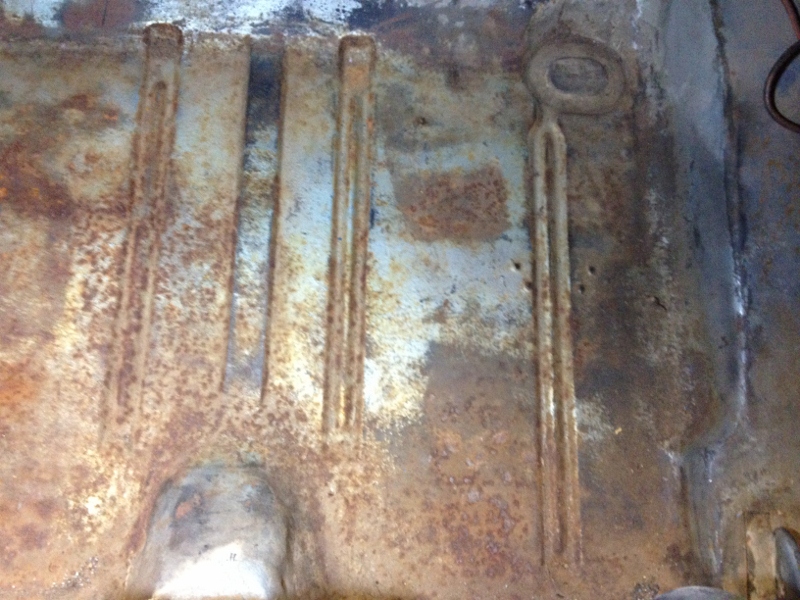

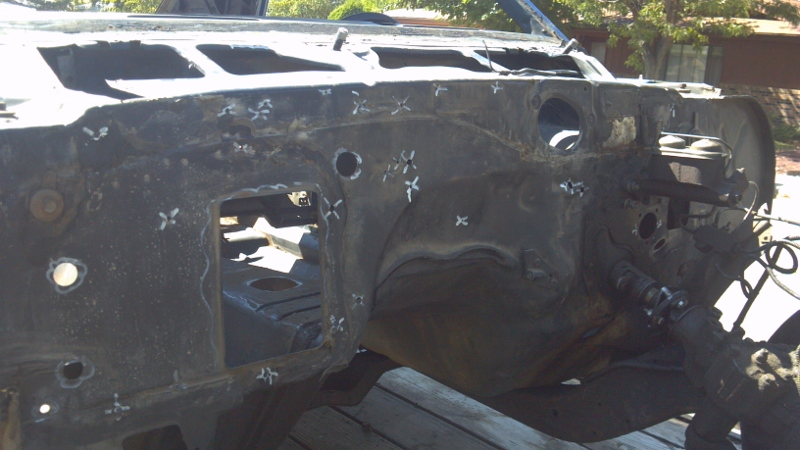

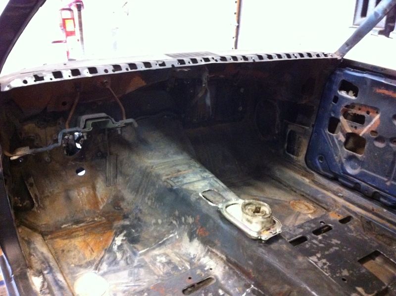

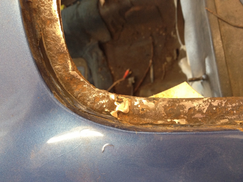

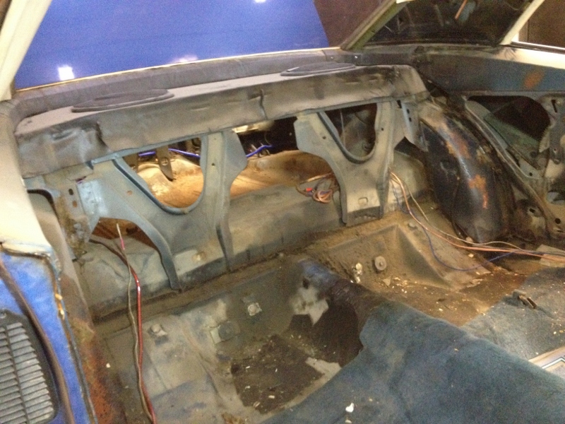

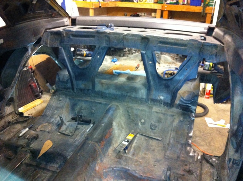

      And then I began to tear down and uncover some nice "surprises". Although I will say for being over 40 years old I am quite happy its not any worse.

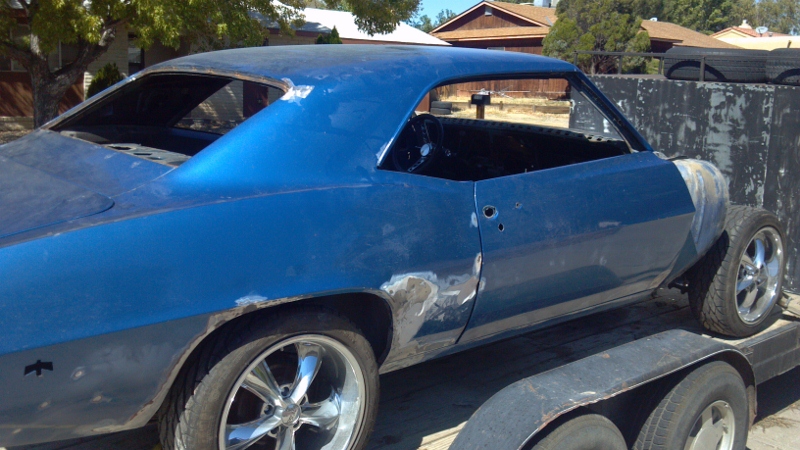

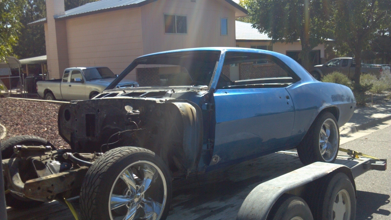

      After some disassembly and clean up it is on the trailer ready for the body shop:

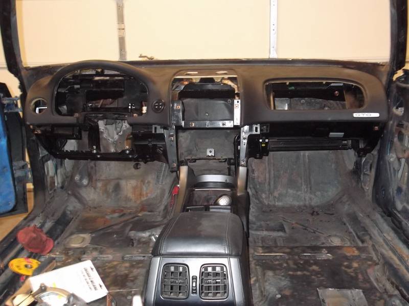

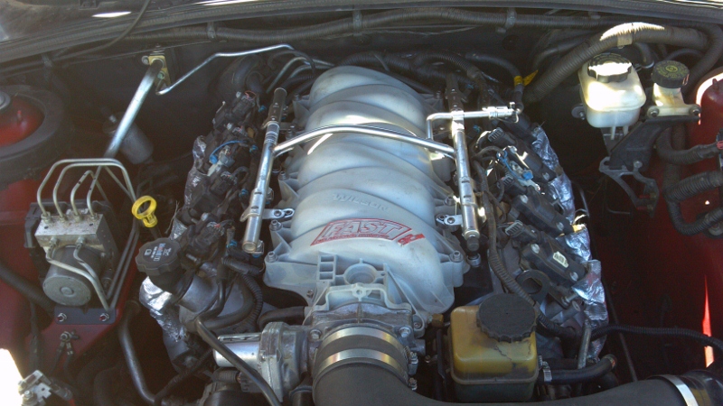

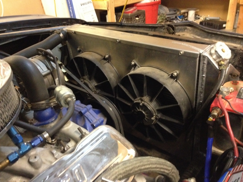

      Picked up the donor car this weekend. ‘05 GTO with 42k miles. Supposedly has an engine and transmission upgrade. I never trust what people tell me when they are trying to make money, but it does handle quite well. They produced a Dyno sheet showing 488 rwhp. It does have a Fast intake and headers that I can verify, but no way of knowing if it has the head work and cam I was told it did. Drove it home and got a sold 24 mpg cruising at 75 so even if the gearing in my bird drops that a bit its ok for the acceleration gain. Now I get to wait for the car to come back from the body shop to start my mods and mock up.

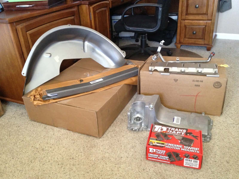

      In the mean time I have been preparing for the actual build when I get the car back. Santa was kind to me this year and brought a few goodies. Motor mount plates, new oil pan, DSE tubs, DSE subframe connectors and aluminum body mounts.

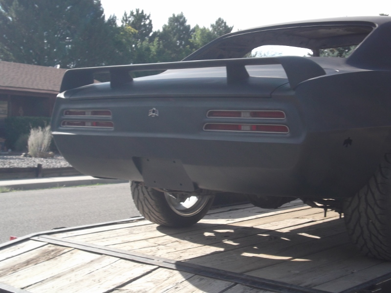

      Interested to see what you do with the tail panel.

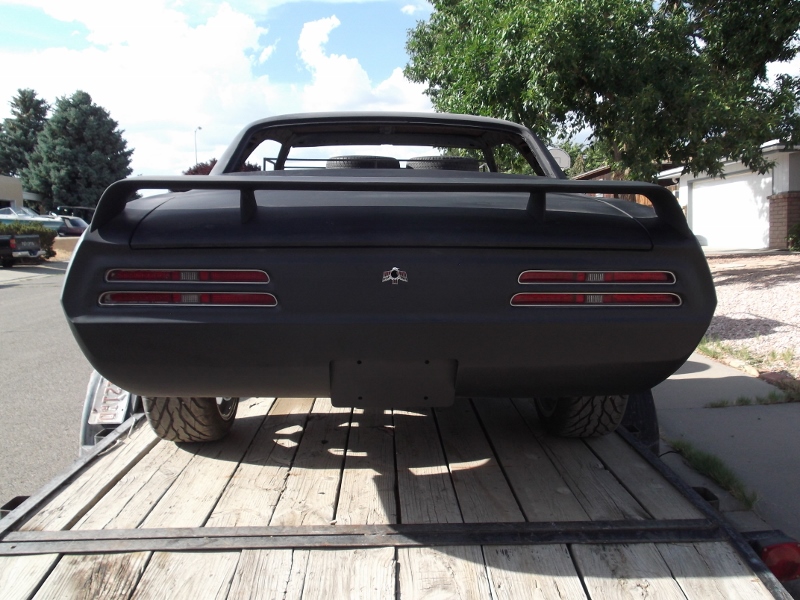

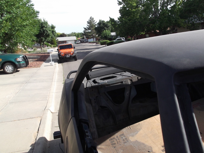

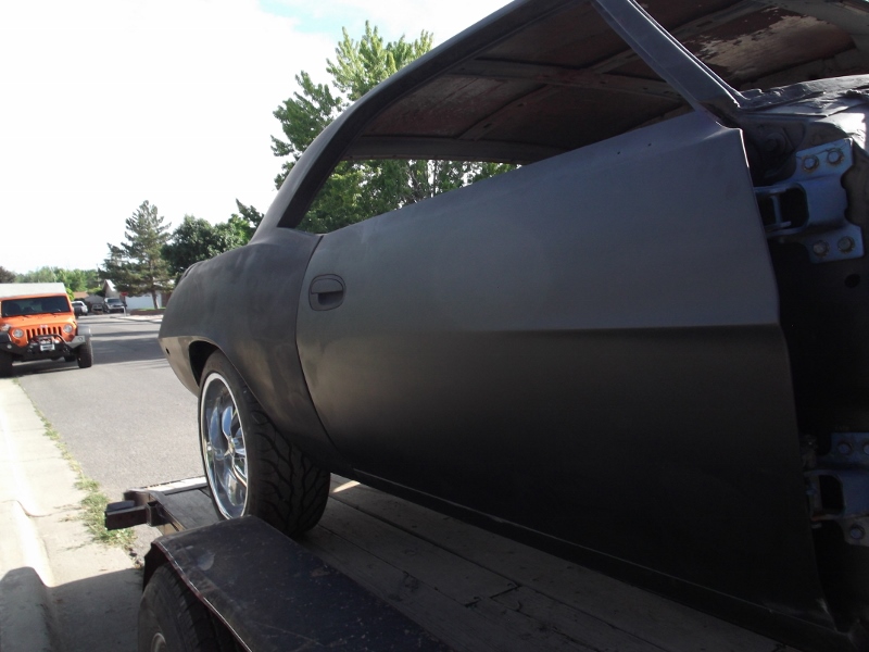

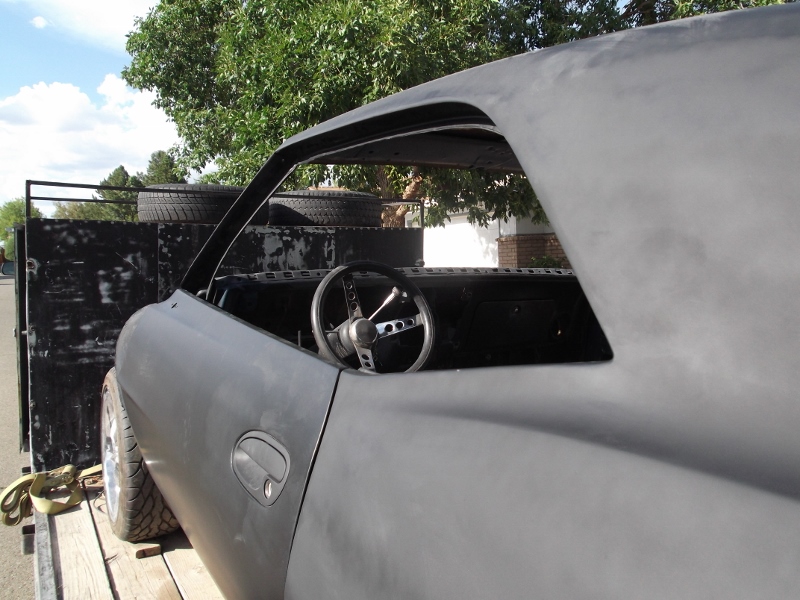

      Car got a furlough from body shop jail! Now I get to begin the task of mock up and remaining modifications. Before sending it back for final finish and paint. So far the body work has exceeded my expectations. Next up install tubs and subframe connectors.
      Got the shaved drip rails, welded seams, flush door handles, rot removed and custom tail panel.

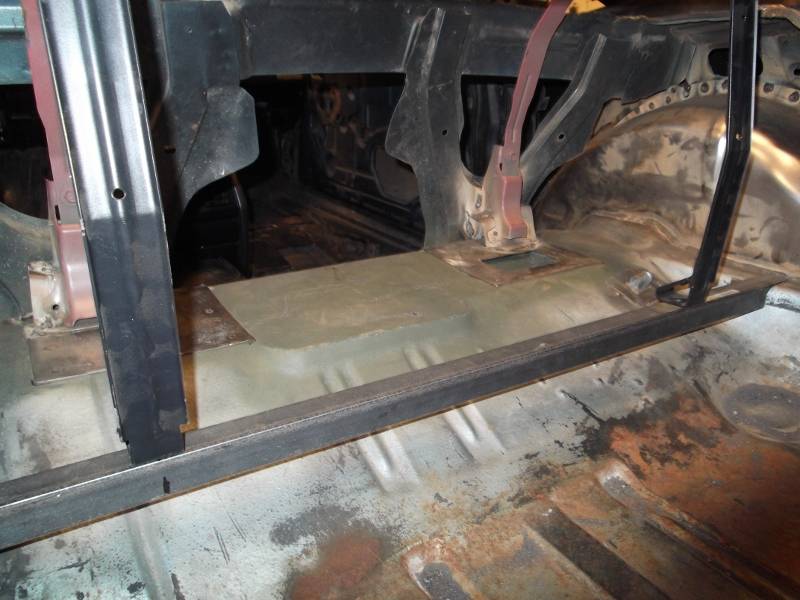

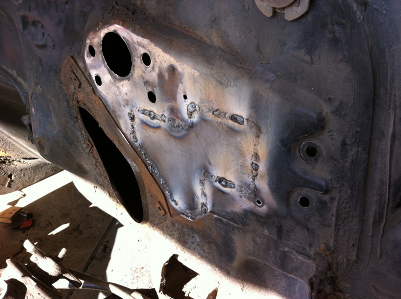

      Been a busy couple of weeks but made a little progress. I have noticed I tend to jump around a bit while working on my car as I wait for this or that but things are coming along.
      Subframe Connectors in with some help from a friend on the welding.

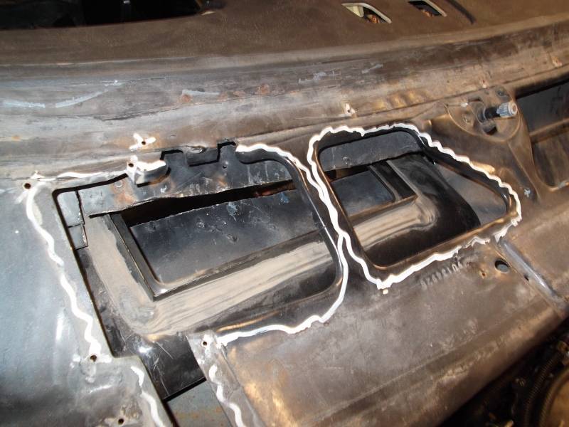

      My first patch in the firewall, a little ugly, nothing a good grinder cant fix

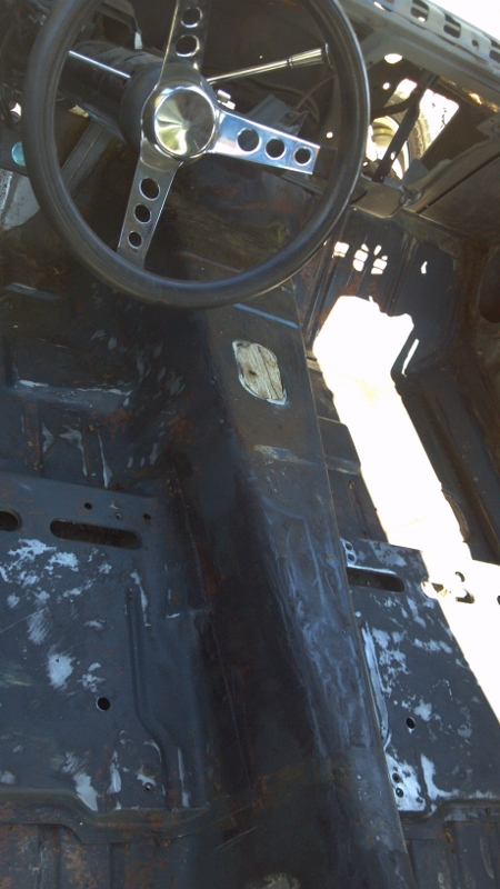

      cut out old dash

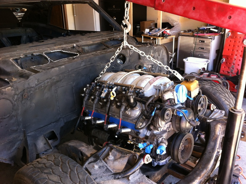

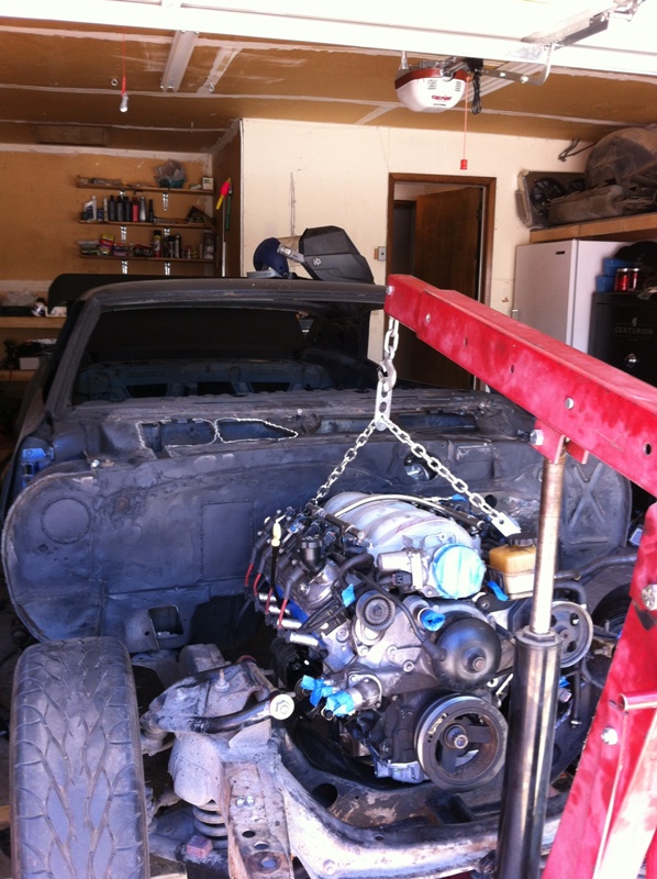

      Set the motor into place. Thing definitely looks like it belongs there. I have the wrong engine stands so the oil pan was hitting the cross member before it would set on mounts. Should have new brackets in by Friday and can get it resting in there without the cherry picker.

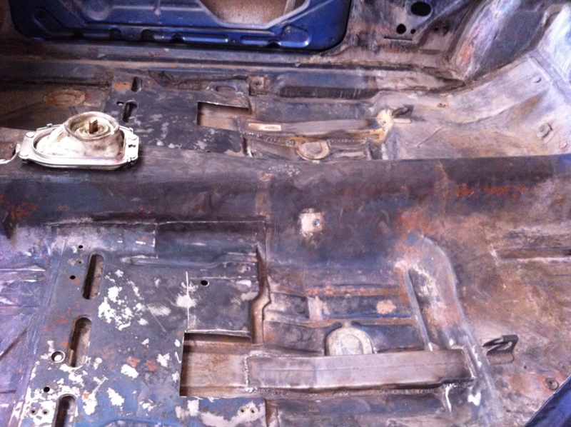

      Been hard at it and thought I'd post an update. Got the rear inner tubs cut out and have the drivers side almost in. I need to get the passenger side in place so I can run a clamp for both sides to get a tighter fit.
Size:  197.6 KBName:  IMG_0240.JPG

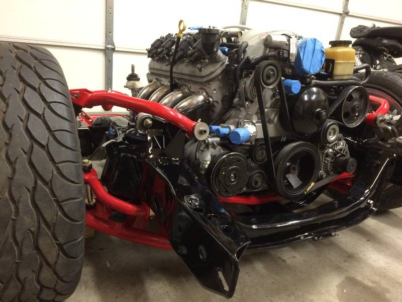

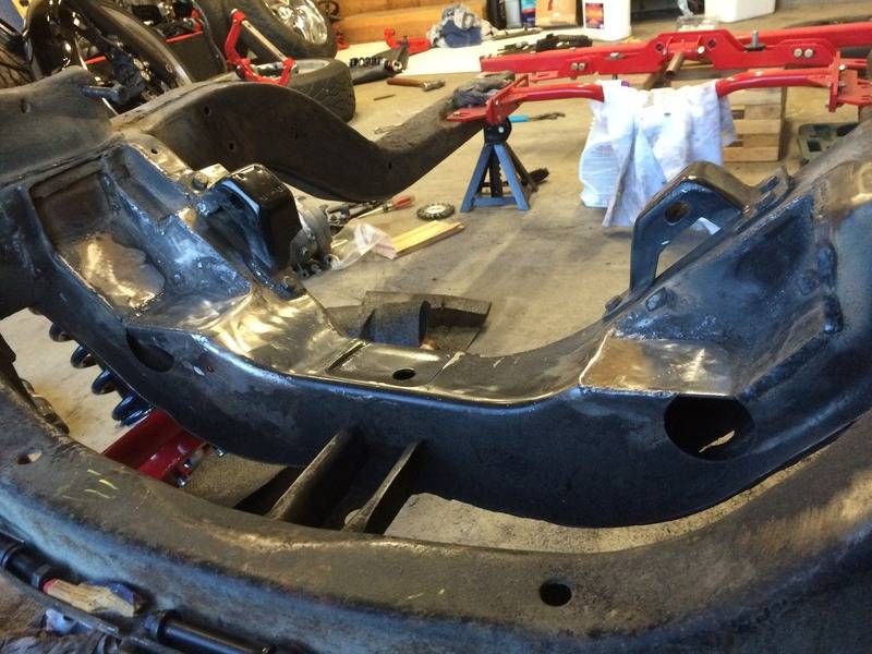

      After a little trial and error with the engine mount I ran into a few snags. My initial assessment was that the engine stands were too short causing the oil pan to hit the cross member. I had the reinforced performance small block stands and the "muscle pan". I also noticed the pan stuck much further below the crossmember than I would be comfortable with. I plan to run the car fairly low and don't want to replace my pan all the time. I got the standard small block stands which lifted the motor mounts about 1/2" but put then they would not line up with the bracket holes and the tranny mount was short about 1/4" from being able to bolt on as well. I got a Mast oil pan to fix the ground clearance issue. When I did so it looked like I had a ton more room between the motor and member. I put the original stands back in and "viola" mounts lined up and bolt fit into the tranny. I was finally able to get the cherry picker out of the way and put into the shed. Its a pain working under the car with the picker legs taking up so much room.
      I ordered some Dynatech 1 7/8" headers and got them test fit. I have tons of room between them and the steering box which I was worried about. My Pontiac headers only had about a papers width between the box and headers, now I can easily get my hand between. Plug wires look like they may be a tight fit and may need to be changed out.
      I have also been looking into my front accessory drives. While aftermarket systems look nice I just cant justify the $1-2k when I have a perfectly good stock set up. My alternator and A/C compressor obviously wont fit without some fab mounted low. The alternator will be easy as it only requires a small notch. The A/C will be a task and has taken a lot of planning on my part and I may have it figured out. A typical notch wont work because of the hose inlet/outlet on the compressor. They wont fit in stock location due to them being a side exit right where the frame rail is. I was going to do a relocate bracket to passenger side high. After some research I found that I wont be able to use a stock/factory compressor on the relocate. Seeing as how I plan to use the factory air components in the cabin from the GTO I would like to stick with a stock compressor for compatibility. My plan is to rotate the compressor in the stock location about 45 degrees which should put the connections at about the 11 o'clock position while still maintaining the factory belt set up. After a little mock up and cutting on the factory bracket I have it just about ready to weld. I am also going to have to cut off the top rear mounting tab from the compressor making it a 3 point as opposed to 4 but I think it will still be fine. After I have my bracket I am going to set it in place to see how things line up before I start cutting the crossmember. I'm going to try and get the bracket welded tomorrow but need to take it to a friend's shop because I have no way to work on the aluminum bracket myself.

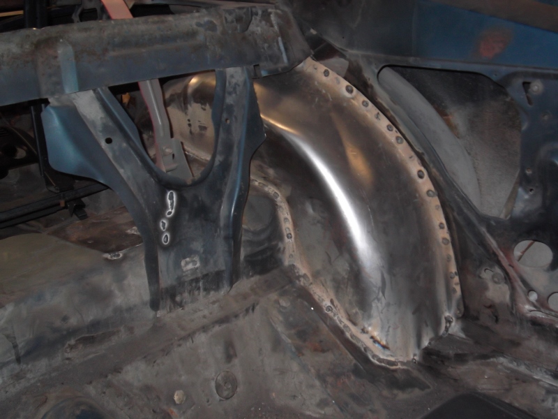

      Its been awhile, so its time for an update.
      Finished up the rear tubs.
      Name:  DSCF0219 (800x600).jpg
      Name:  DSCF0220 (800x600).jpg
      Name:  DSCF0221 (800x600).jpg

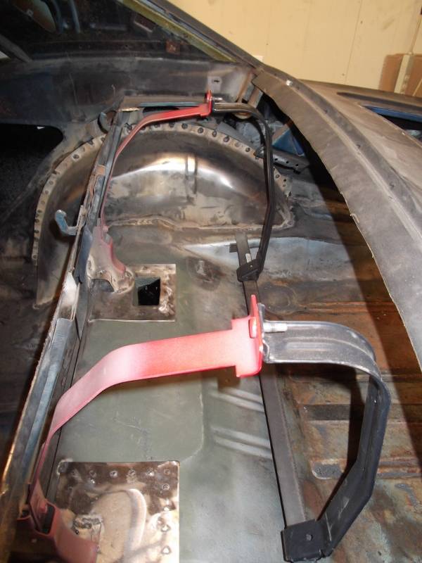

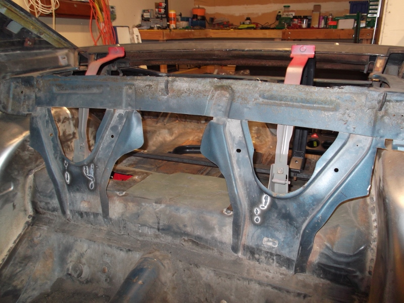

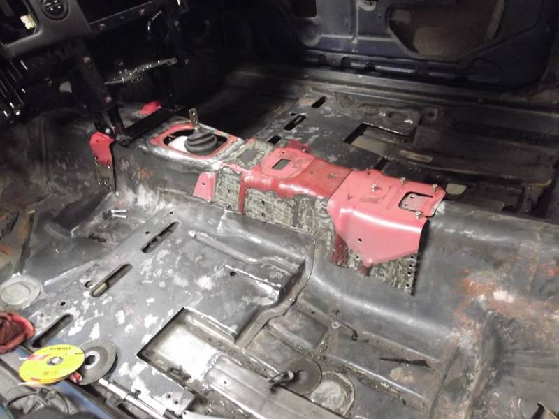

      What are the red brackets behind the rear seat supports? Seat belt mounts from the GTO?

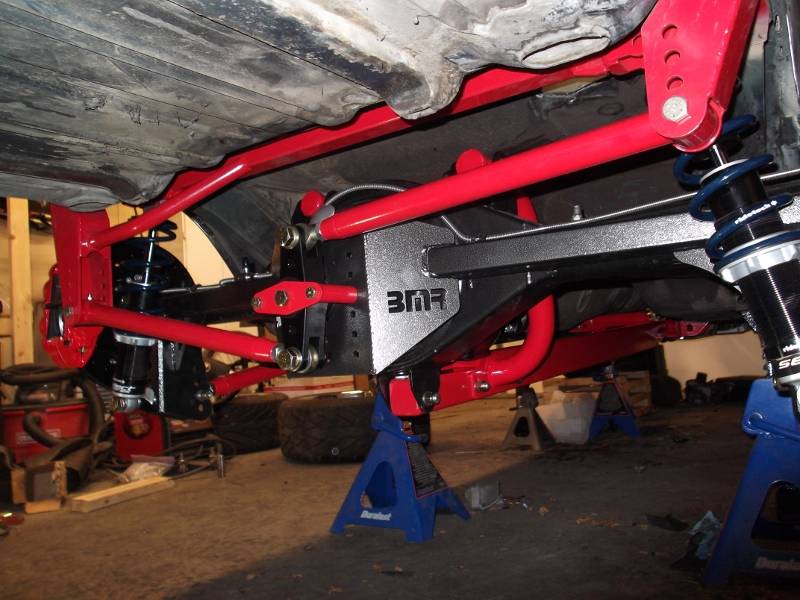

      Aug 2012
      68

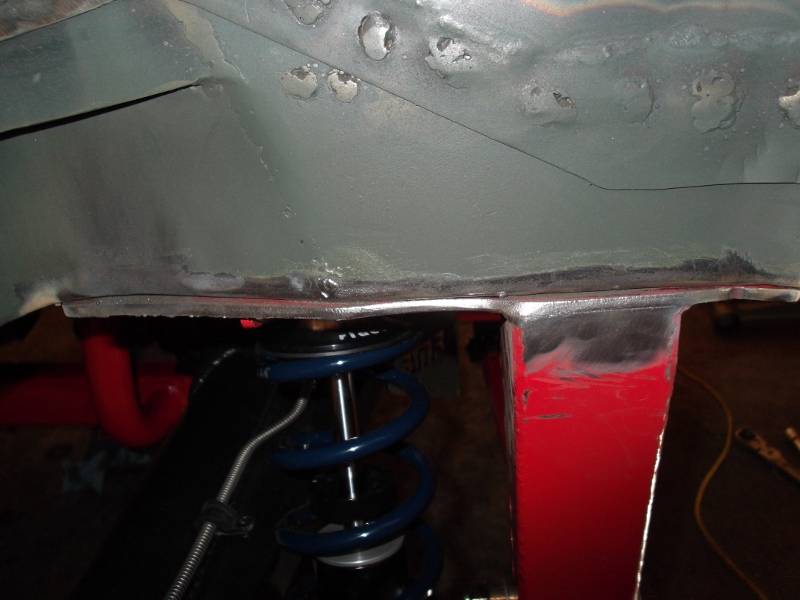

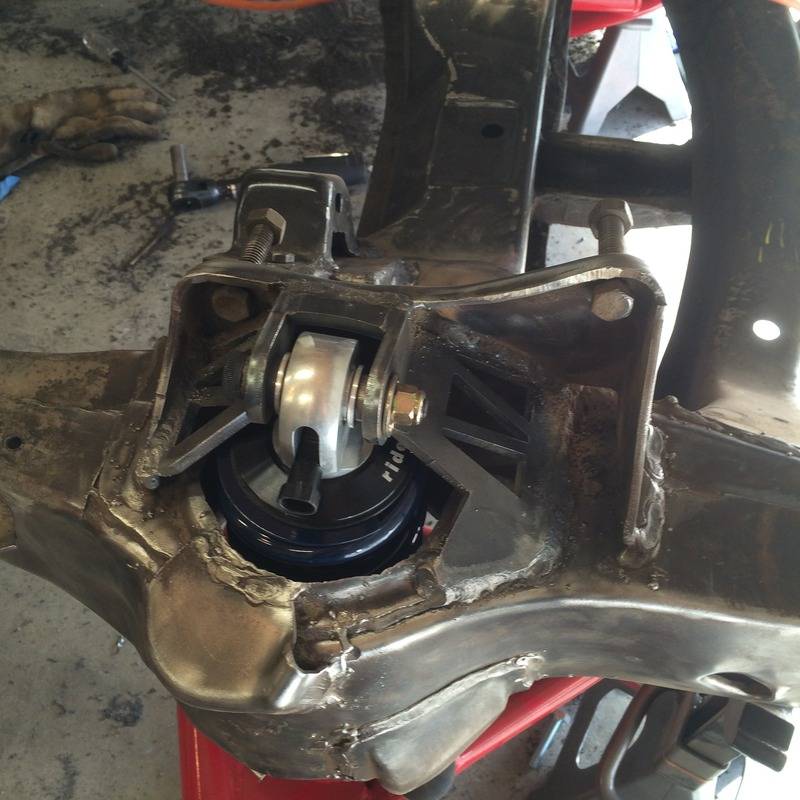

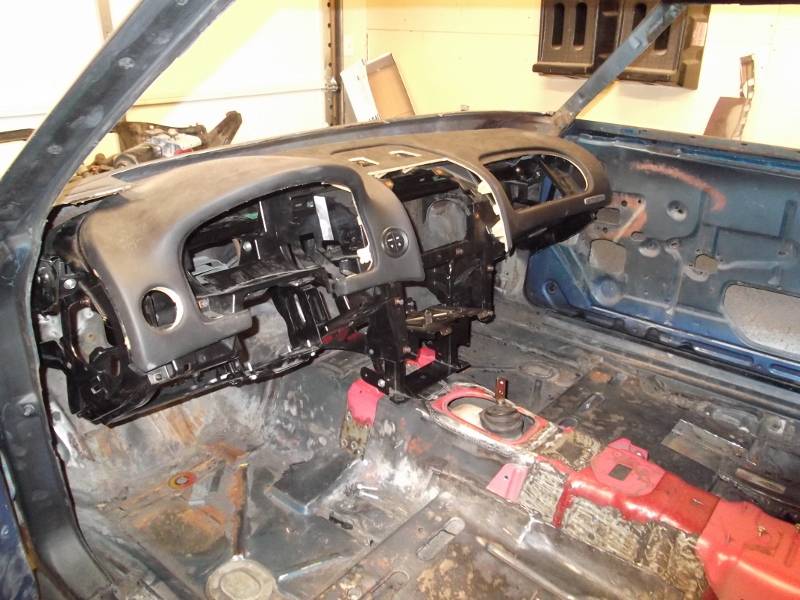

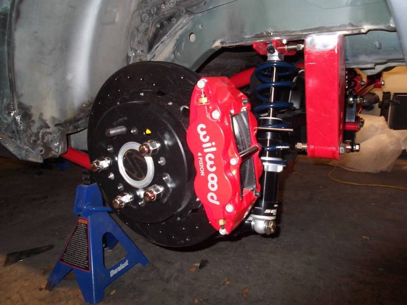

      Got the new BMR rearend mocked up. Installed the 13" Wilwood brakes on the strange housing and got it all bolted into place. The tub is still pretty ugly because I plan to do all my cutting welding and grinding for mockup prior to finishing the underside. But the new suspension sure looks pretty!
      I had to do a little modification due to the notching of the frame. The shock crossmember had to be trimmed to match the notch. It will be welded once I pull everything back apart before paint.
      I got the gas tank mount mostly figured out. I cut the straps from the GTO and leveled the rear shelf floor over the axle. I welded the front strap mounts and tried to mount the rear to a piece of angle iron stretched across the tubs. This puts the rear straps about 1/4 inch high so it wont mount the tank flat. I have an idea on how to lower it and will just try to mount it across the floor.

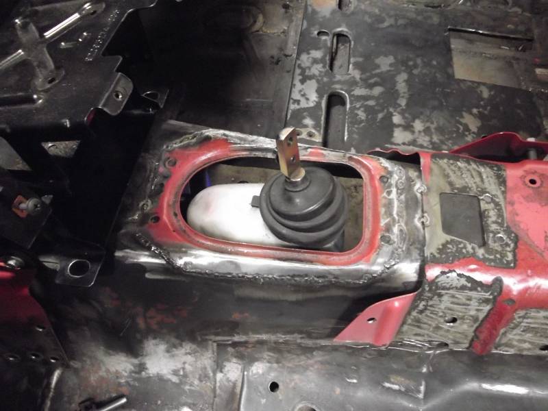

      I am currently working on swapping the dash and console. I cut part of the tunnel from the GTO and have it tacked in place for now. I also cut the flange for the shifter boot and welded it in so I can use the GTO shift boot. The dash has been quite the under taking. I have been cutting little by little trying to get it to fit. I plan to use the HVAC from the GTO so I need to graft the fresh air intake into the cowl while I get the dash to fit so it has been kinda a pain. I have also been mulling over the VIN. I talked to a State Police Officer about it and he highly recommended leaving it in place. So I am going to need to notch the dash and find a way to make it look nice when I try to fill the gaps with fiberglass. Here is my progress so far. The dash still needs to go back and up about another inch and is just set in place.
      You can see the VIN on the left under the A pillar.

      68
      Quote Originally Posted by rickpaw View Post
      They are the gas tank straps. I am using the gas tank from the GTO as well. I still need to alter the straps some. Lower the rear straps and lower the profile of the tabs up top so I can hide them under a package tray.

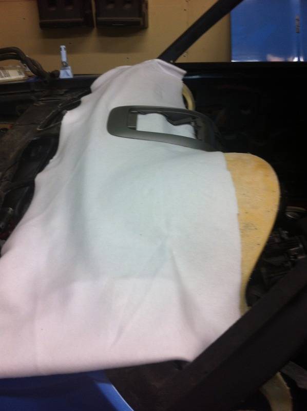

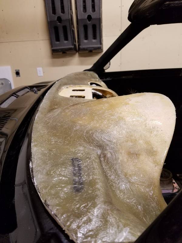

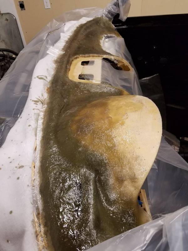

      It's been a long time since I have updated. The project has taken longer than I have hoped but is still moving along. Life, work and the body shop slowed things down, but I started fanning the fire and have made a ton of progress in the last few weeks. I will try to post photos closer to each component and not chronologically. This will be helpful with the dash I left off on and barely did the bondo work on last weekend.

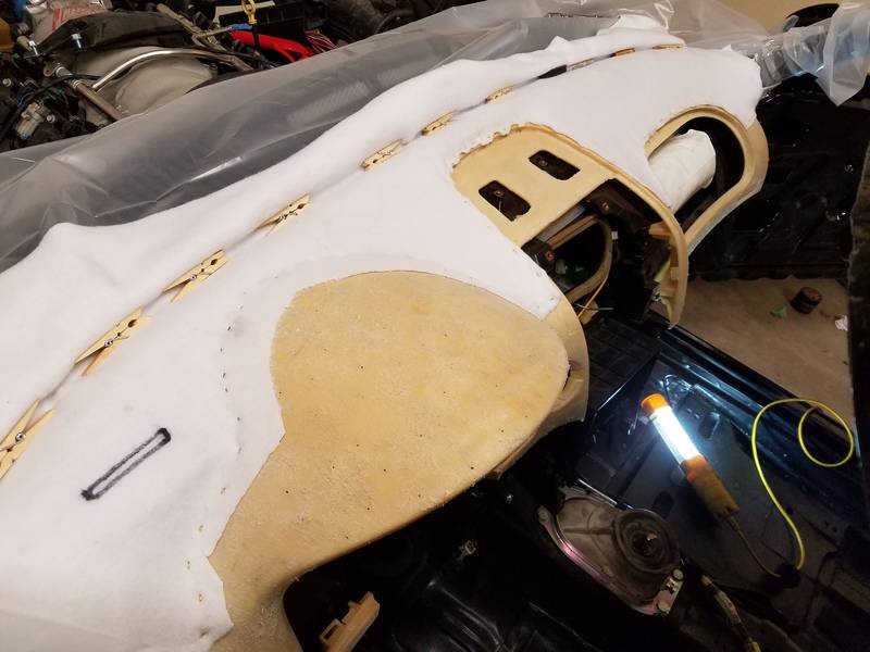

      I cut some felt and stapled it to the gto dash. I then stretched it over some plastic to prevent it from gluing to the body. I soaked the felt in resin then added 3 more layers of fiberglass matting to add strength. It was cold in the garage and it took longer than expected to harden but turned out good in the end. I filled in the deeper holes with long strand fiberglass reinforced bondo and then finished it off with a couple coats of regular body filler. I have some whisper vinyl on order and will wrap it when it comes in.

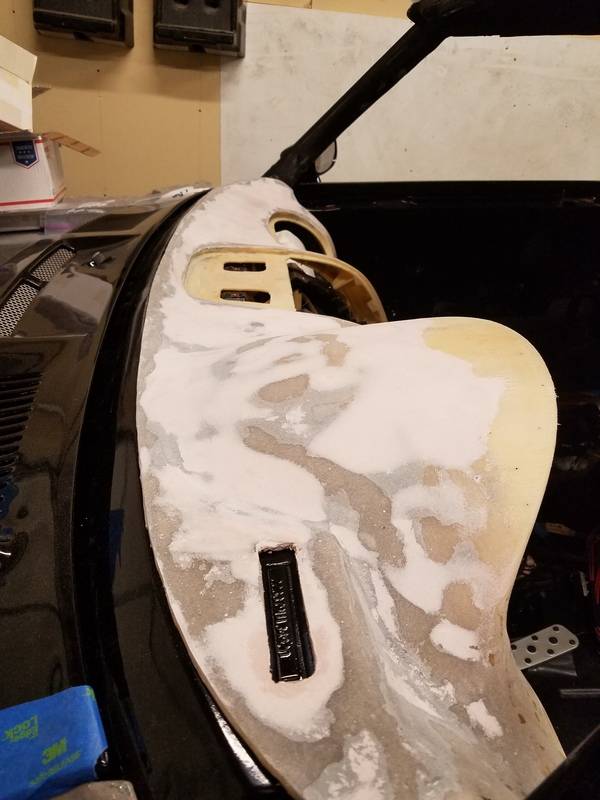

      While the body was back in the shop for to smooth out the firewall and get some color I took some time to work on the subframe. I cut out the stock spring pockets and welded in some coilover mounts. I also notched the frame and reinforced it with 1/4 plate to keep the low mount a/c and alternator. Due to clearance issues with the gto compressor I could not find a way to route the a/c lines because they exited the side of the compressor into the frame. I initially tried to clock the compressor toward the motor but still could not get enough clearance. Switched out the gto compressor for a f-body one and got an adaptor to place the line fittings where I needed them.
      Daniel
