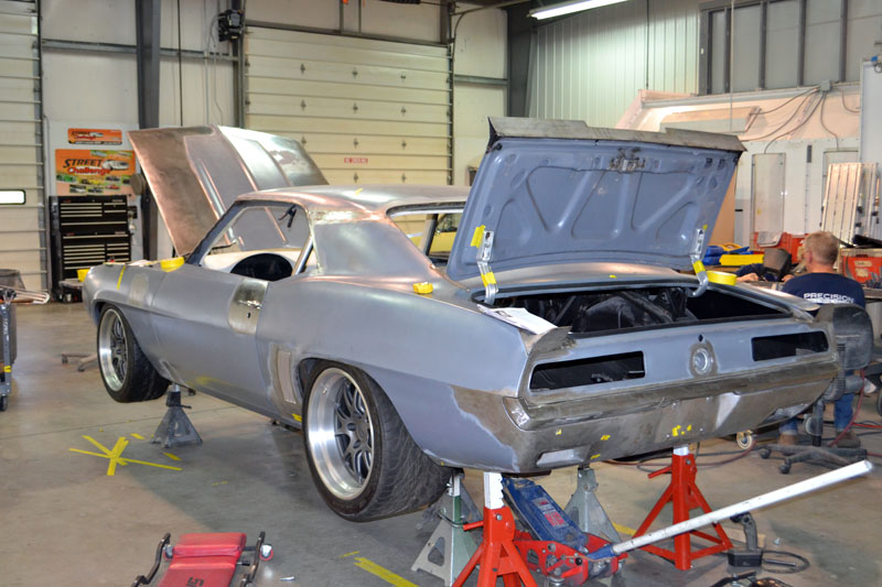

      Both wheels on checking fitment, they're going to look sick once the car is painted.

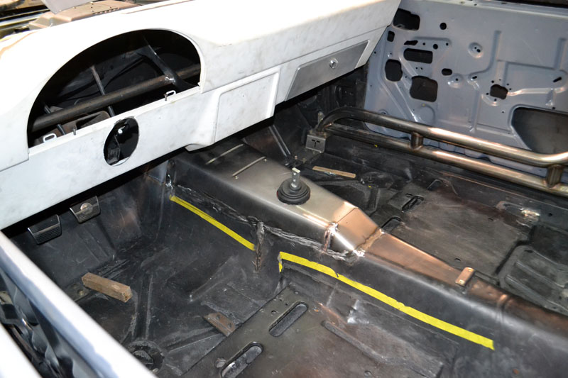

      Tranny tunnel welded up some more

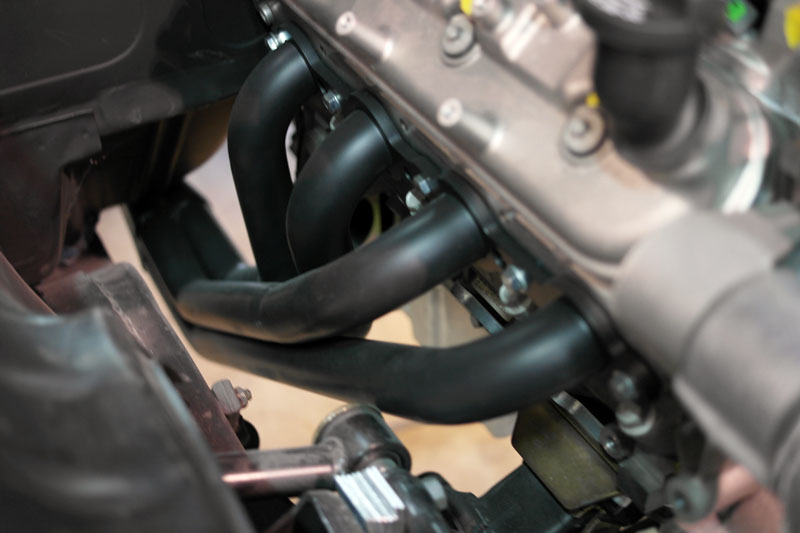

      Can't go wrong with Hooker headers

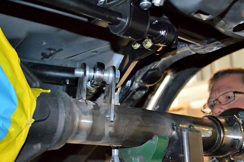

      Moser readend with ridetech 4-Link and rear musclebar. Checking angles.
      how much did you narow the rear , what s the back spacing on the wheels

      "how much did you narow the rear , what s the back spacing on the wheels"
      The rear end is 58”flange to flange including brakes. The rear wheel is 18 X 12.5 with 7” back spacing. But each customer should check there car to make sure this will work!
