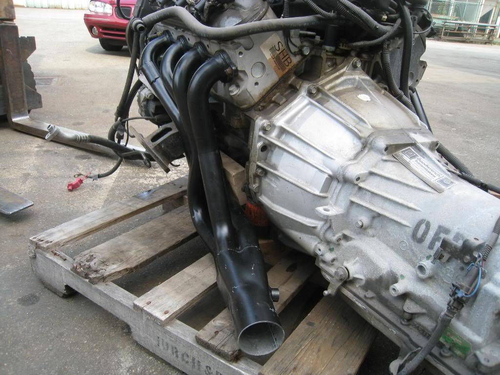

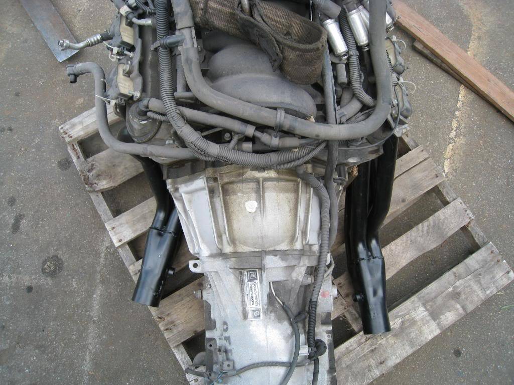

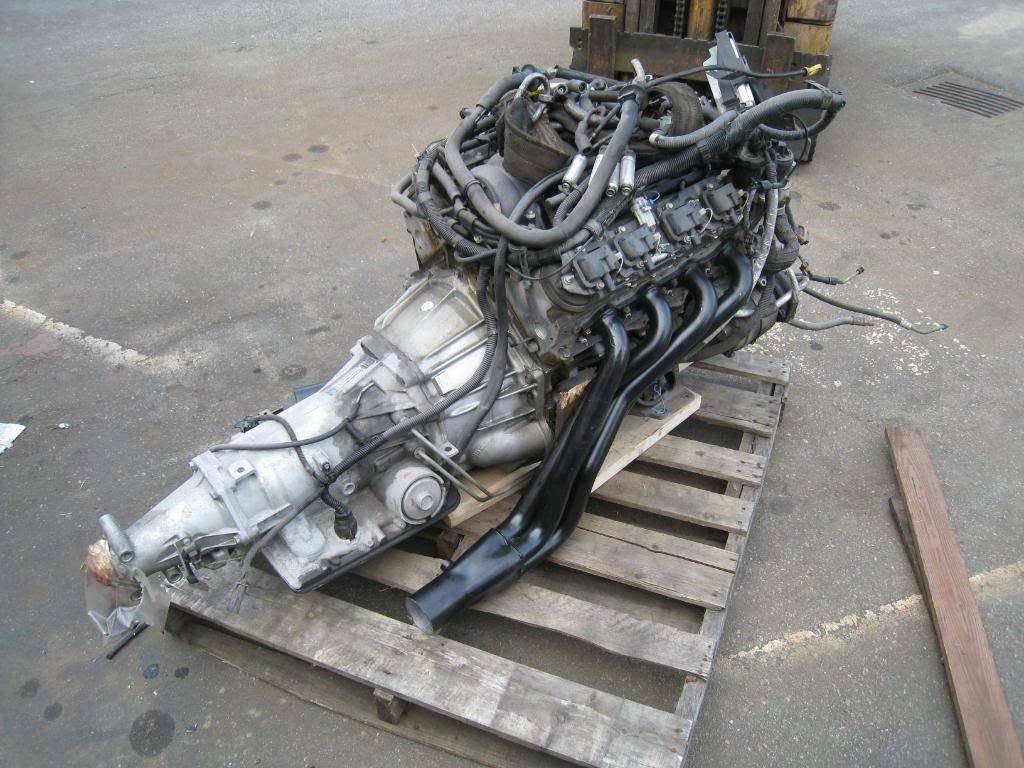

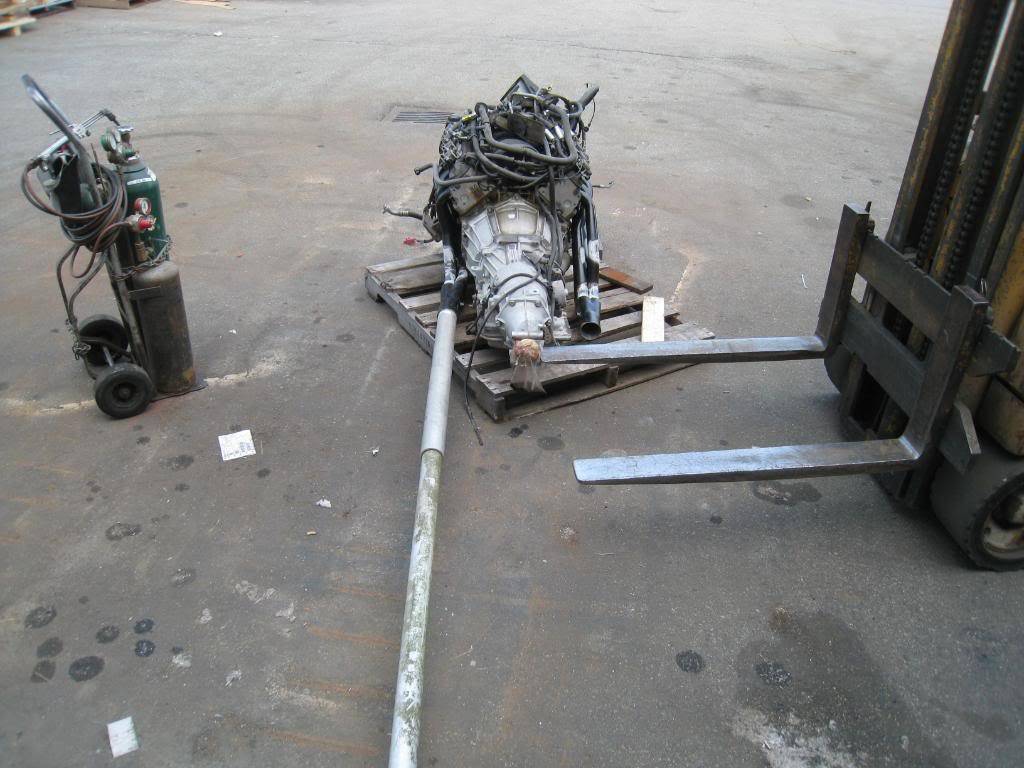

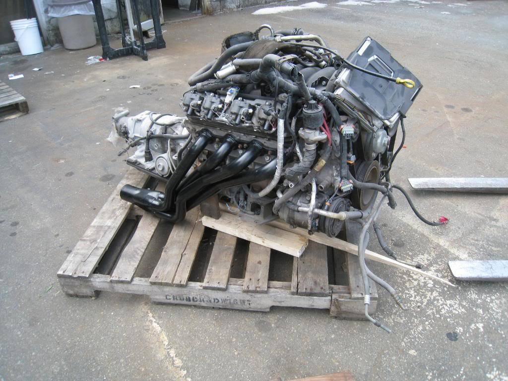

      Worked on the Headers tonight. I decided to go with the heat and bend technique. I went down to K.M.S. Car Parts spoke to Richard there and he graciously let me borrow a LS1 with a transmission in order for me to 'adjust' my headers. I bolted my headers onto the motor, secured it with a forklift, found a piece of pipe that fit inside the collector perfectly, then heated and bent the pipes to where I wanted them. I used bits of wood and sheetmetal wedged into certain spots to make sure that the pipes didn't just wrap themselves around things that they shouldn't. Realisticaly the could have been used with very little bending, but I am trying to get them to line up more with my crossmember. Overall, I got the passenger side pipe to come in 3" and the drivers side to come in almost 4"
