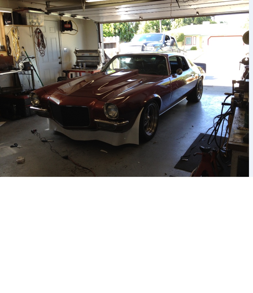

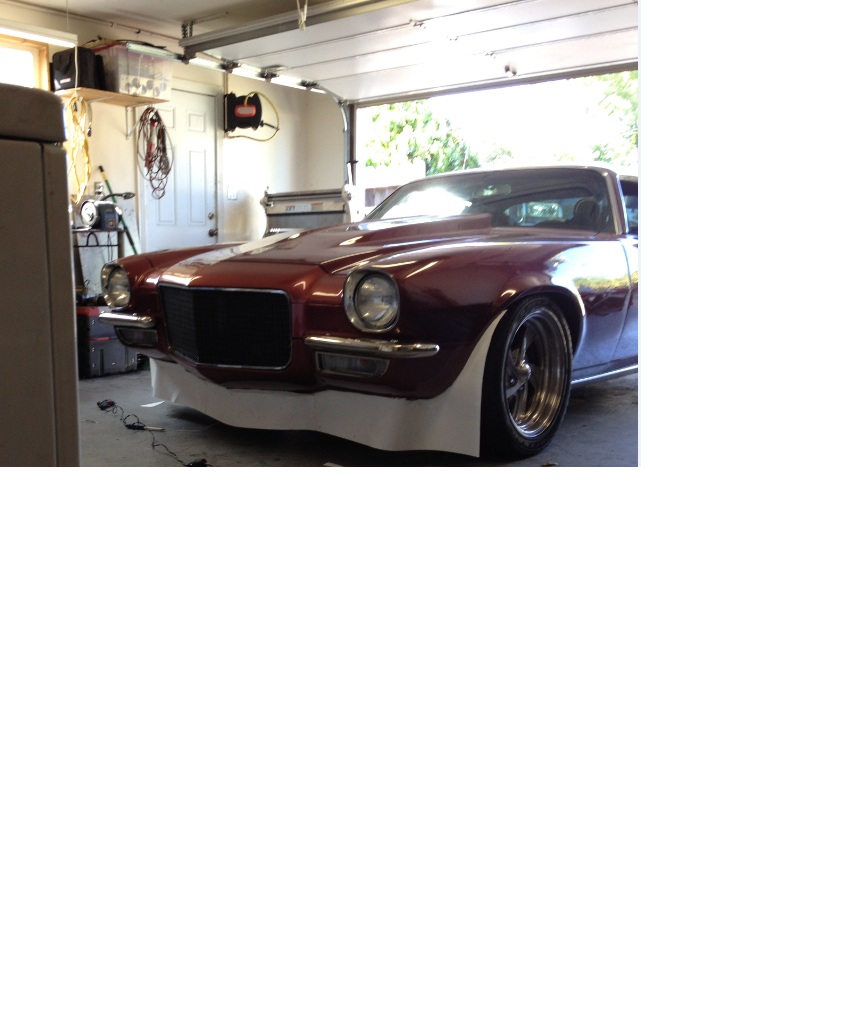

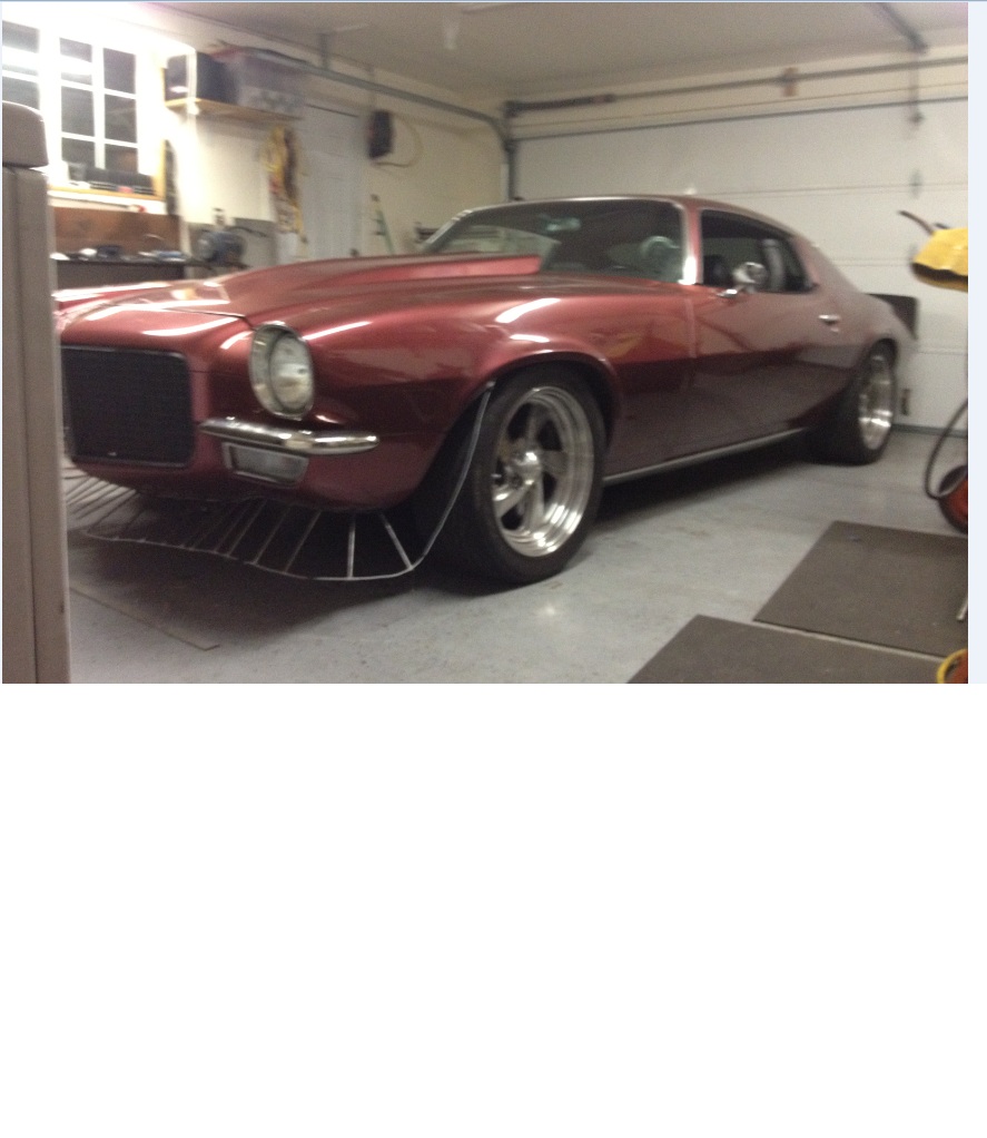

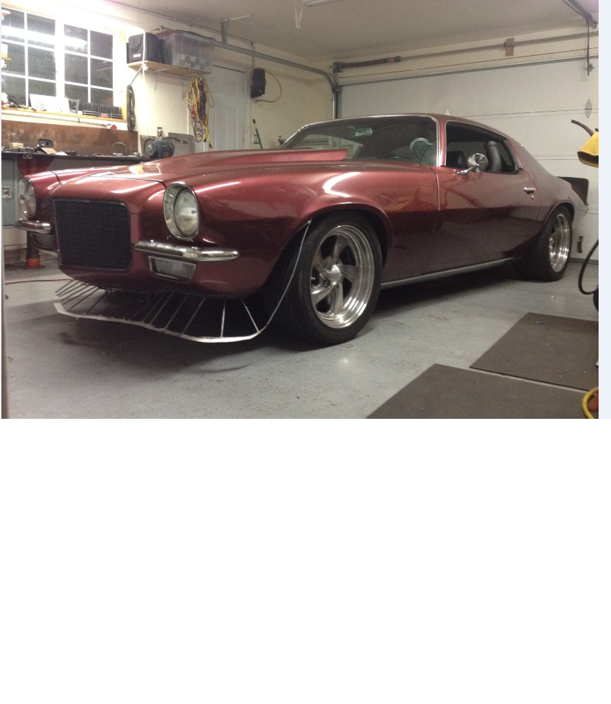

      I decided rather than purchase a stock replacement spoiler for my Gen 2 Camaro I wanted something different and am going to build my own. I have welded in my subframe connectors, build a small console for my car and adjusted my trans tunnel but I am in general very much an amateur. that said I only learn by doing so I'm jumping in.

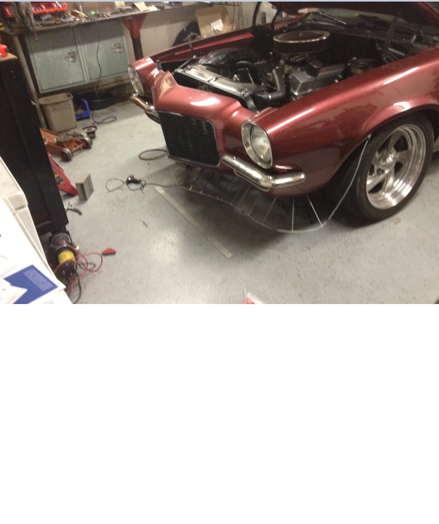

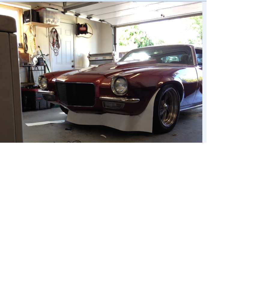

      I made a paper version to get an idea of the overall shape and form. Most likely it will look like this with the exception that the sides will be more rounded off and not square. Thinking to go functional race style but I also just looked at the one on Professor and really like the overall design of it too.... Most likely race style will also be easier so I'll probably go that route.
      In the design my thoughts were to give air a path to flow to the sides of the car rather than under it and also to cover up the tires as best I could. Let me know if I am thinking about this wrong.
      I also want to be sure I can get over speed bumps and such without looking like all the Ricers with the smashed body kits. My thought was to give the car 4.5" of clearance. Should this be adequate?

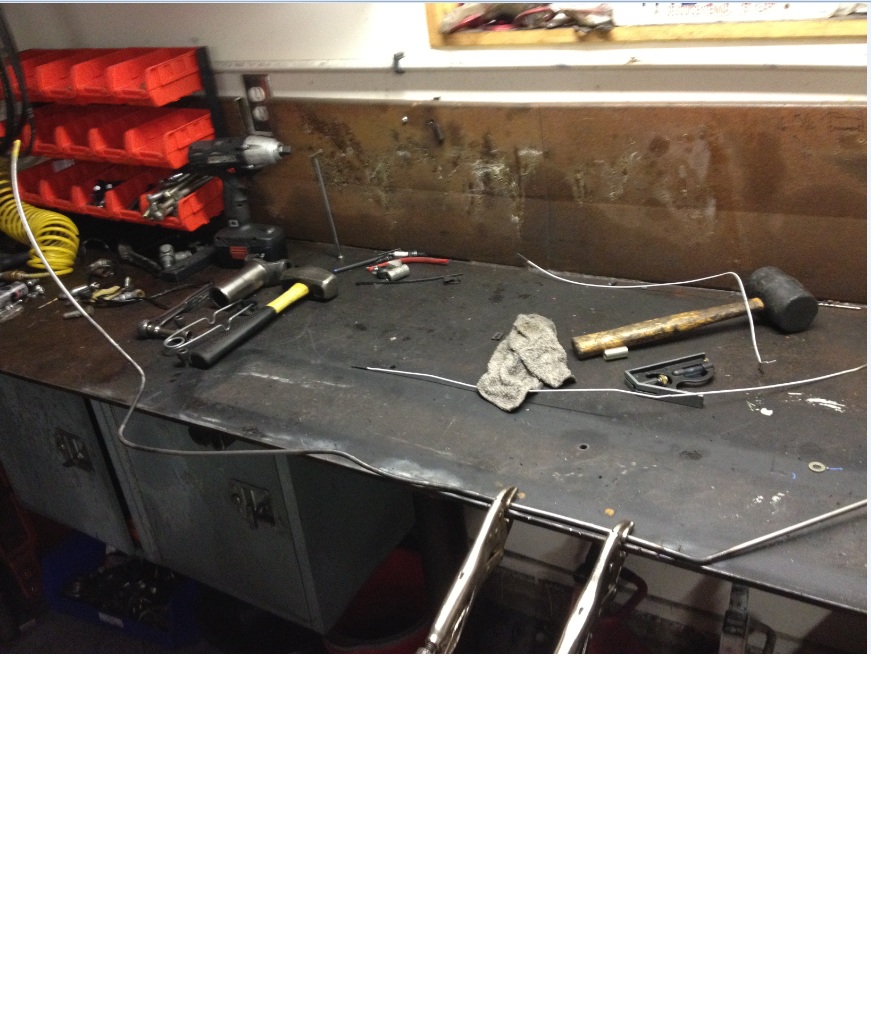

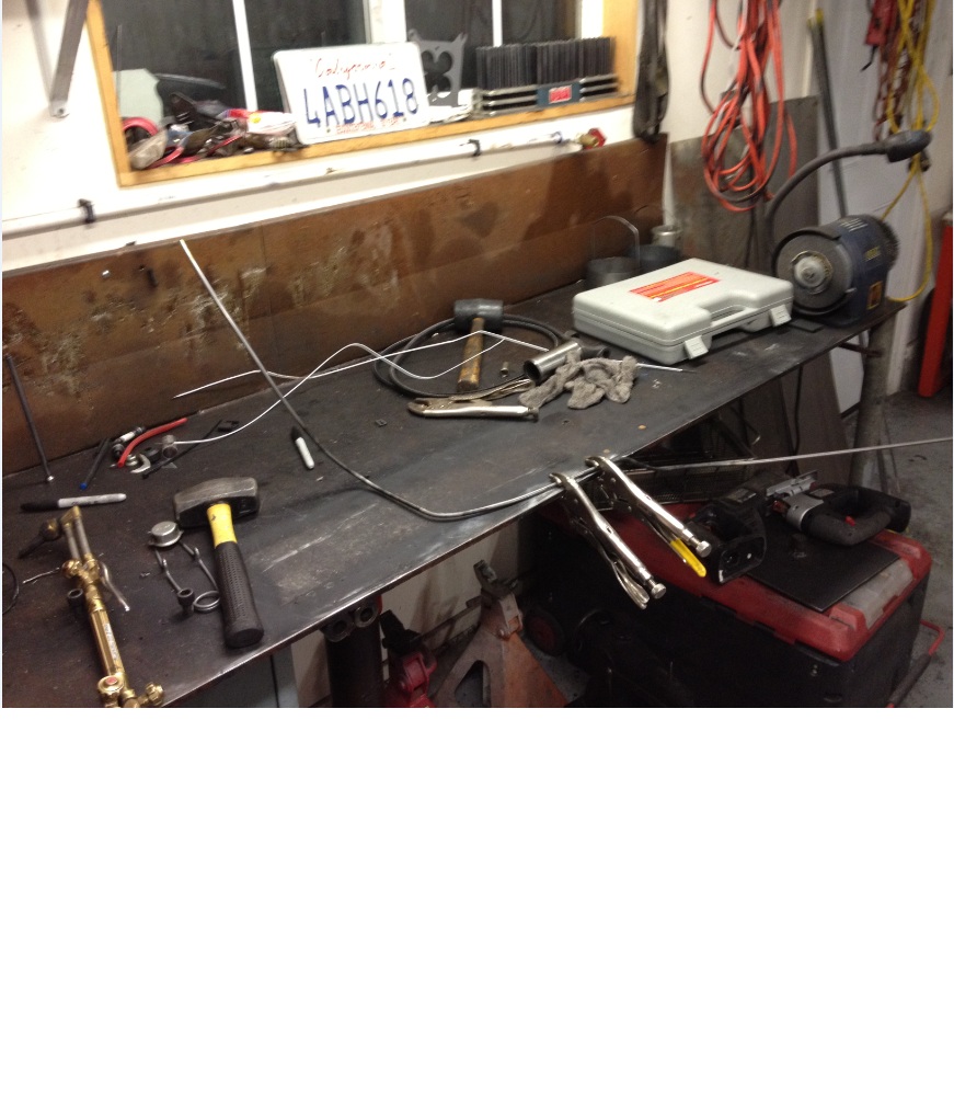

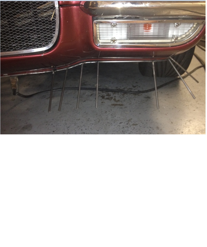

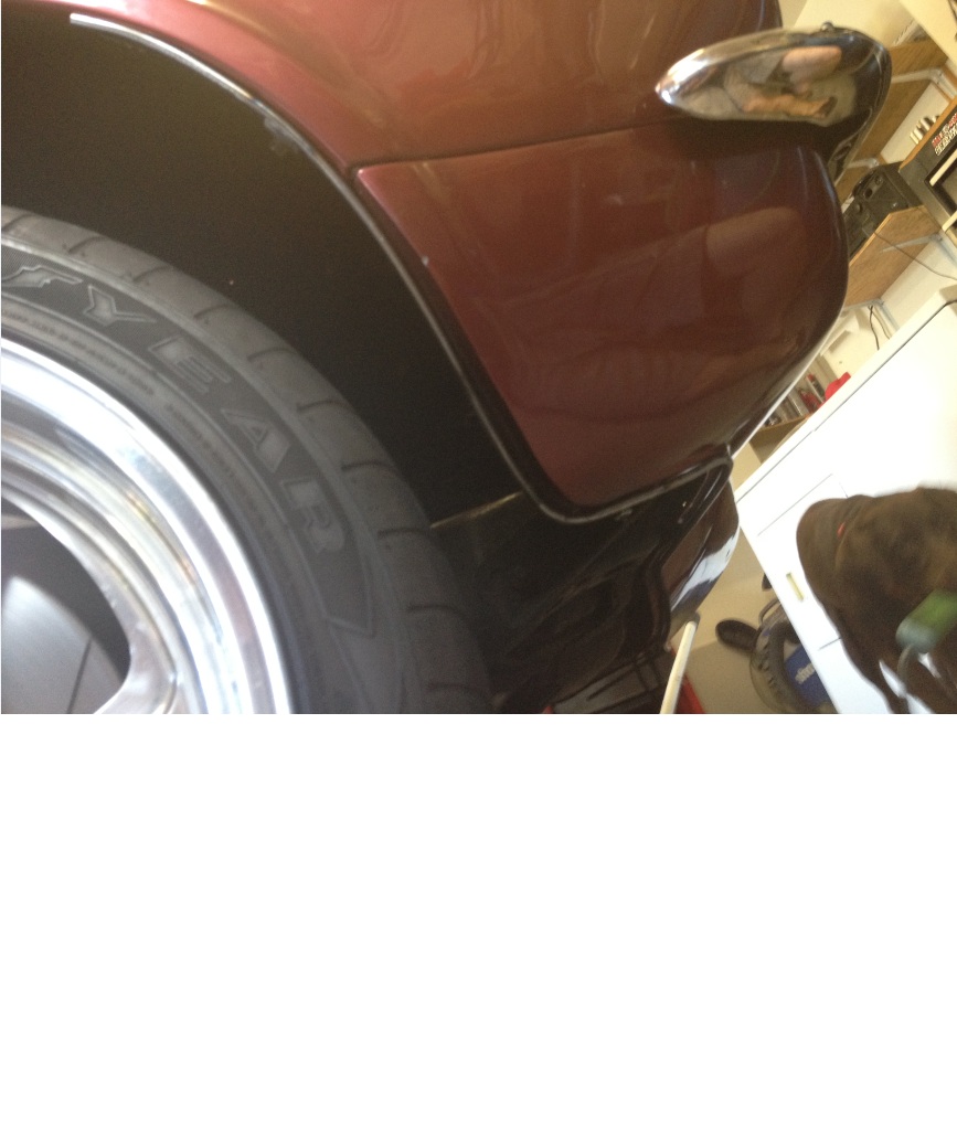

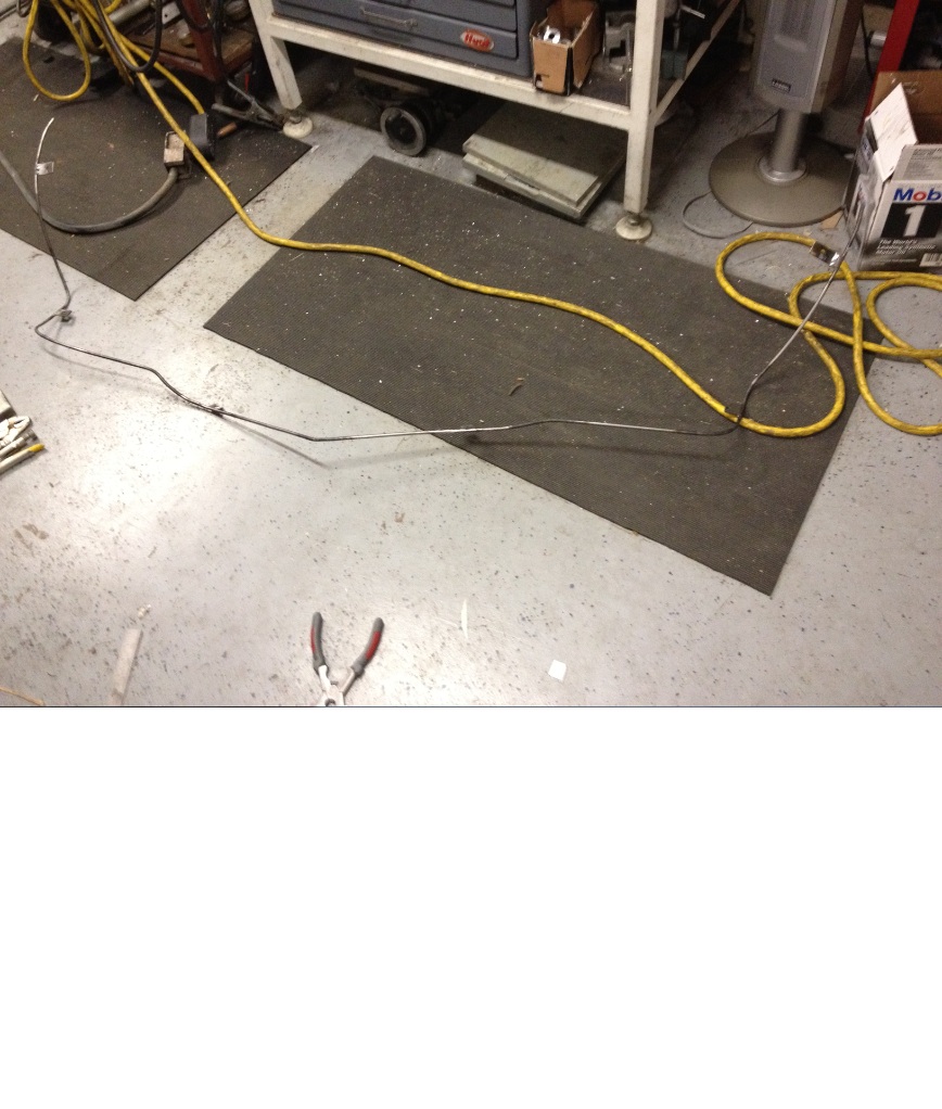

      As of yet I have not done too much real work but it has taken me a lot of time. I only bent a 1/4 rod to fit the lower front valence and added tabs to bolt it on. It took FOREVER for me to get all the contours correct.
      I'm thinking the next step is to bend the outer structure and some supports between the 2 so I can lay the sheet metal over later. I'm pretty much making it up as I go... Hopefully I will get some more done this week but it's hard to say since I also need to install LCA bushings and ball joints so I can hit the track Friday.
      If anyone has any input on how to build it better or changes to the design I'm all ears.

      i love the fact you are jumping in head first and building you own man kudos to you!!!!!! just throwing this out there but wouldn't it add more down force with a bit more forward facing splitter incorporated with your design then you could have your cake and eat it too! i look forward to seeing the finished product Name:  spectre7.jpg

      Thanks for the encouragement and feedback.. After laying out the paper I decided to give it a little more forward angle. I'm thinking it will look similar to the spectra one but have flares incorporated by the wheels something like the Gen 2 TAs have. Honestly it's hard to say what the finished product will look like as much as I change my mind but we'll see.

      A lil shorter, some forward angle then add a splitter. I think it'd look great.

      Since I'm not affraid to ask stupid questions, what do you mean by a splitter. I group spoiler, splitter and air dam all together but really don't know the difference. I suppose at this point I should get a better understanding before I get too deep.

      a splitter faces forward paralleled to the ground it allows air to catch it and put down force on the front of the vehicle(I.E. the forward lip on the spectre's spoiler) the air dam itself i guess helps block the air from flowing under the car whichh can hurt traction and aerodynamics , and the factory spoiler well i dont even know if they have much benefit to anything lol , and that's a nice setup you got i love a good ole fashioned sbc i bet it's a great driver haha

      Thanks for clarification on the splitter/dam/spoiler. I was thinking to have a smaller splitter out of metal as part of the overall design and the ability to bolt on a larger dam/splitter potentially made out of ABS or something that is longer and tighter to the ground for track days. I'm going to try to build it with the ability to bolt it on if needed but will test out the design I come up with first to see how it works. Probably way ahead of myself thinking of next steps when I haven't even come close with the first rev.

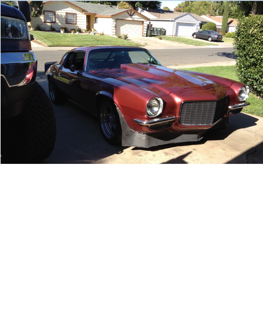

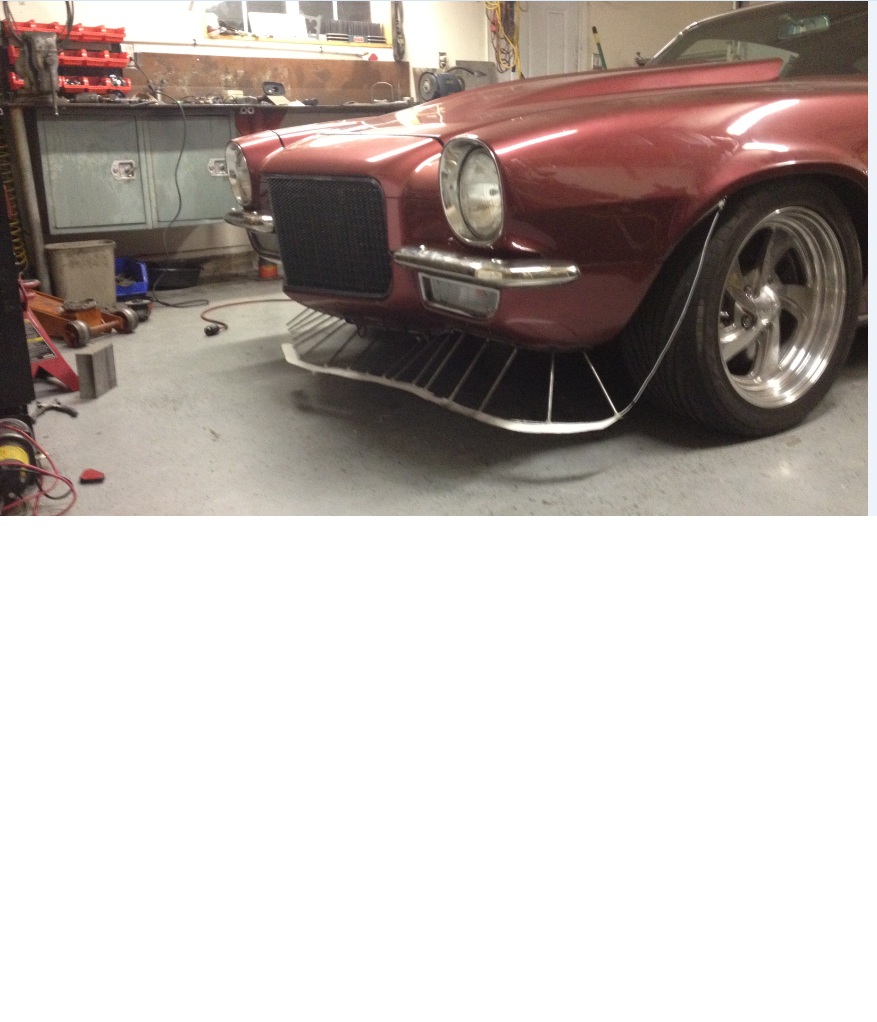

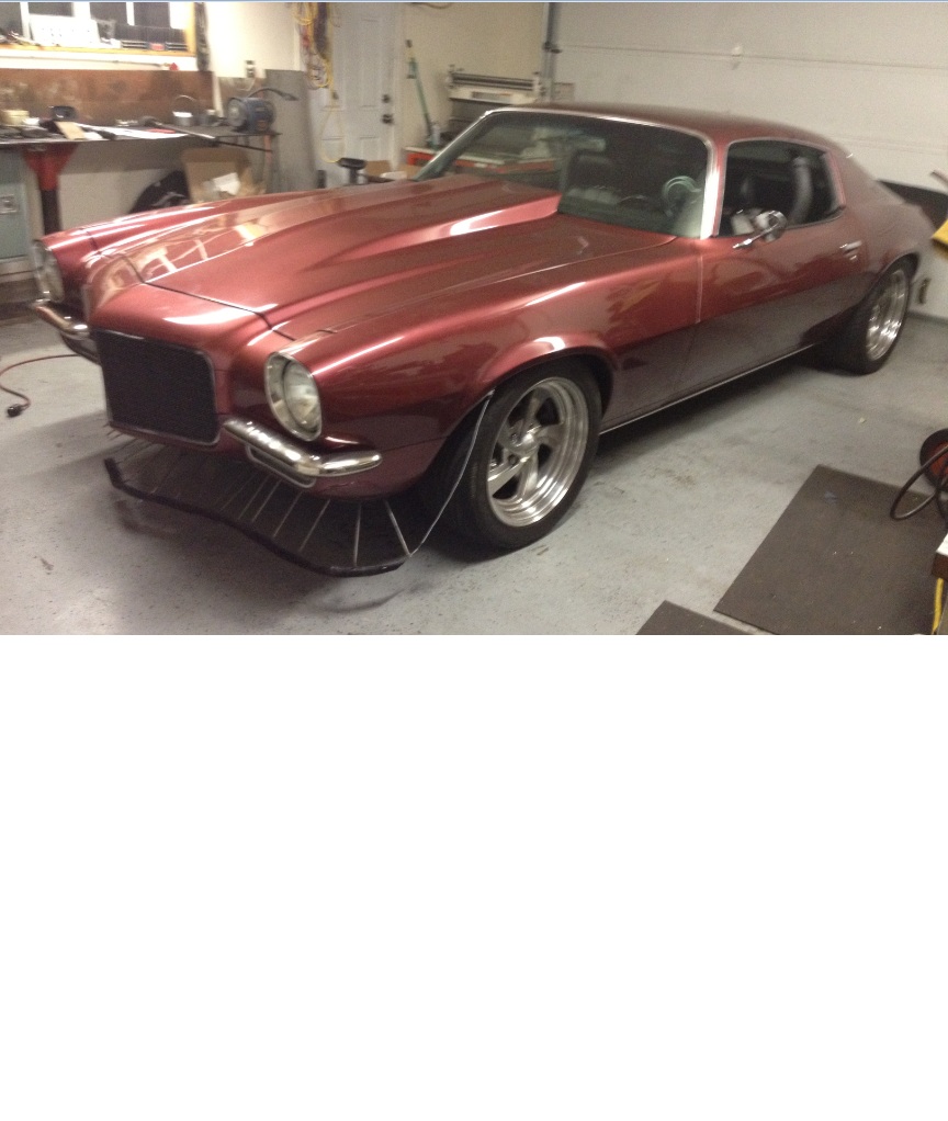

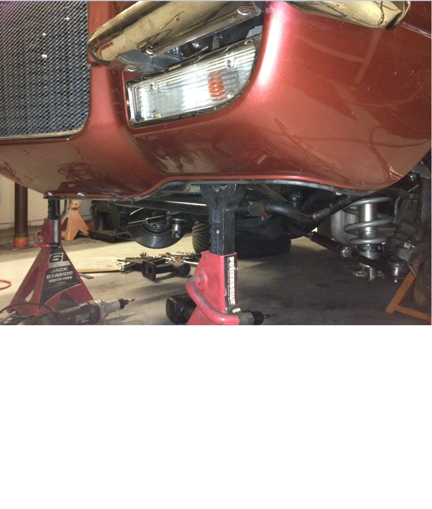

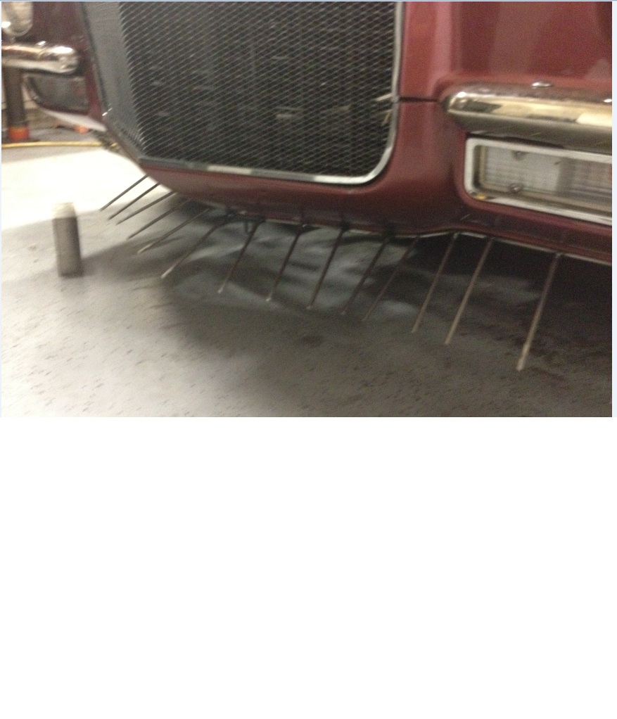

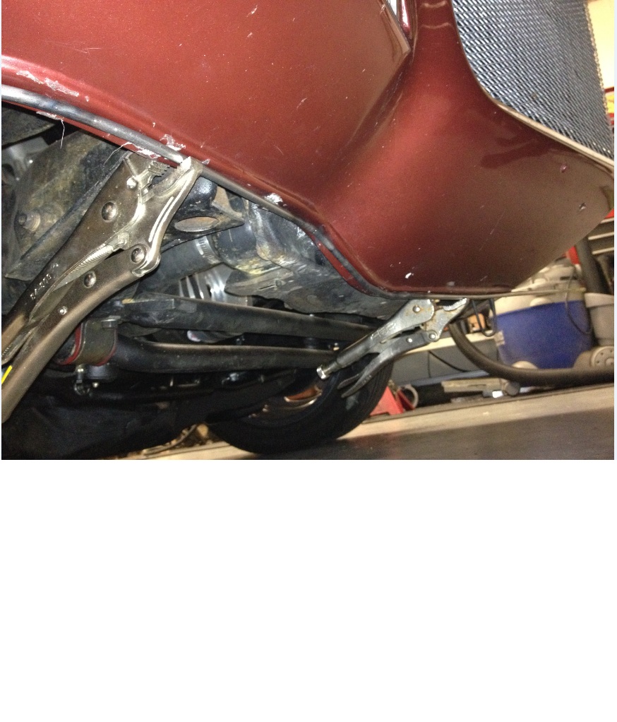

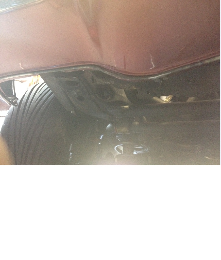

      Did a little more work tonight on the front. I tacked some struts all the same length to the bar I made and set them up 5 1/4" off the ground using a random block I had sitting around. Doing this made the spoiler match the contour of the front end. I also hot glued a hanger to the end of the rods and a 1.5" paper splitter to the ends so I could get an idea what it will look like. Not sure how I feel about it or if it will work well this way. I like it but also feel it may look too much like a bolt on.

      sweet man loving the progress and that angle is perfect lol and i see your dog wants to help every time i get under my car the short legged beagles want to crawl under too haha

      Nice cow catcher!
      It's looking really good, I'd probably bring the sides down to about bumper height instead of the bodyy line...
