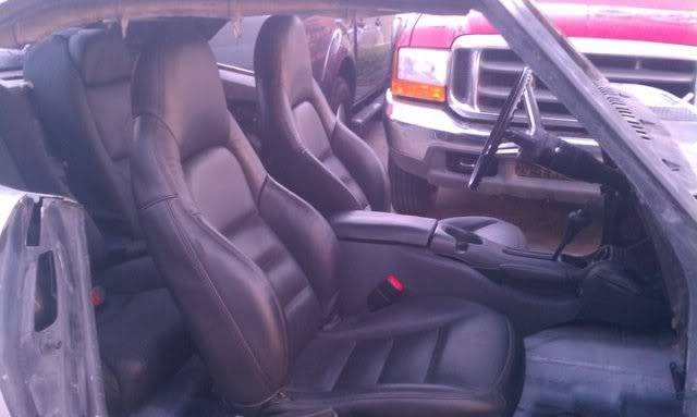

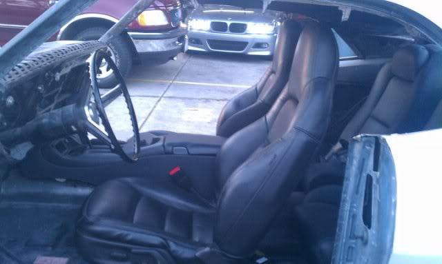

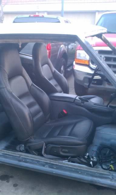

      more pictures of the back seats and information on your interior?
      Thanks
      Tory
      Oct 2010
      Santa Ana, CA
      233
      Back seats are out of a 2006 Pontiac GTO (2) buckets, front seats are 2008 corvette, center console complete shifter, e-brake are from a 2002 ss Camaro I tried using as many OEM parts as possible easy to replace just in case
