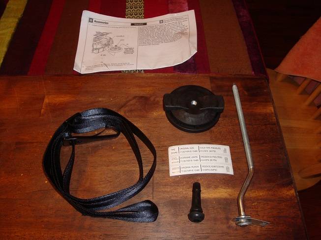

      Yes, it is a complete kit Steve,
      Here is a picture of the other little things that come along in the kit.
      I got it from gmpartsdirect.com
      It's part # 19179359 (tire kit).
      Took about 2-1/2 weeks to get.

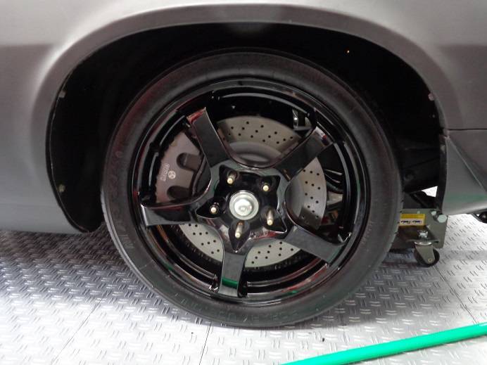

      Now that the car is on the road I figured I better get busy getting the spare to fit. Got the center enlarged so it will fit over the hub.
      Then took the tire & wheel over to Cadillac and they mounted it for free. Now I don't have to wait for the flatbed to come get me for a flat tire.
