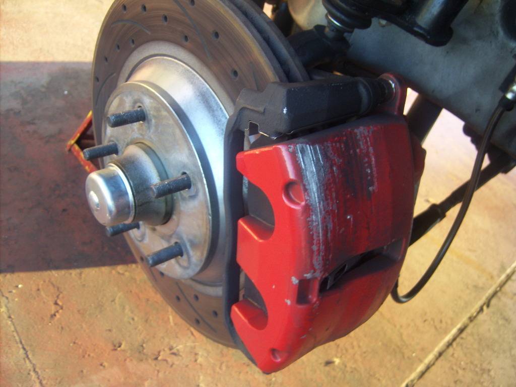

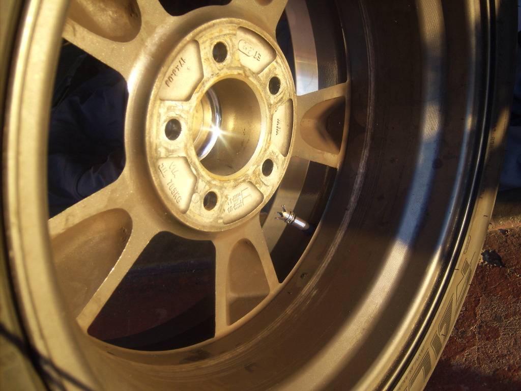

      had the same thing happen after a track day, lost a bolt and the caliper was just smacking the rim on the track, kinda freaks you out, now I do a complete suspension check before and after every event
      heres the back of the brake
      and the rim

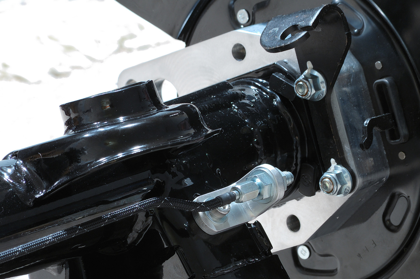

      Nice thing about lock wire is you can visually nut and bolt the car in a few minutes rather than checking each one for tightness. Another option is to use Torque Seal so you can visually determine if the bolt has turned. I use this stuff in applications where lock wire is not practical. Between lock wire and torque seal, I can nut and bolt my whole car is just a few minutes and with out lifting the car. For super critical bolts, I will actually lock wire and torque seal. Cheap and easy to do both. But I have gone nuts with my bolt retention.
      You can see the torque seal here on the two nuts on the right of the picture.
