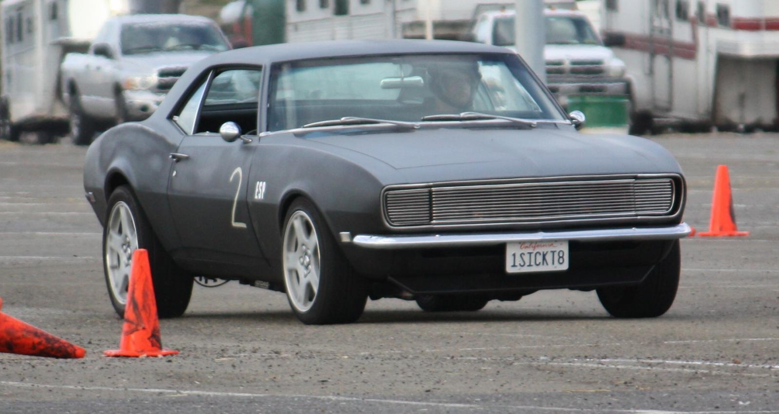

      I used 2 inch spacers on the front and 2.250 spacers on the rear, on a set of corvette wheels, here you see me testing the suspension just before I painted the car
