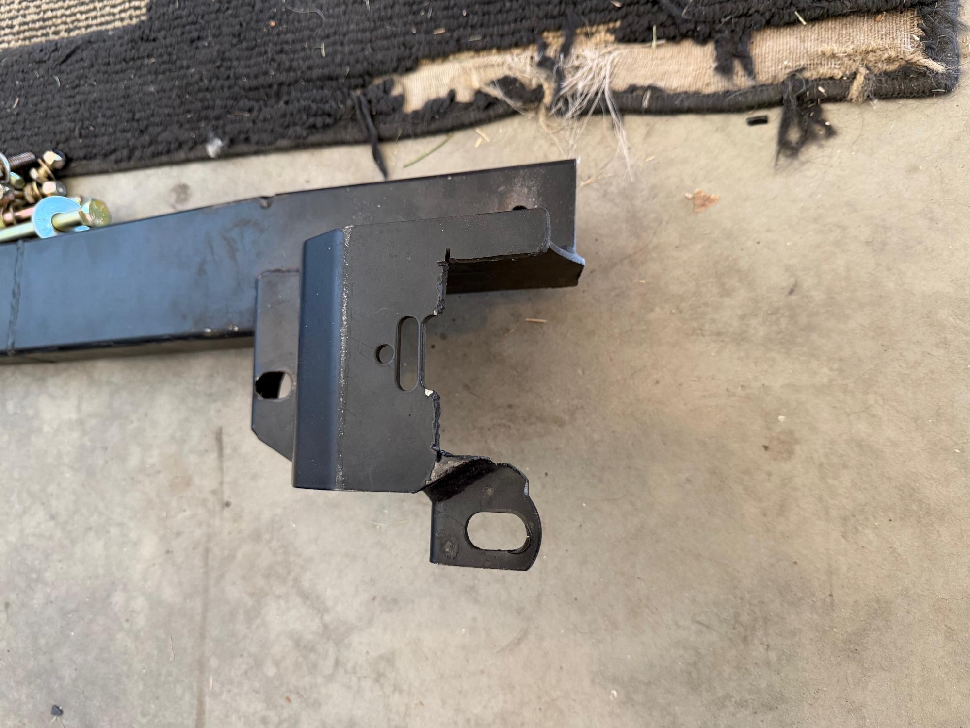

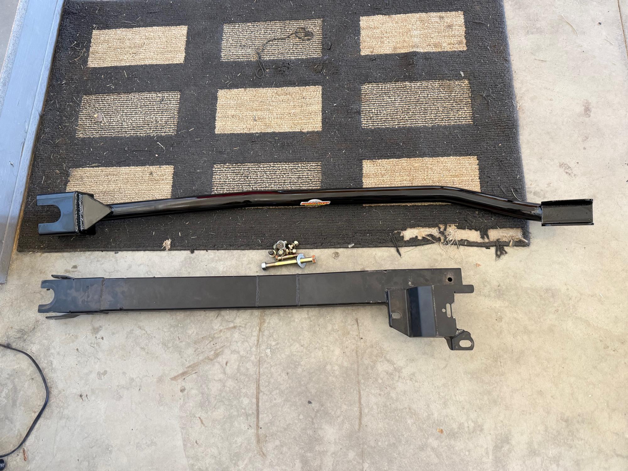

      Back with another update. As mentioned previously, I recently added Global West Cat-5 leafs to the car. I've run into some ride quality issues however that relate to using these with my ridetech subframe connectors. The ridetech pieces have an integrated leaf pocket, but it's not really designed for a reverse eye leaf, especially one on a spherical bearing. I had contact issues from both the upward travel of the leaf, as well as the tilt of the spring eye on it's bearing.
      I tried my best to get these RideTech subframes to work with this style leaf, but after cutting about half of the roof off of them, I was able to only make minor improvements in contact by the spring eyes. I really like these pieces, but they just don't work with this style leaf.
      So, I swapped them out for Global West's brackets designed for these leafs and their weld-in subframe connectors. The Global West stuff is pretty beefy. The square tubing of the RideTech subframes come in at .125" while the boxed ends on the Global West subframes mic out above .2". Their clearance because of the DOM tubing use is not quite as good as the RideTech pieces and if I'm being honest I like the look of the RideTech subframes better as well. However, now that I'm not smashing my springs into a hard roof, the rear end softened, allowing me to add more bump compression in the shock and smooth out the ride further.
      I also went ahead and added a 1/2" lower block and top poly isolator to get my stance back to where it was, and kill some of the differential noise that these leaf springs tend to transmit. Winter changes/upgrades done for this season. Now it's time to enjoy the car.
